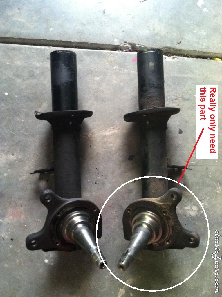

Anybody have a front spindle laying around they don't need? I only need one side, and it doesn't matter which side or which year. I just need the part where the hub mounts.
I'm thinking if someone was working on coil-overs and accidentally cut off the tube too short or something? Or if there was a car that was in an accident and the tube is bent? Or someone who couldn't get the gland nut off and the threads are totally ruined?
I have a 3d scan of the front strut and spindle housing if that helps at all. I also have a damaged front passenger you could have but it's still on my parts car and could be a couple weeks before I can get some time to remove it.

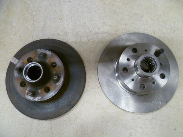

But seriously, the short story is... I bought a cheap rotor off rock-auto. China's finest. And right out of the box, it's got over .010 runout. I was thinking that if I could figure out a way to fixture it ON a spindle and run it on wheel bearings, I could take a clean-up cut on it and bring it back to running true.

Move the lathe to the car.  On-car-rotor turning is a thing.
And who checks their new rotors for runout?  That's not obvious either!  What's going on here!
Yes, I know about on-car rotor turning. But won't quite work for everything I need here.
Haha! And I'm sure you could guess that things aren't totally obvious on my end. I'm clearly jumping the gun a little, but here's a little of what's going on here.
