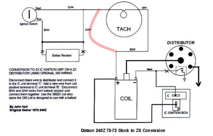

September 11, 2024Sep 11 comment_669180 Here's an experiment you could try if you just want to mess around and try things. It fits my earlier comment about too much current maybe screwing up the tach function (even though many people have done the conversion with no problems). Run a parallel power wire to the coil. This will reduce current through the tach sensor loop. You can run a jumper, then if it works, just run a permanent bypass wire. Overall though, considering cgsheen's comment about all of the people he knows with no problems, it might just be that the tach components are wearing out. There are many posts about flakey (flaky?) tachs. My 76 tach flaked out in the first few years after I brought the car back to life. It also had problems after the GM HEI module conversion even though it was already designed for electronic ignition. Electronics components weren't as high volume and consistent in quality in the 70's as they are today. Today's light bulbs have printed circuit boards inside. It's crazy. Anywyay, this shouldn't hurt anything. Not sure why that red line came out pink. p.s. you can just run a wire directly from the battery terminal for the test. The engine will keep running though until you remove it. Hot wire. Edited September 11, 2024Sep 11 by Zed Head Link to comment https://www.classiczcars.com/forums/topic/69099-lazy-tach-with-280zx-distributor/?&page=3#findComment-669180 Share on other sites More sharing options...

September 15, 2024Sep 15 Author comment_669290 Still fiddling around with it… Does anyone know what this solid black wire is for? Comes out of the factory wire harness at the coil. It’s the only wire not connected to anything for me. Maybe the ground wire for the old points distributor? Link to comment https://www.classiczcars.com/forums/topic/69099-lazy-tach-with-280zx-distributor/?&page=3#findComment-669290 Share on other sites More sharing options...
