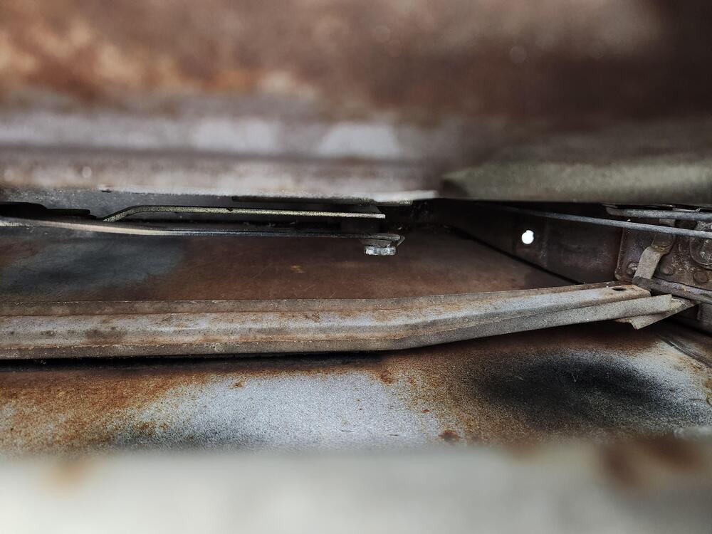

Where I am getting hung up is that when I roll the window all the way down so the bottom of the door glass frame touches the rubber bumper at the bottom of the door and then start to roll back up, the rearward roller jumps out of the back of the track that is on the door glass frame.
Window rolled all the way down
Starting to roll back up
Roller jumped out of track
Door glass
I have tried adjusting the front glass guide and the rear regulator guide bolts that are on the inner door frame but other than trying to adjust the entire glass rearwards I'm not sure what to do.

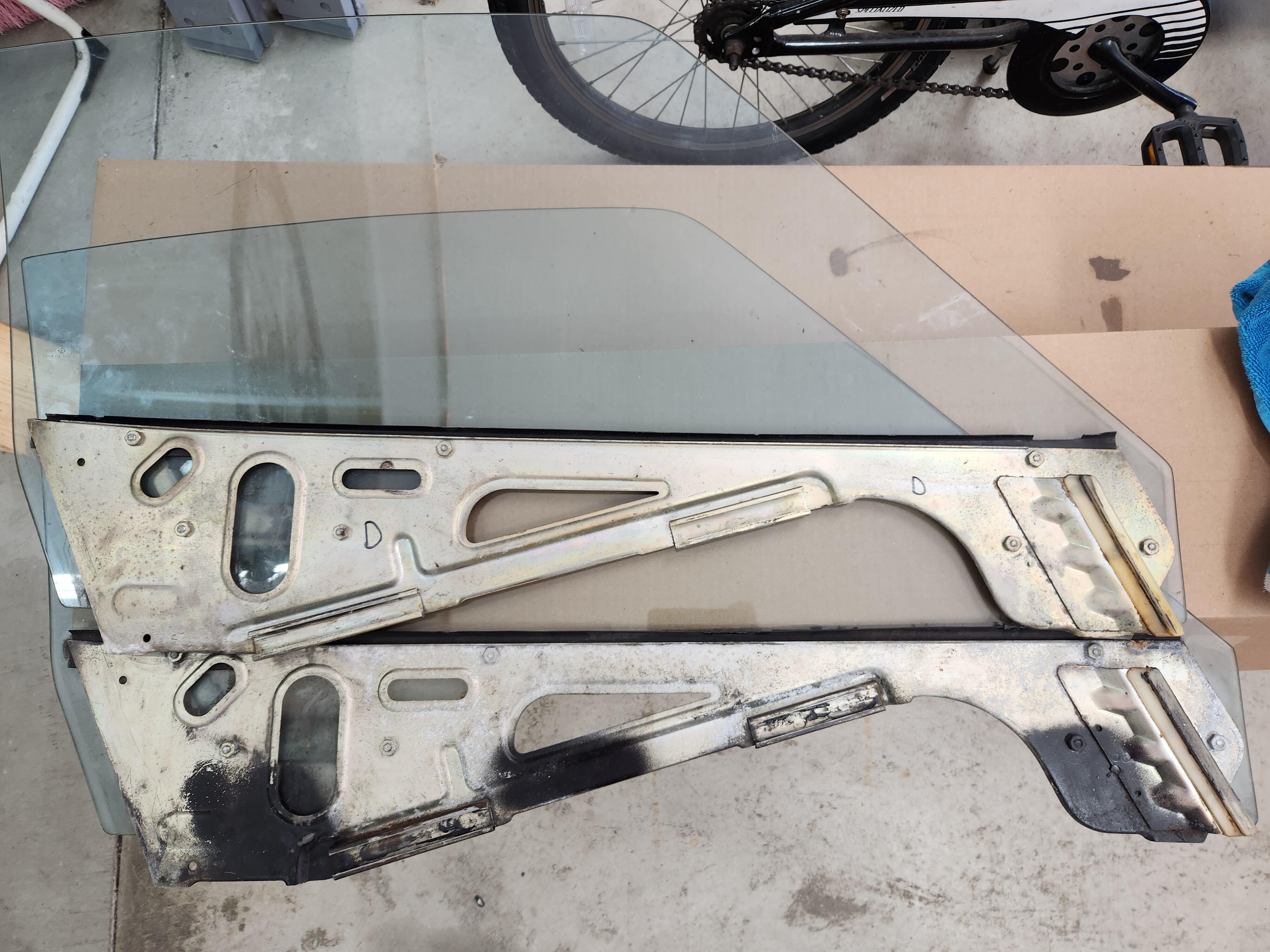

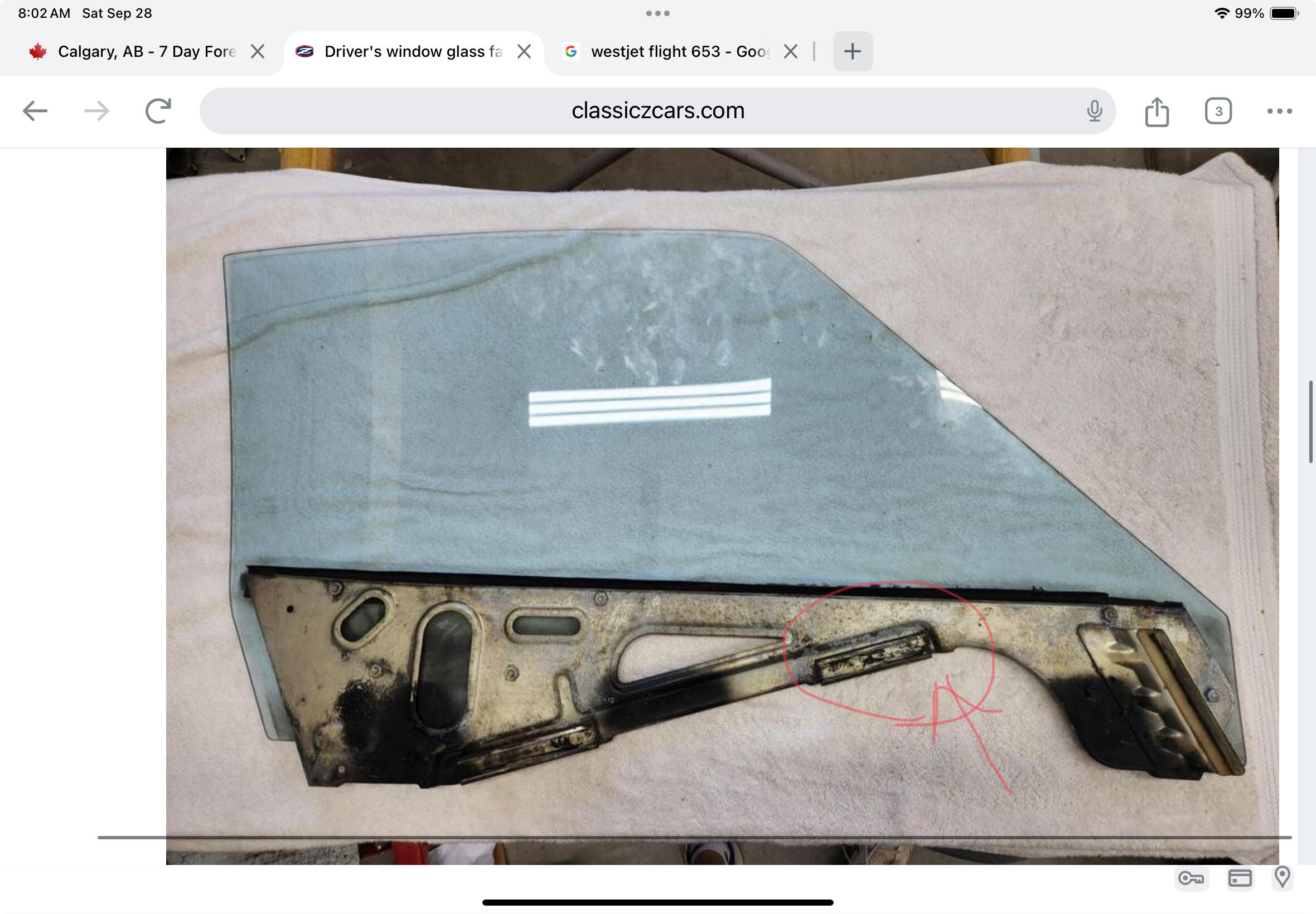

The picture of the glass out of the car showing the two roller tracks tells me this window is from a 240, and I know that using 240 glass in a 280 will cause the “fall off the track” issue. The location and length of the two roller tracks is slightly different between the two. They changed the regulator in the 280 as well to offset it further into the door.
The way I quickly tell them apart is by looking at the front track. If it is butted up to the frame so that the roller cannot escape out the front, then it’s 240 glass. This appears to be the case, see my red circle.  280 windows allow the roller to enter or leave all four ends of the two tracks. They are also slightly different lengths.

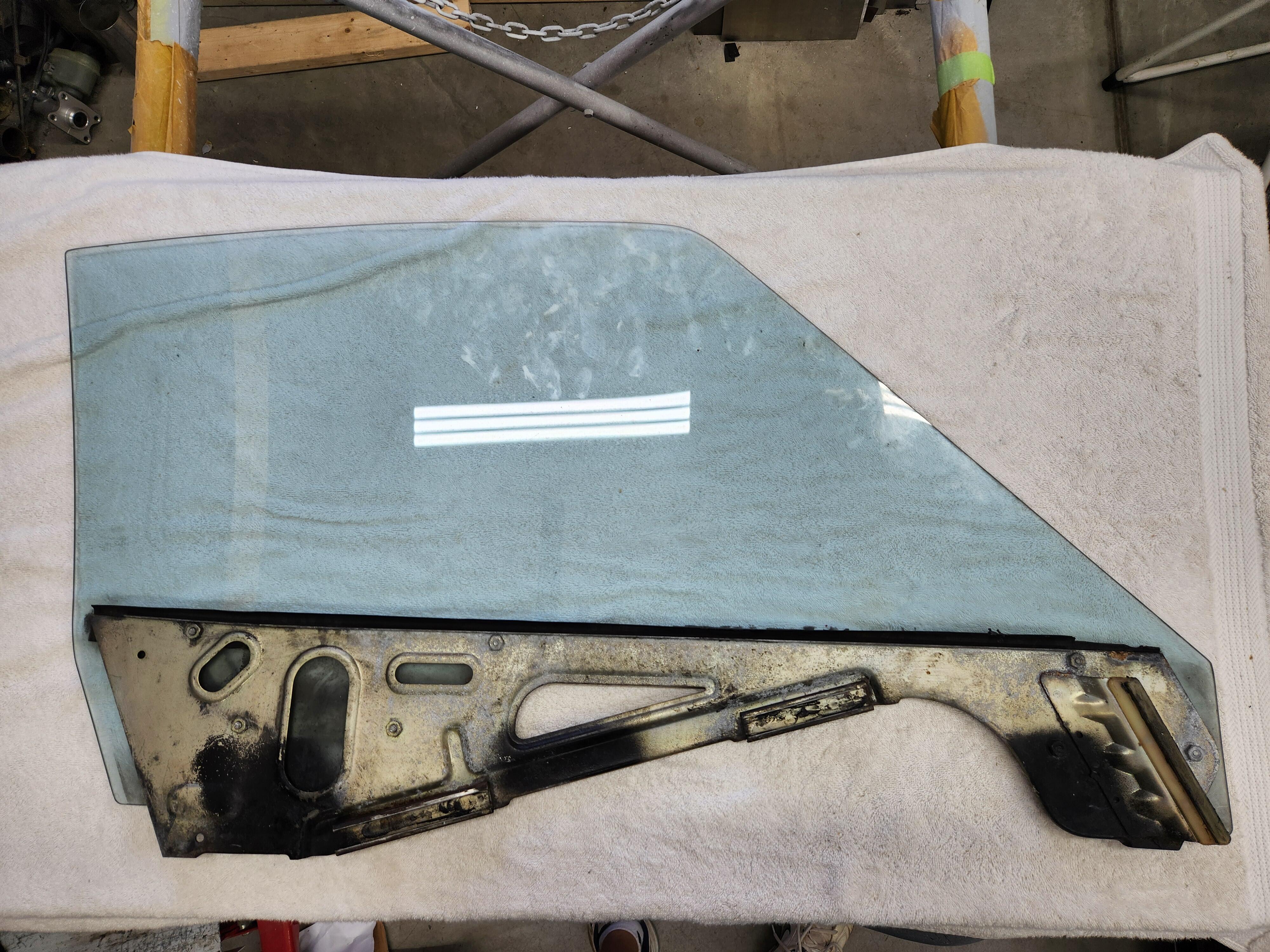

Wow, zKars, very astute.  You are correct, this window was indeed from another vehicle.  The only reason I didn't want to use the glass that came with the car is because it has more substantial scratches along the bottom of the glass.

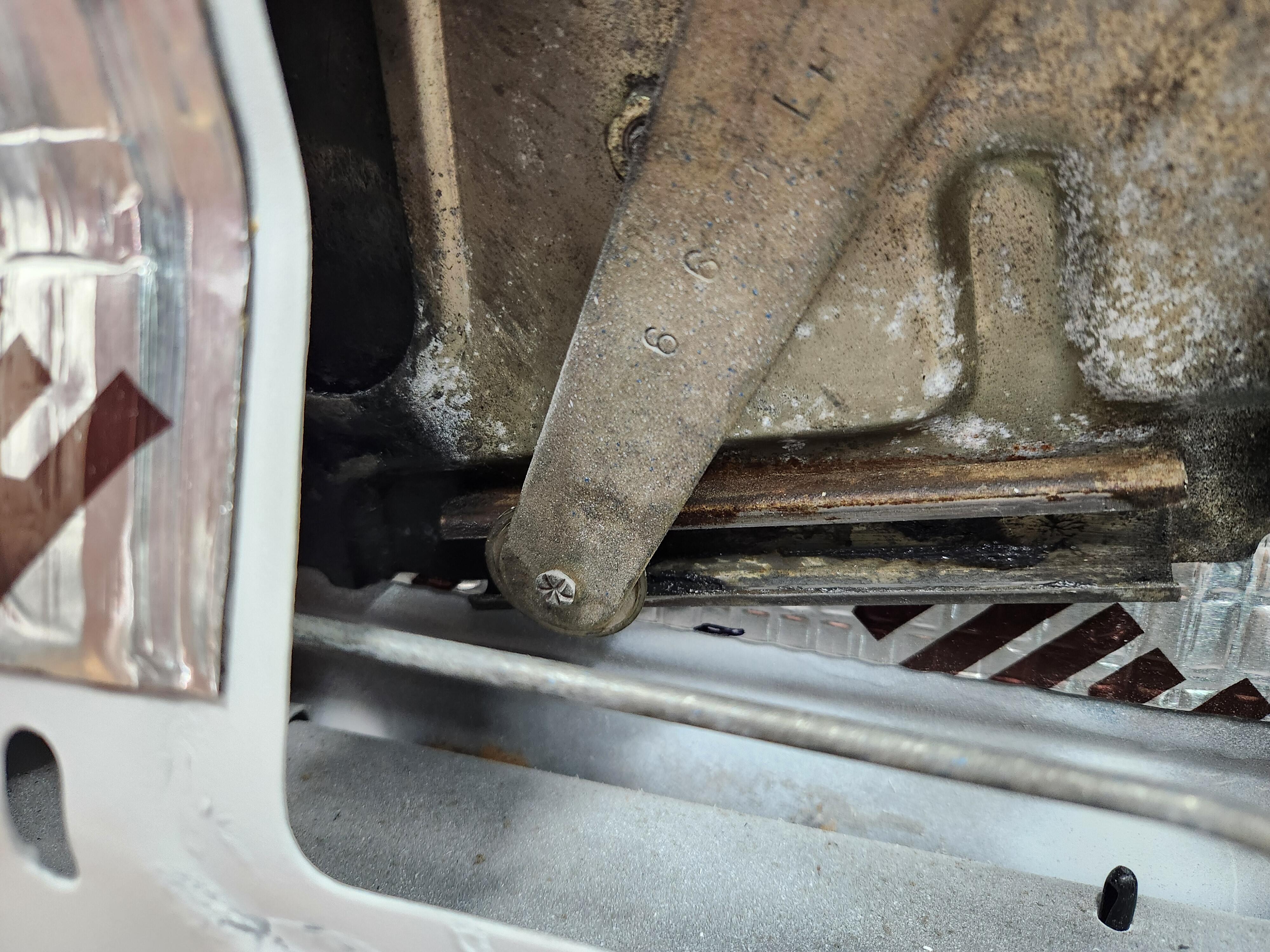

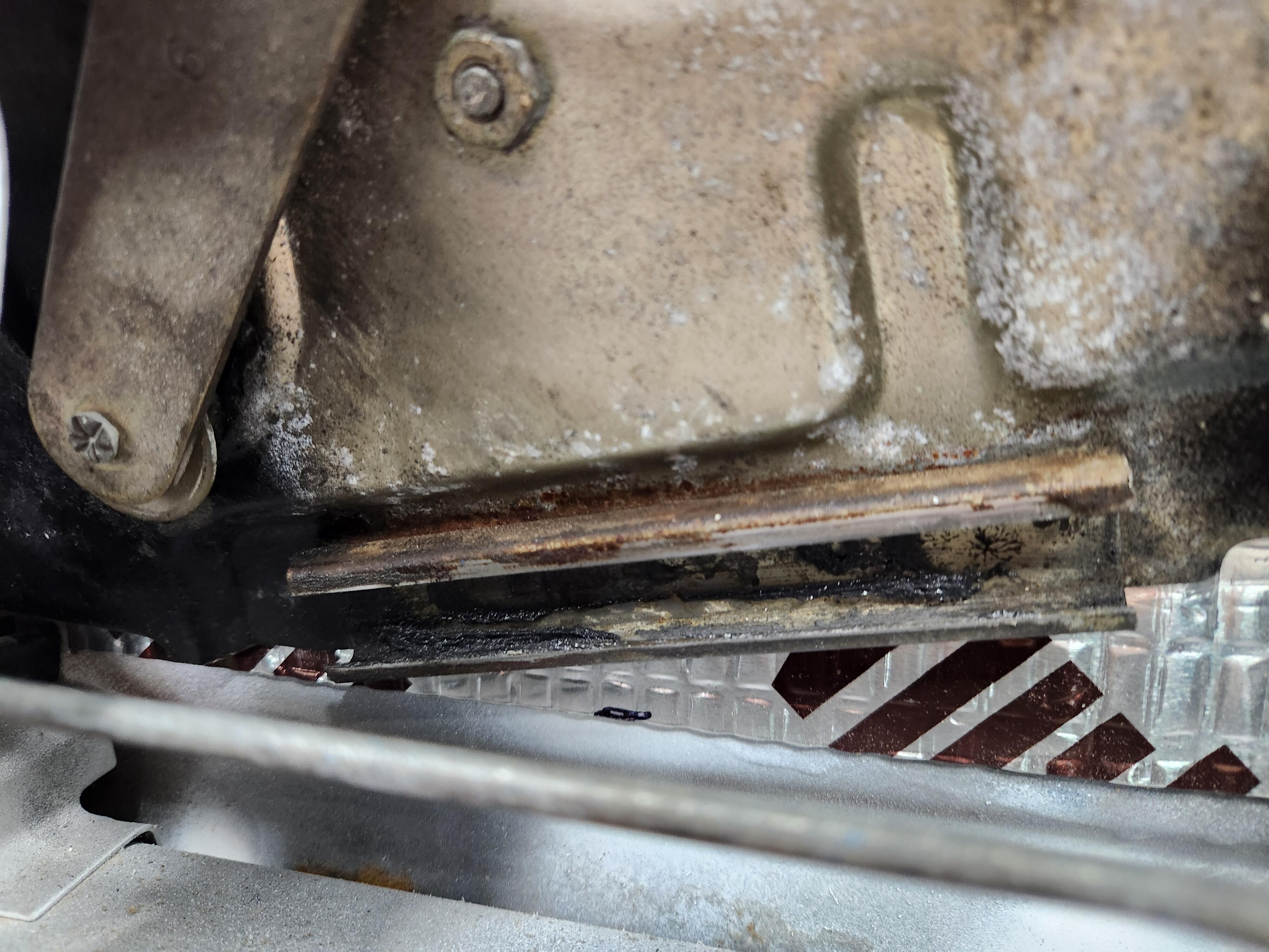

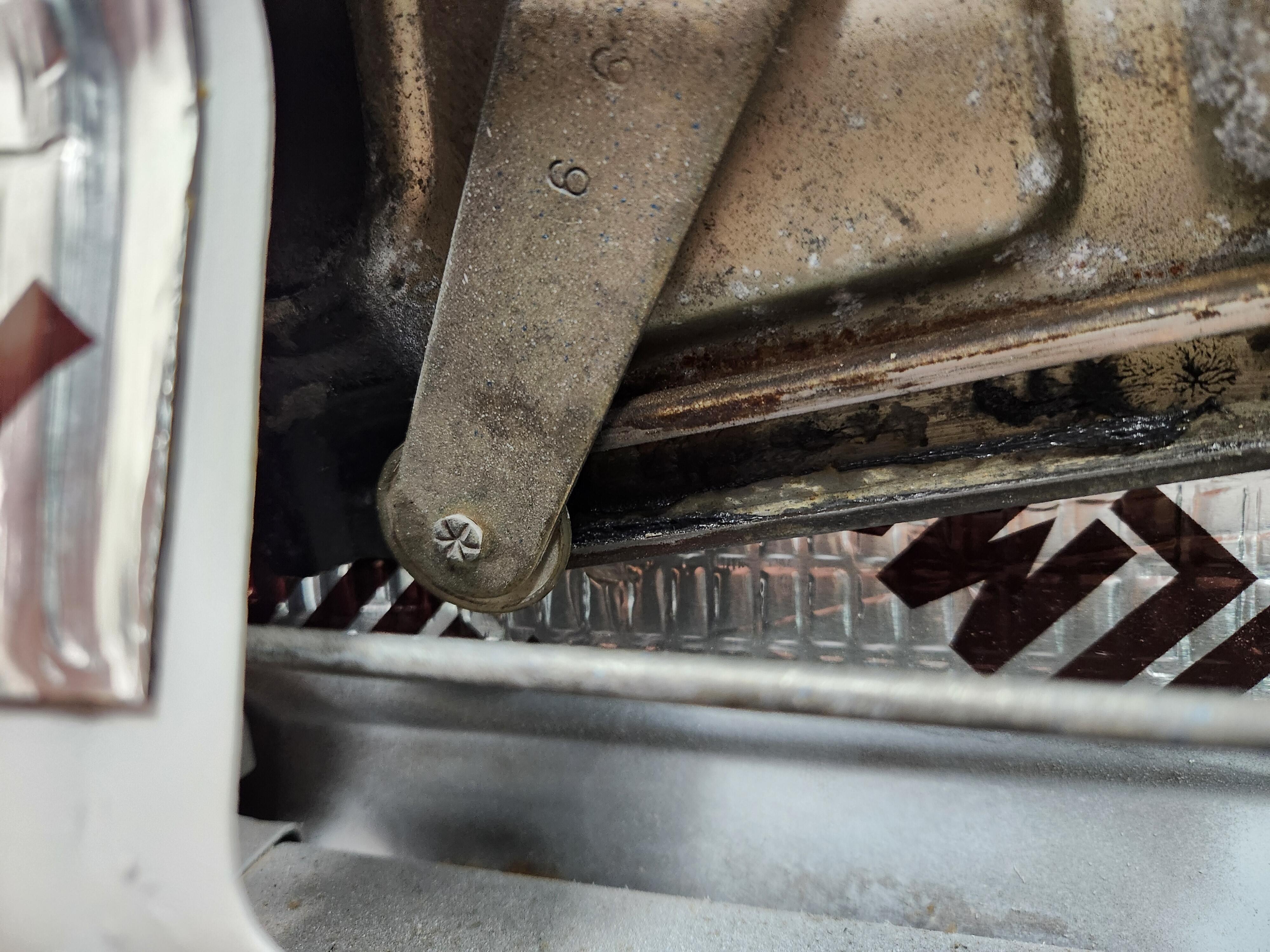

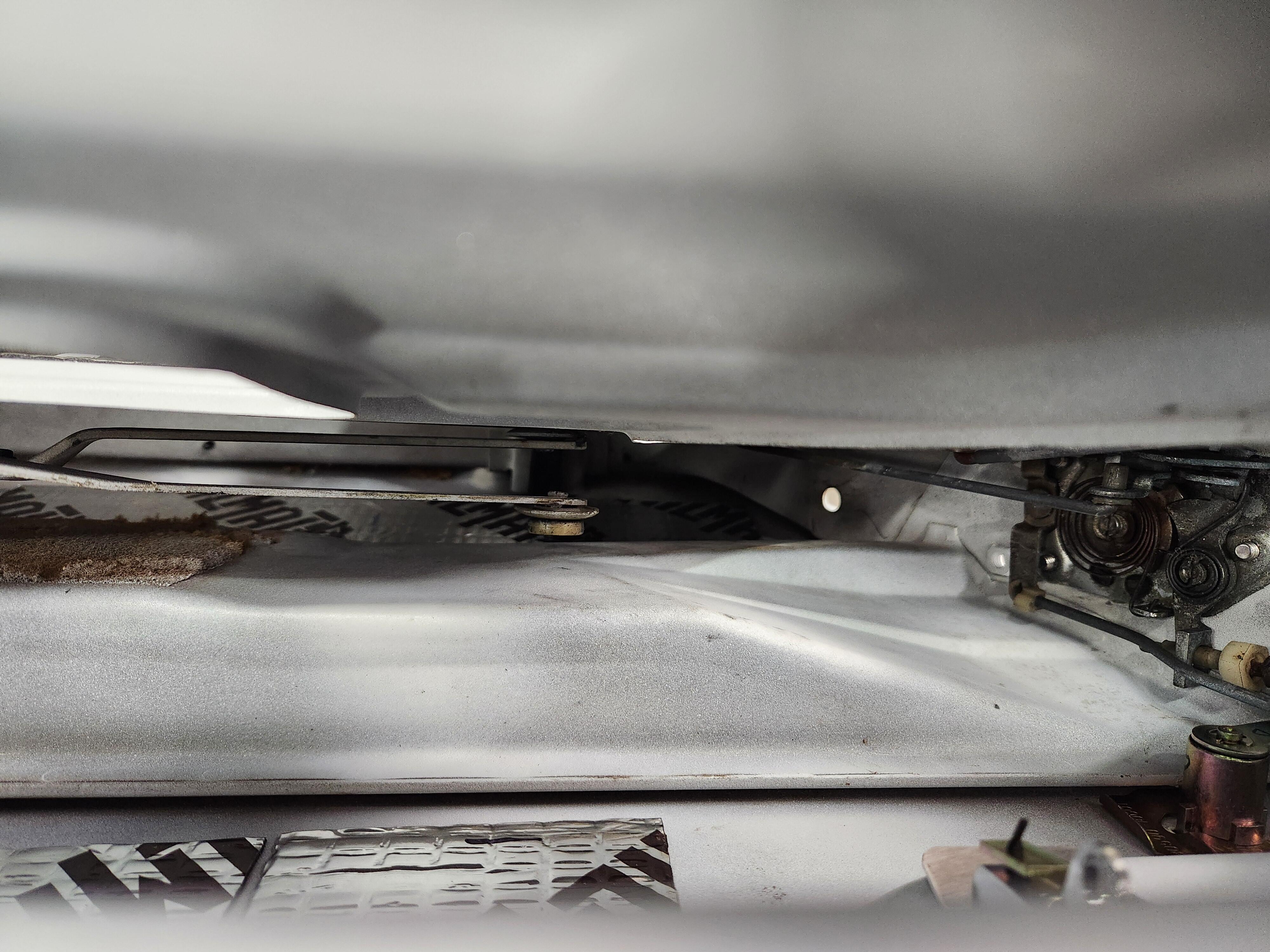

The year of the other vehicle that that the door glass came out of is unknown, I bought a complete door and took the glass out of it.  Upon closer inspection of the door, the inner bracing looks to be different between the donor door and my door:
Donor:
My car:

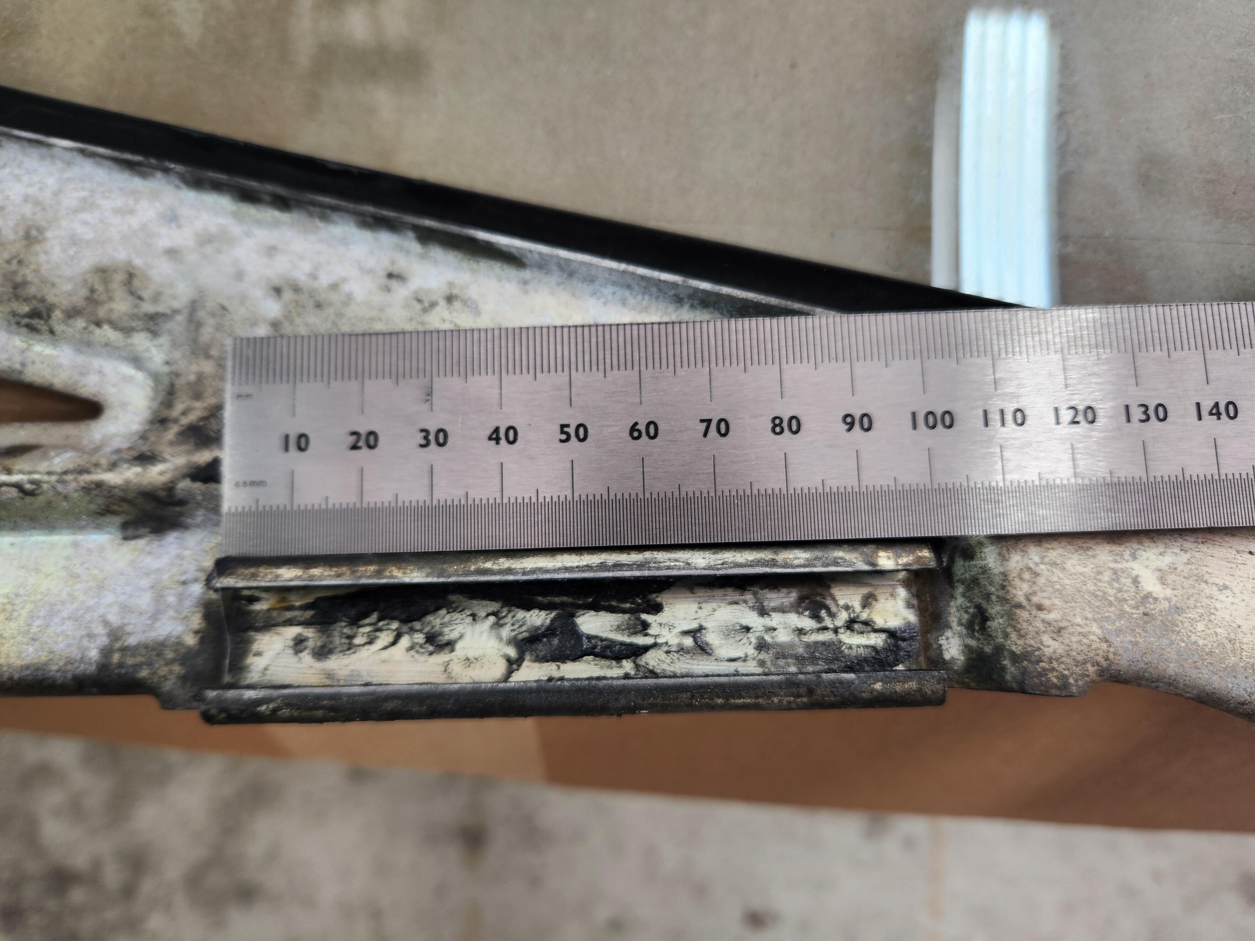

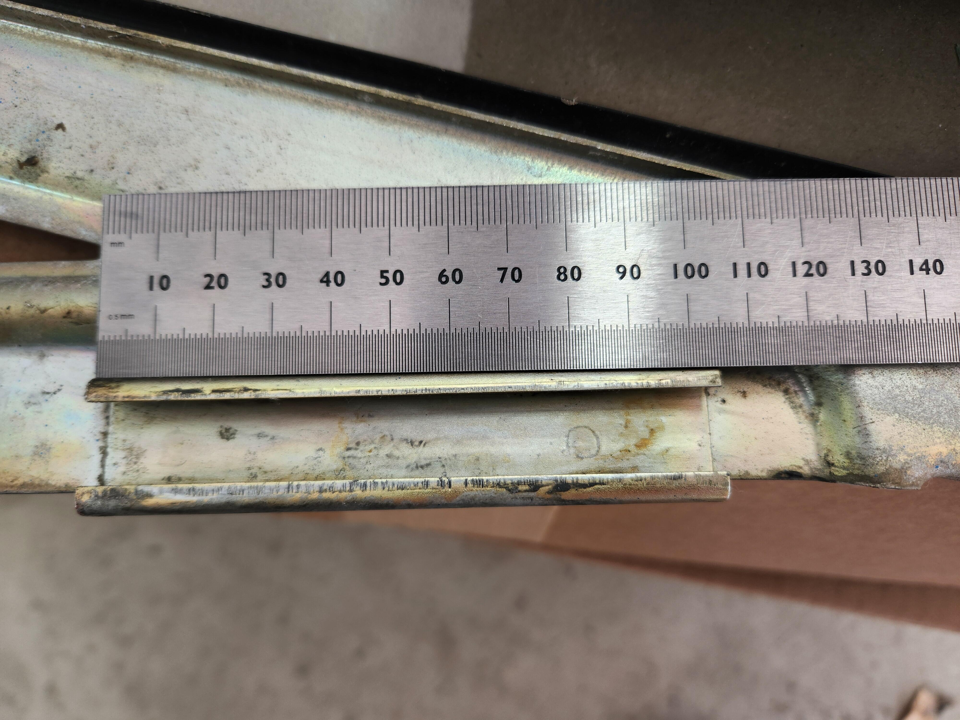

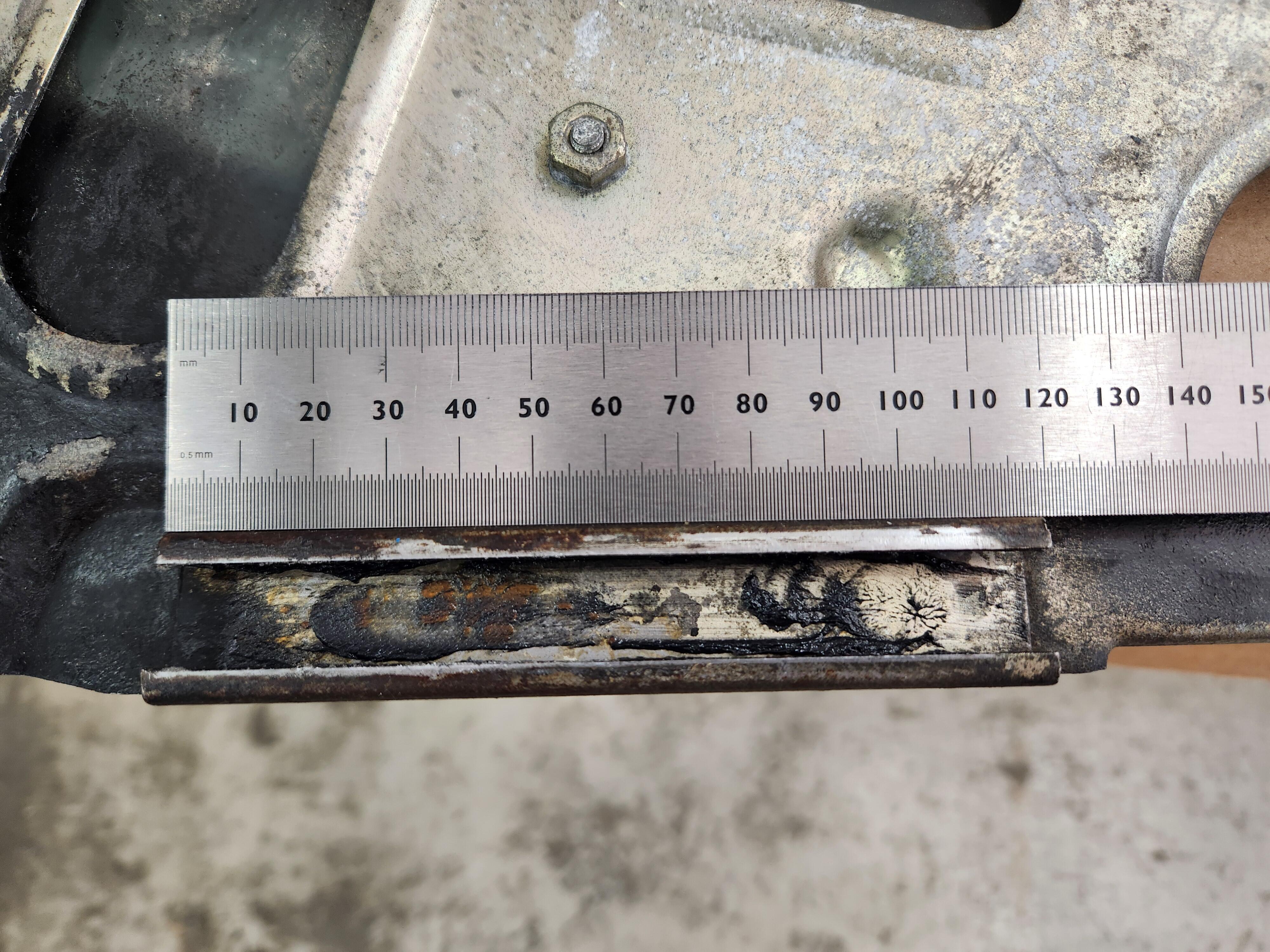

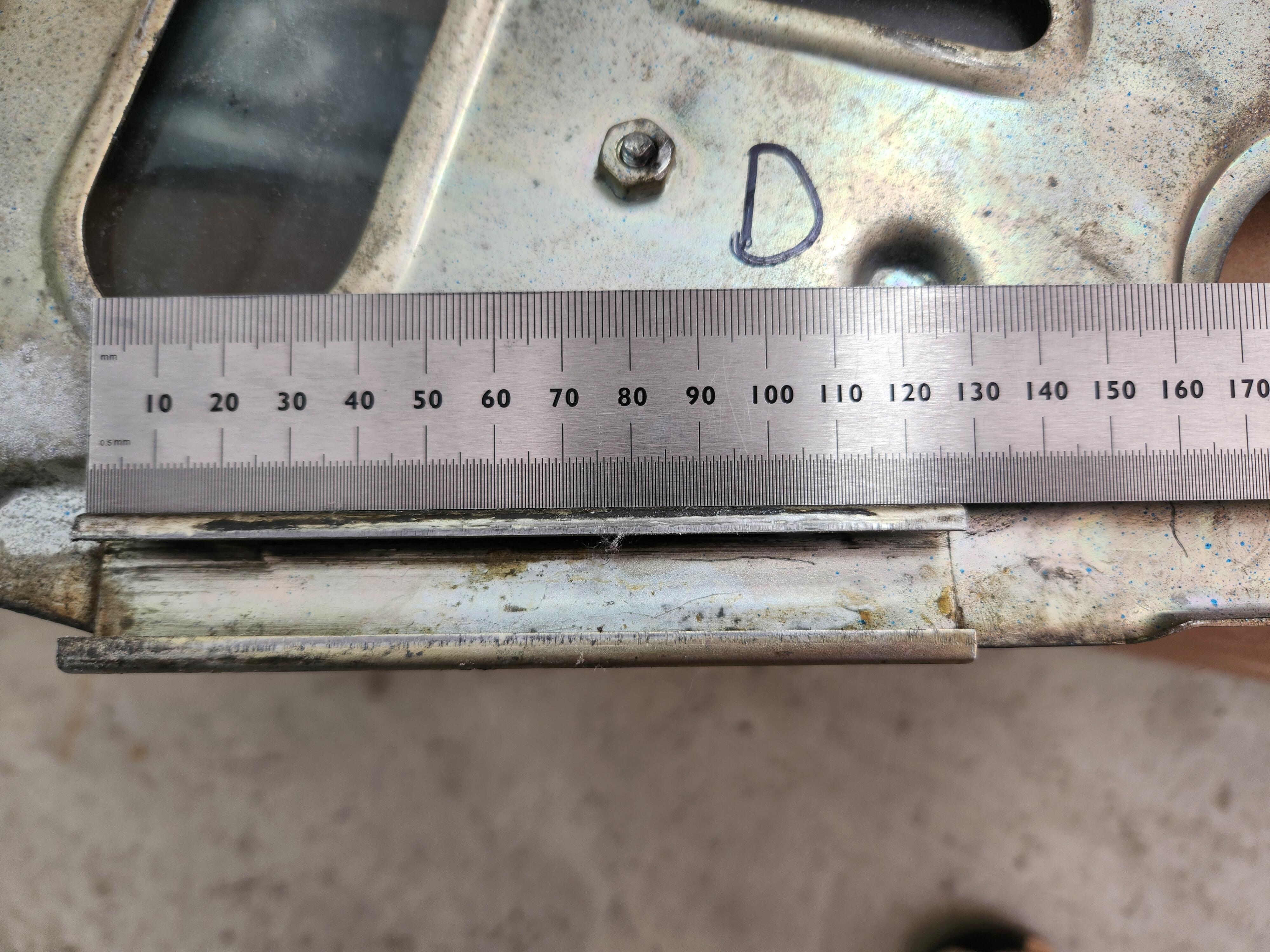

You are also correct that the guides are indeed slightly different
Donor window rear guide:
My car glass rear guide:
Donor front guide:
My car front guide:
Comparison photo, donor on bottom, my car on top
So it looks like I'll need to use the glass that came with my car, or could I just swap to the regulator that came with the donor door?  Not sure what condition it's currently in.  I'm assuming the donor door was off a 240z.

Btw, the 5-7 mm difference is not the problem, the place where they are spotwelded is different, look closely to where they are placed and spotwelded.
(Those 5-7mm is just costst and weightsaving from nissan!)
