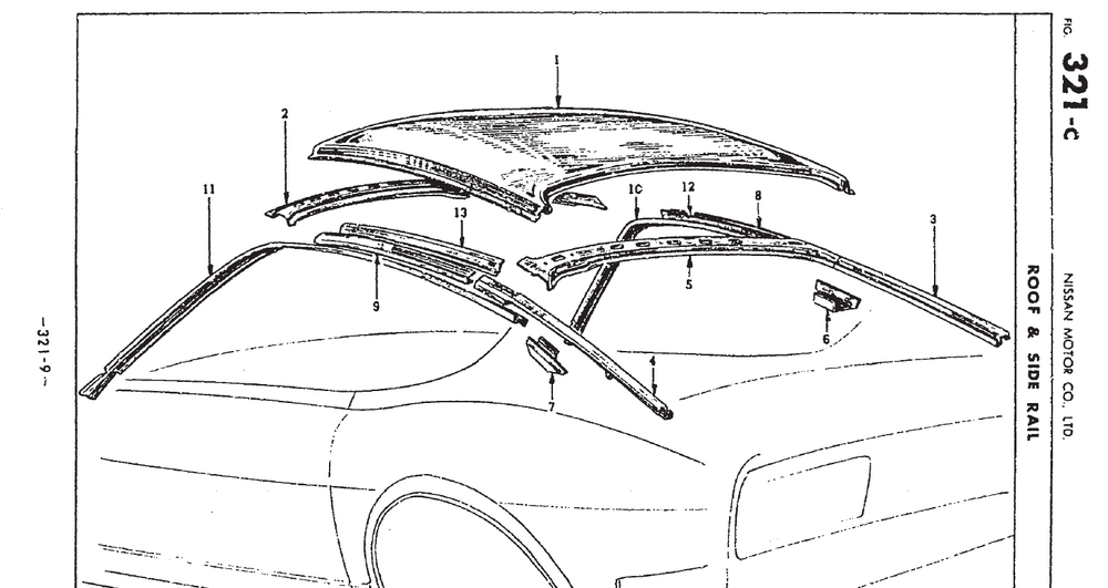

On 10/14/2024 at 3:42 PM, texasz said:
I have a shell that I'm about to cut up for parts to save other cars.  I will not need the roof and will be putting it up for sale.  Where should I make the cuts for this piece?
Get a propane torch and go back about 3-5 inches on the rear pillars above the quarter windows. Melt the body lead out and you'll see the welded junction between the roof skin and the quarter skin. Cut through the rear pillars there at the junction. Just go down a bit on the A pillars and cut through there. Turn it over and drill out the MANY spot welds and you can pull the entire roof skin intact off the roof skeleton.
OR - give it to someone else that way and leave them to remove the skin from the skeleton... It's safer to handle with the skeleton still attached.
Halfway the a and c pillars.. (i would) then the buyer can easely make the connections..)
We saw quite a few Z's here in Arizona (and coming from California) that previous owners had "sun roofs" installed during that era when they were a thing. After 20 or 30 years the "sun roof" leaked - and no replacement parts. So we did a few roof skin transplants from donor Z's.
If you remove the roof with the underneath skeleton intact you can drill the spotwelds on the donor from the bottom (drill the underneath skeleton to separate the skin - thus leaving the donor skin mostly unharmed. Drill the damaged skin (or skin to be replaced) from the top thus leaving the roof skeleton intact on the project car.
Cutting at the junction between roof skin and quarter skin is fairly simple once you remove the body lead (melt the body lead out) that covers this junction. And it's a great place for your weld when installing the donor skin since it's going to be covered with fill. With the A pillar, the replacement skin will only require a small weld that's easily ground down and smoothed in - if you remove just the damaged skin (or skin to be replaced) and leave the skeleton and pillars intact on the project car.
My advice is to remove the roof so it can be used as a donor in this manner. Plus it leaves the quarter panels intact.
