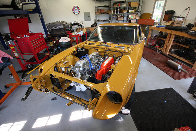

p.s. I like the wood cradle that you built to support the car.  I know of another Z owner who built a rotisserie from wood.
Looks like tin snips and Vice Grips for the body, which is fine, and unfortunately a grinder on the shift lever.
