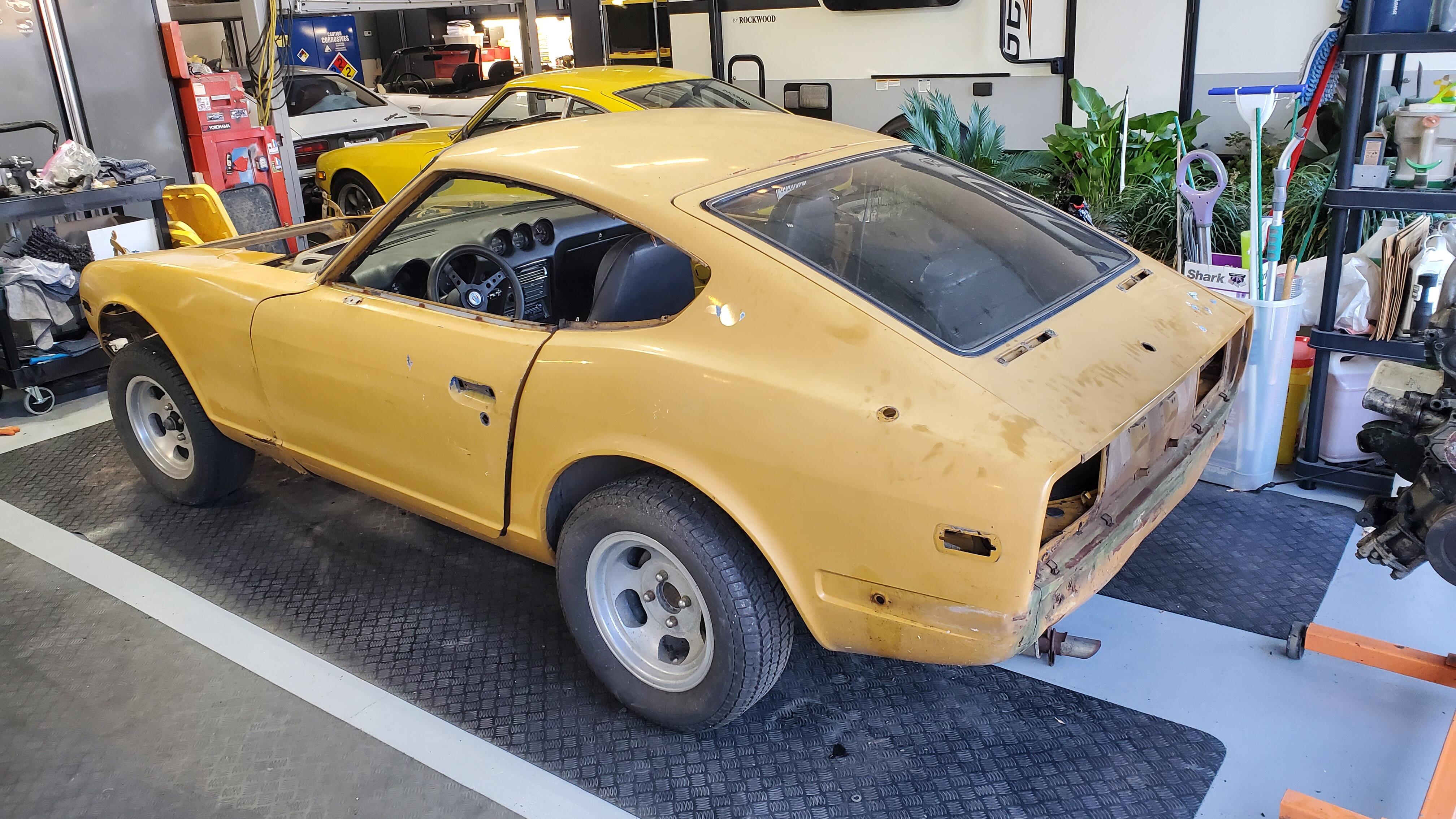

HLS30-00042 arrived this afternoon for a complete restoration.  Boy, this an early one, complete with the original clear rear window.  It's a little beat up, but most of the parts are there.  I own HLS30-02614 in the same color, so by the time I am finished they should be looking like twins.

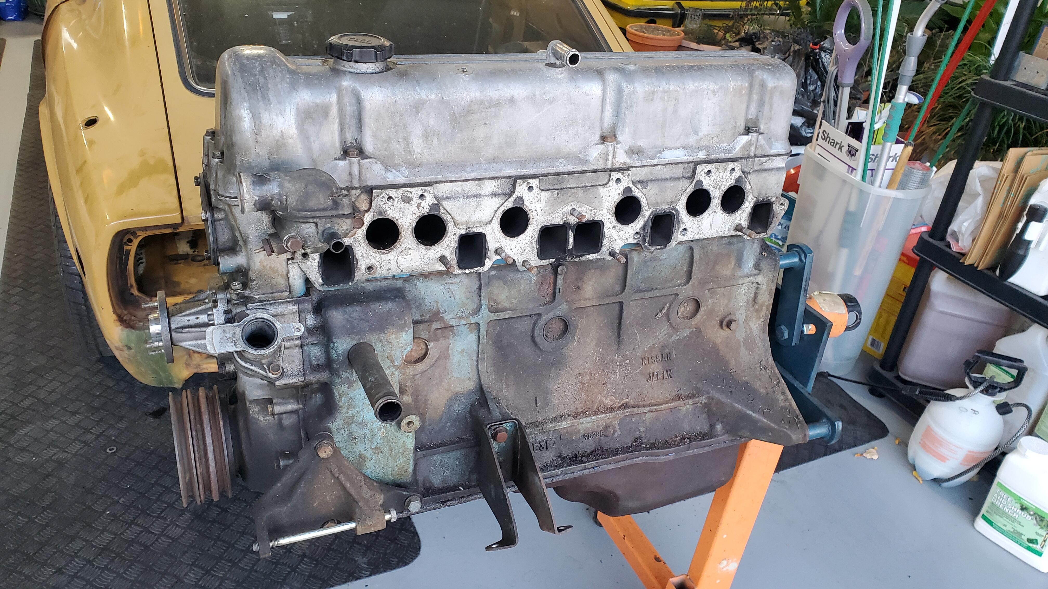

The motor runs, which is great, but it will undergo a complete rebuild.  Amazingly, the head still has the overspray on the lower portion, which is pretty rare to see.  I will see if the machine shop can leave that intact.  There are still a few wire clamps in there and the owner has a metal fan (and a number of other key parts), so we should be able to get the engine bay looking like the original.

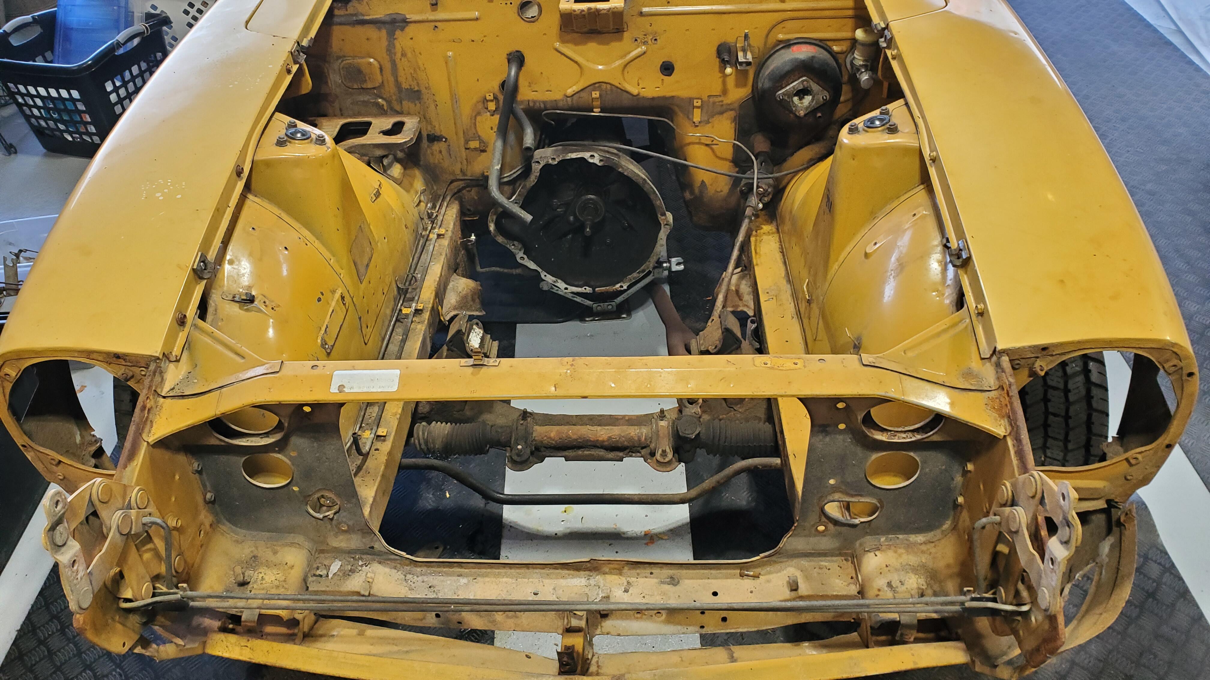

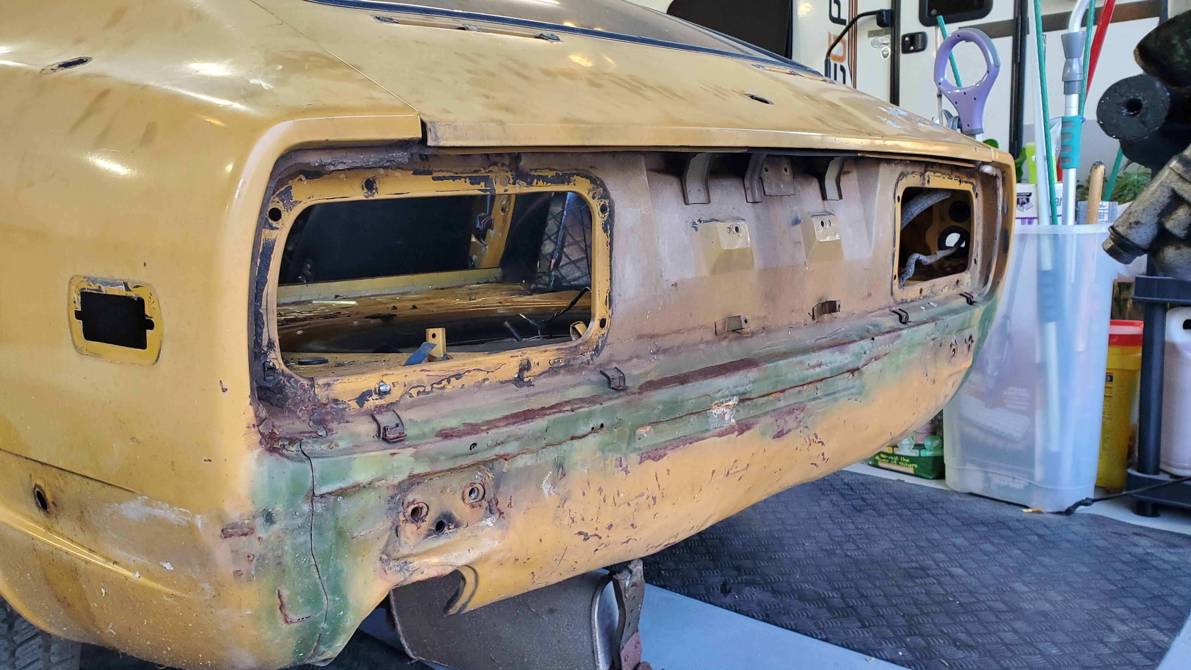

Looks like the hood has been replaced by a later series that was orange.  The drivers side door may have been replaced as well, as there appears to be blue paint under the Safari Gold re-spray.  Also, the rear panel under the rear bumper is pretty beat up and front bumper is missing.  We will need to get one of those.  Rear bumper looks to be in pretty good shape. Both headlight buckets are fiberglass and cracked.  Both fenders are pretty rusted out in the standard places.  Rear hatch panel is also rusted out (as usual) and will need to be replaced by the body shop.
The interior will need to be completely restored as most items are severely cracked or worn.  The original dash has just one crack in the middle unfortunately.  Not sure if that is repairable, I will have to look into that as the single crack is about 2 inches long.  The seats have the original vinyl material which is cool, but not usable obviously (from the pics).

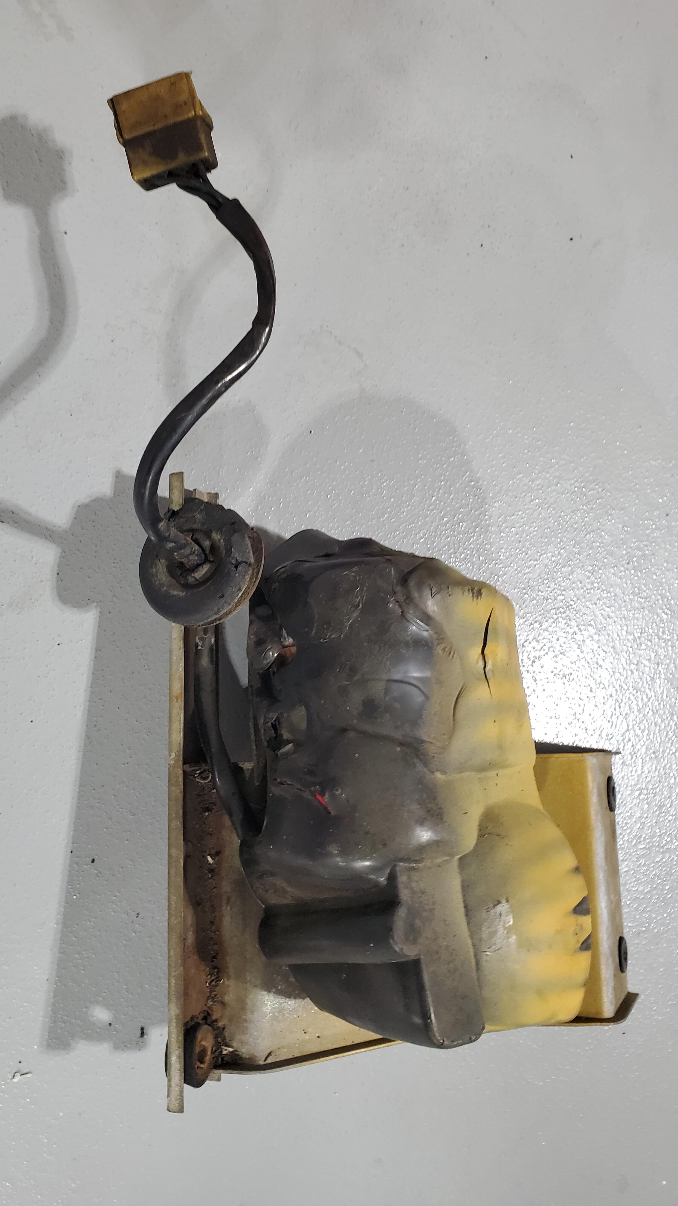

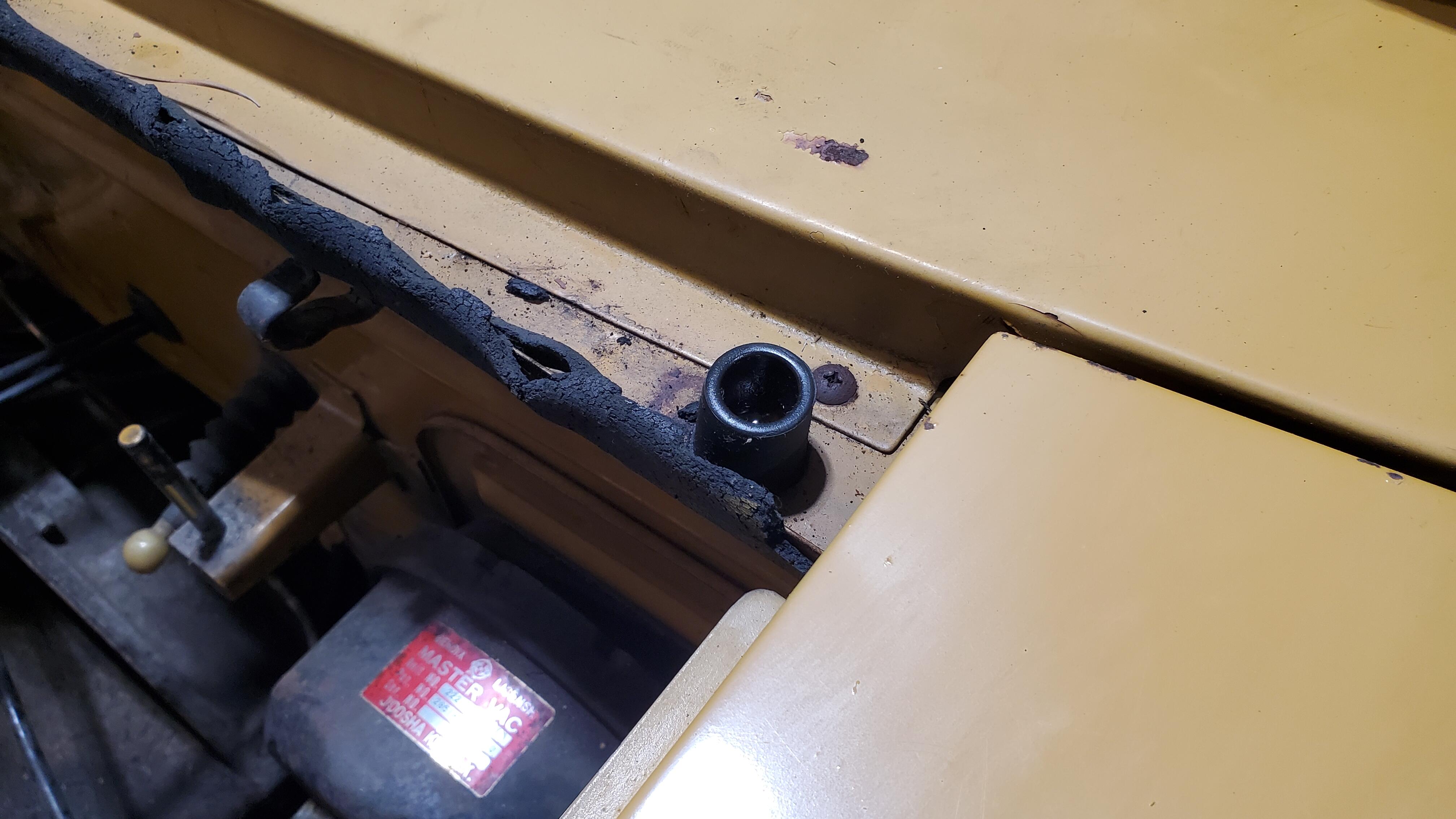

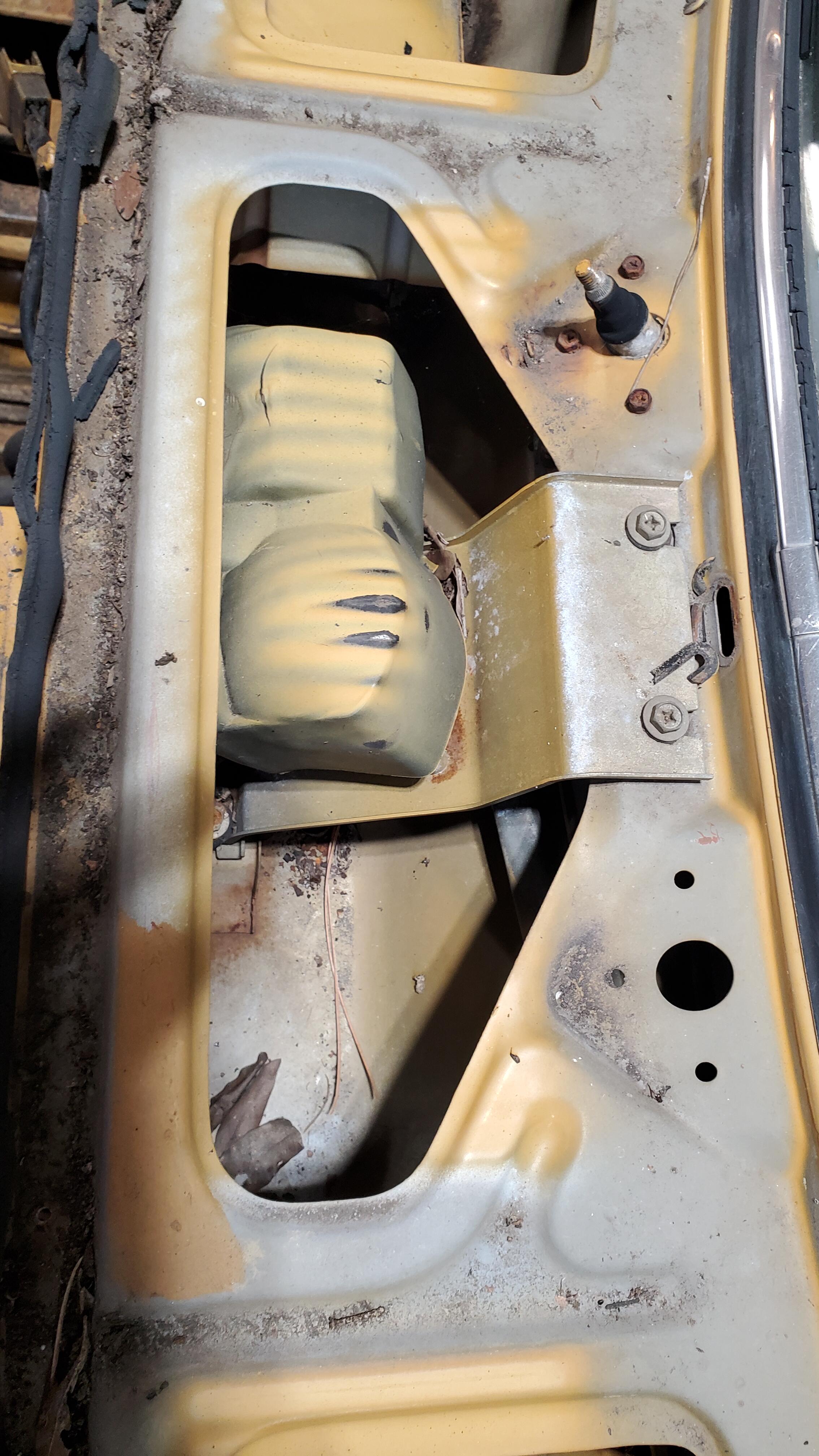

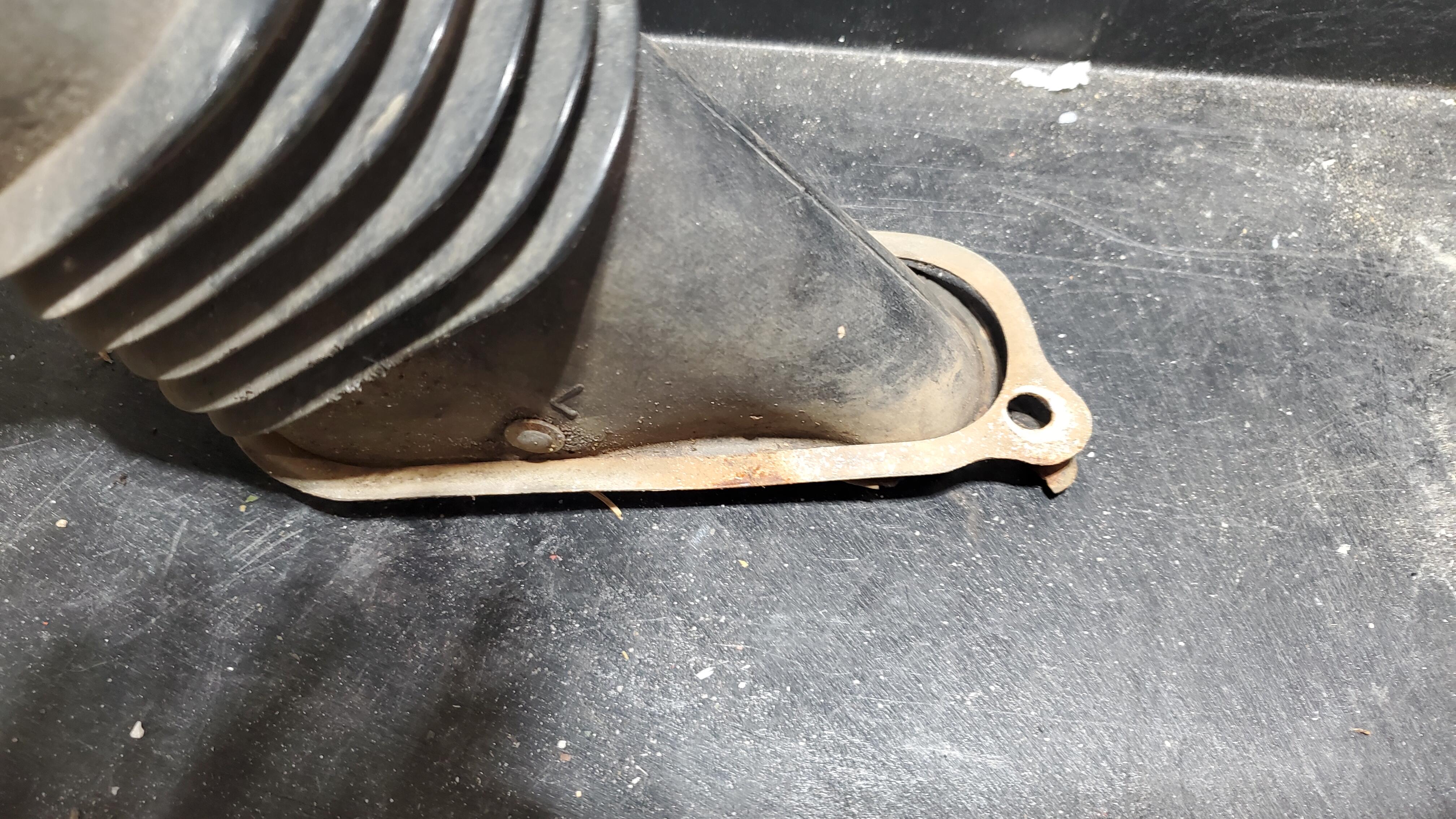

I posted a couple pics of some of the unique early Z items that i have noticed.  Some of the unique items so far (to the best of my knowledge)  include: form fitting washer motor cover (versus the later bag), hood rubber  bumpers, air duct attach bracket (versus tab) , and nice interior hangers.

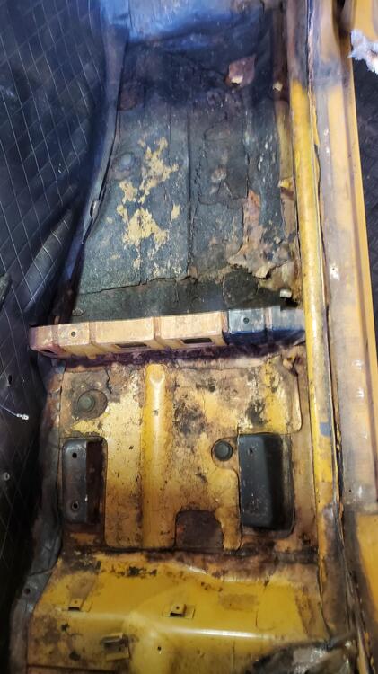

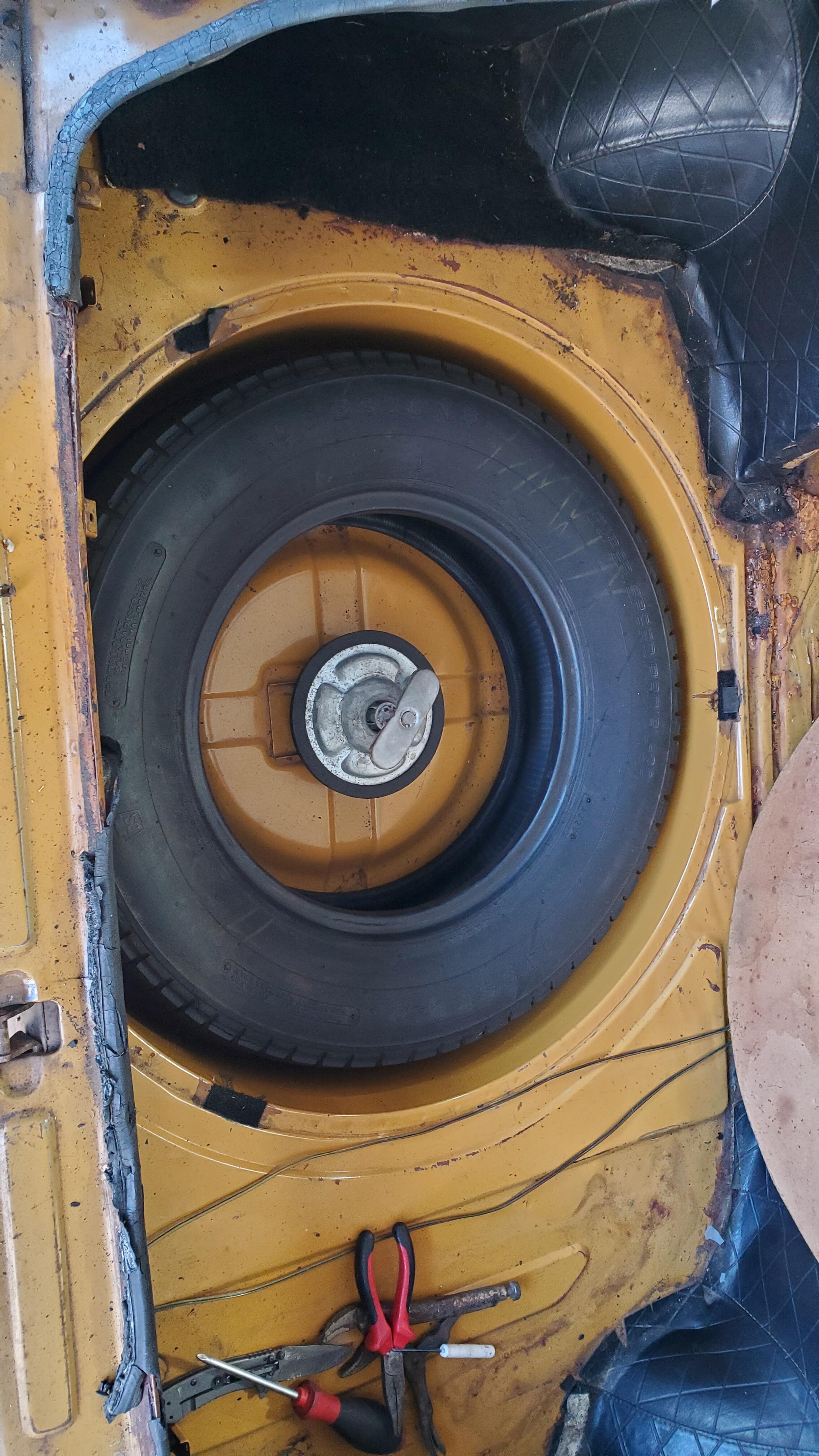

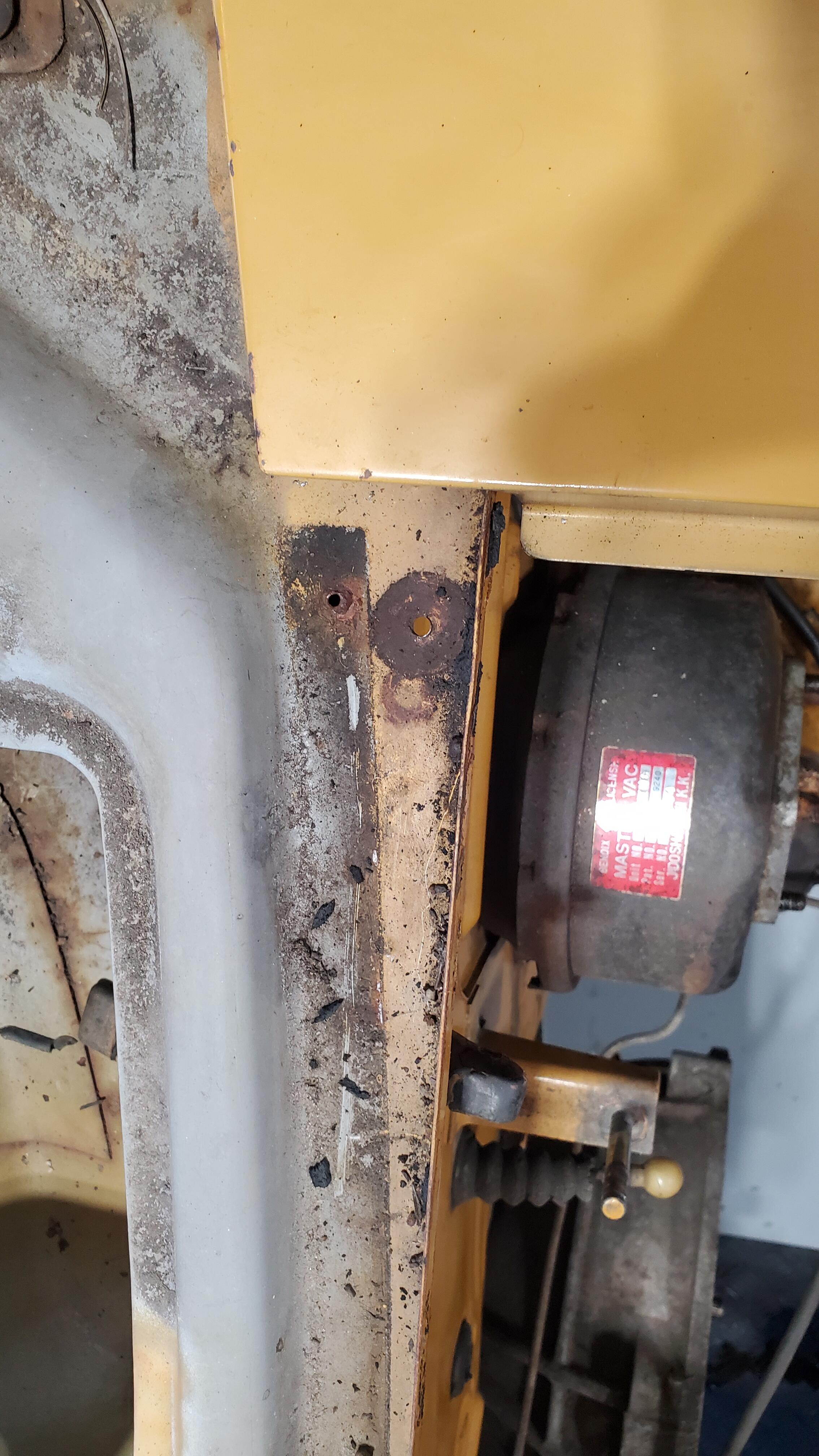

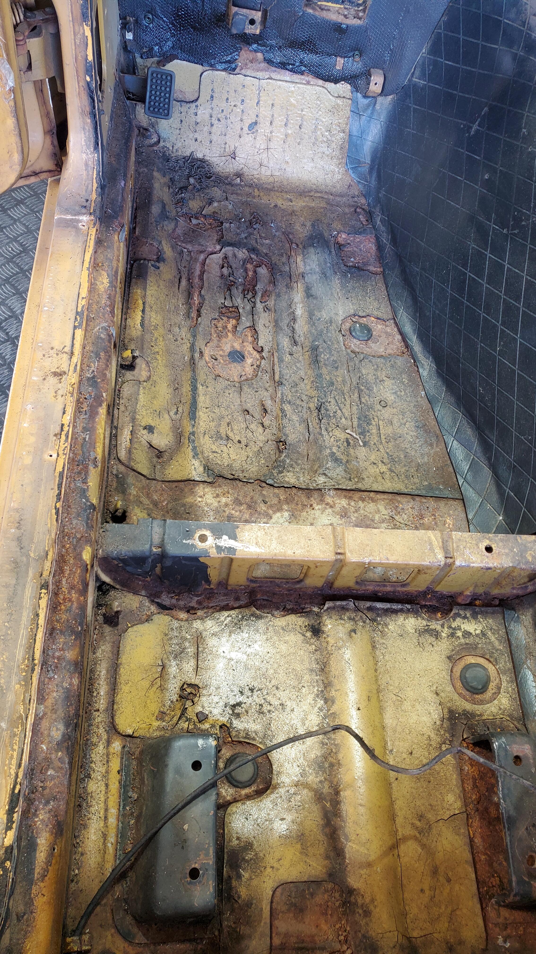

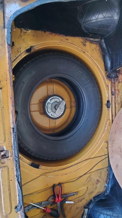

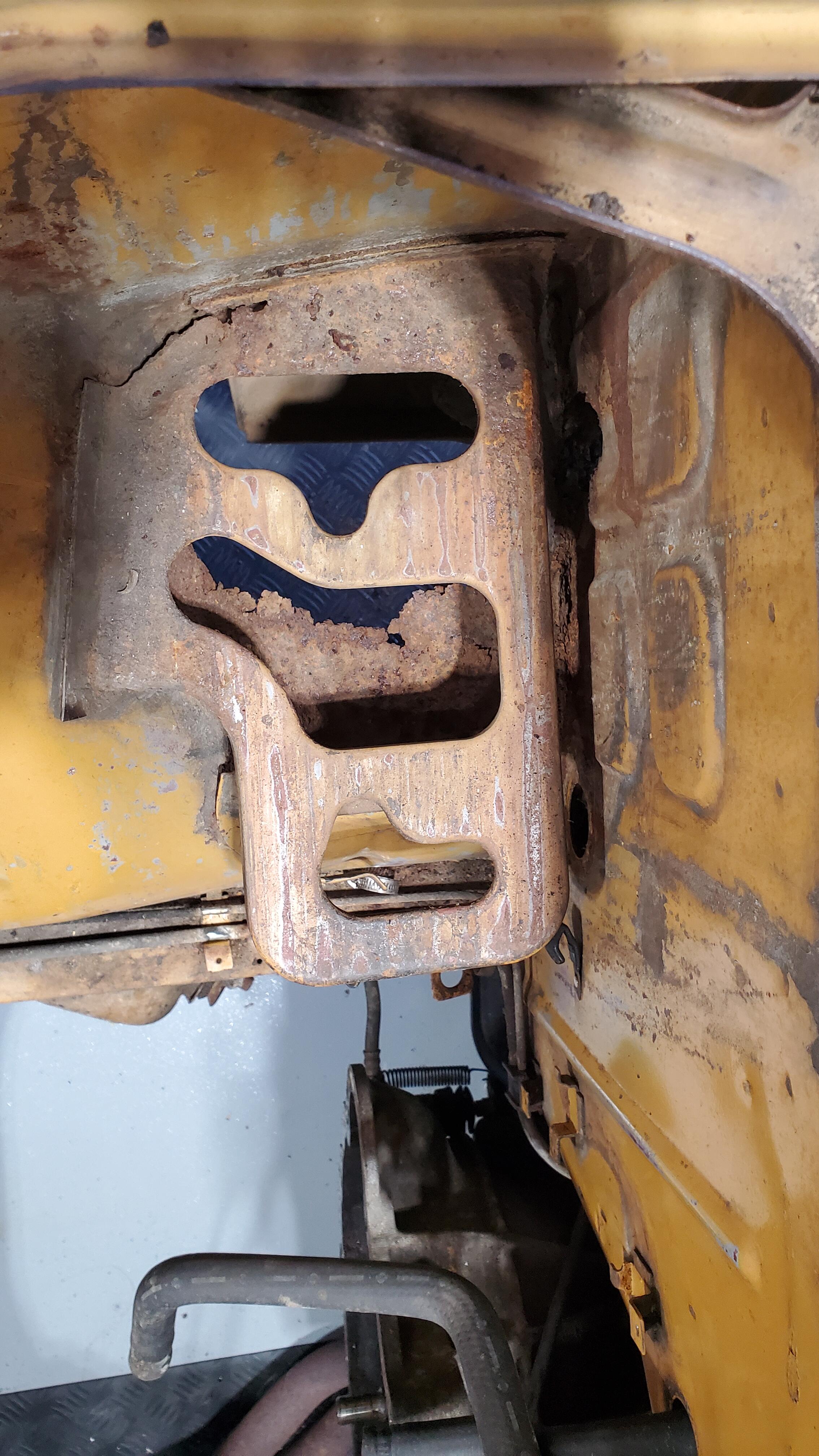

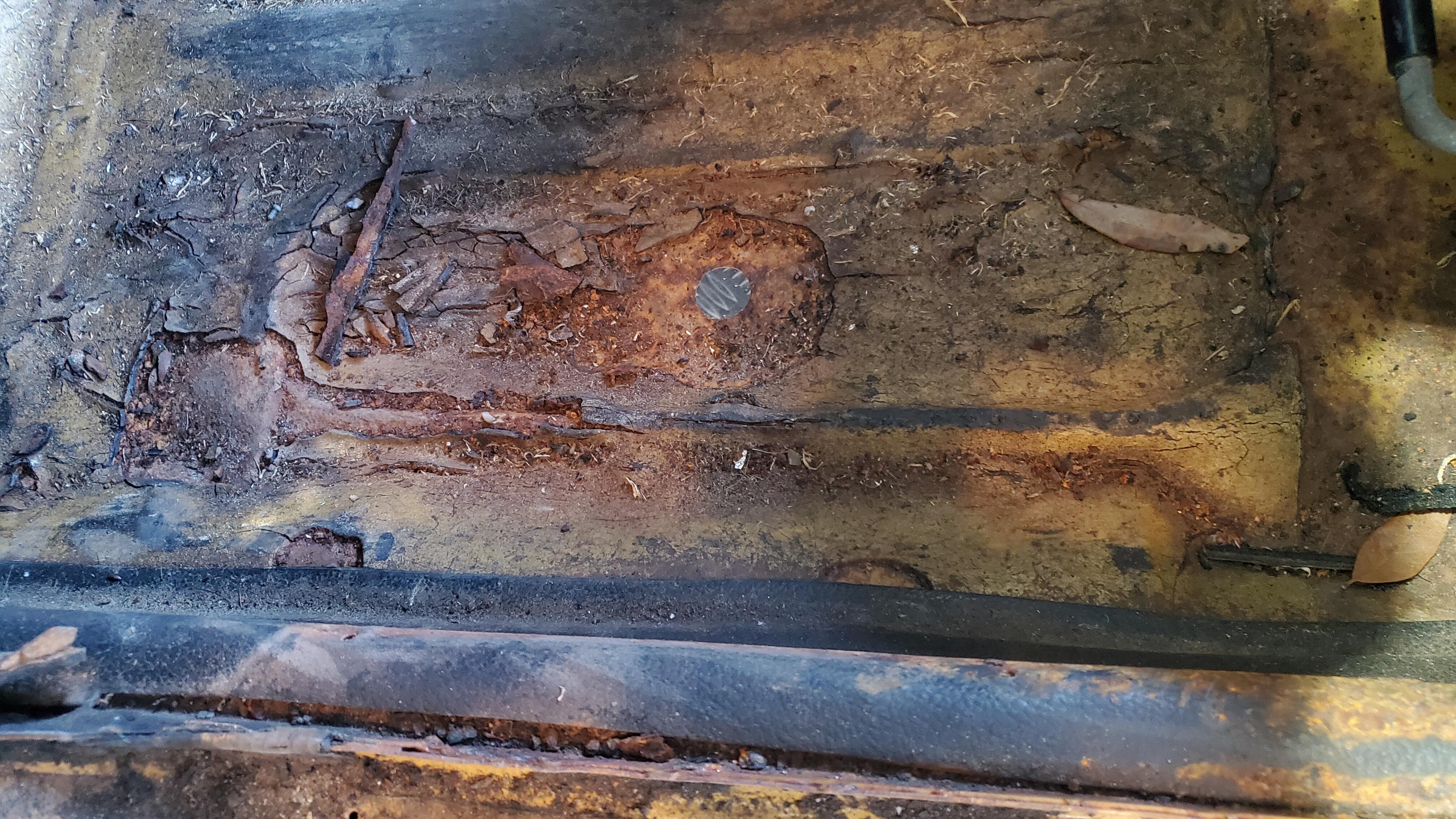

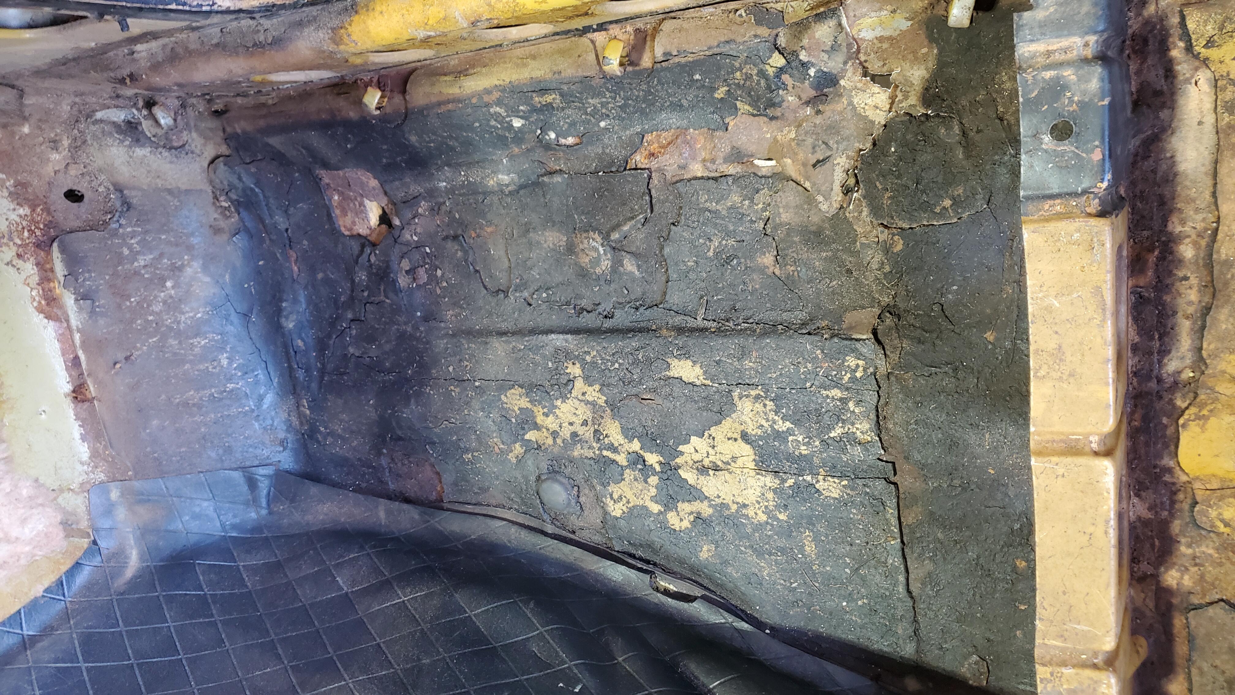

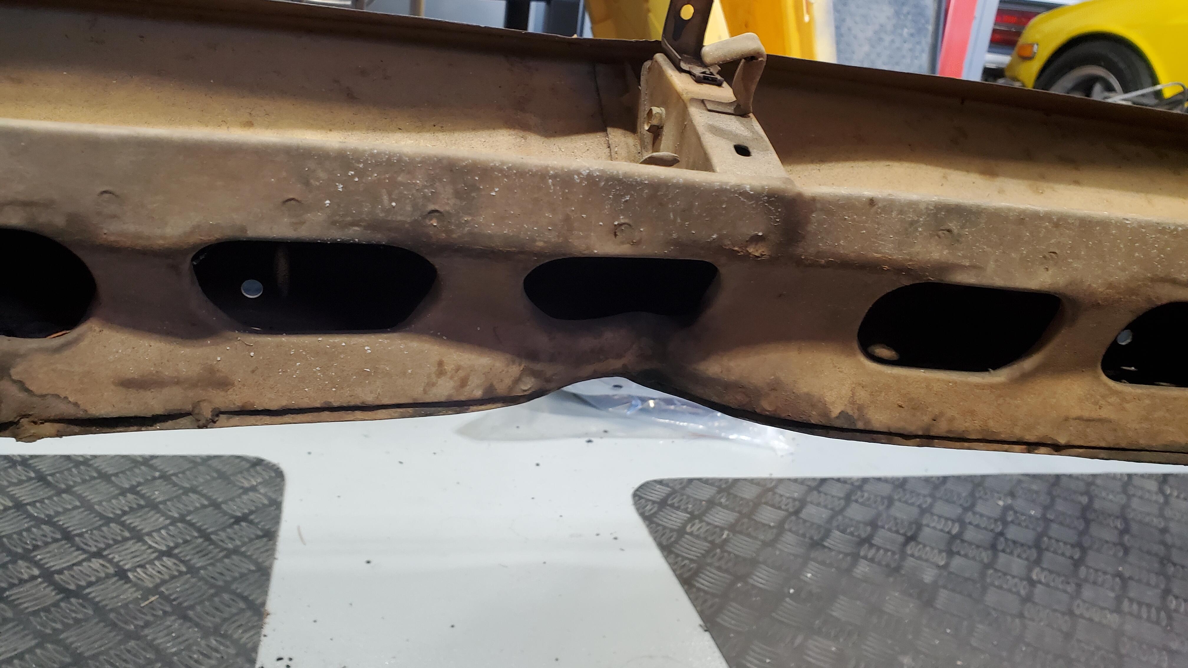

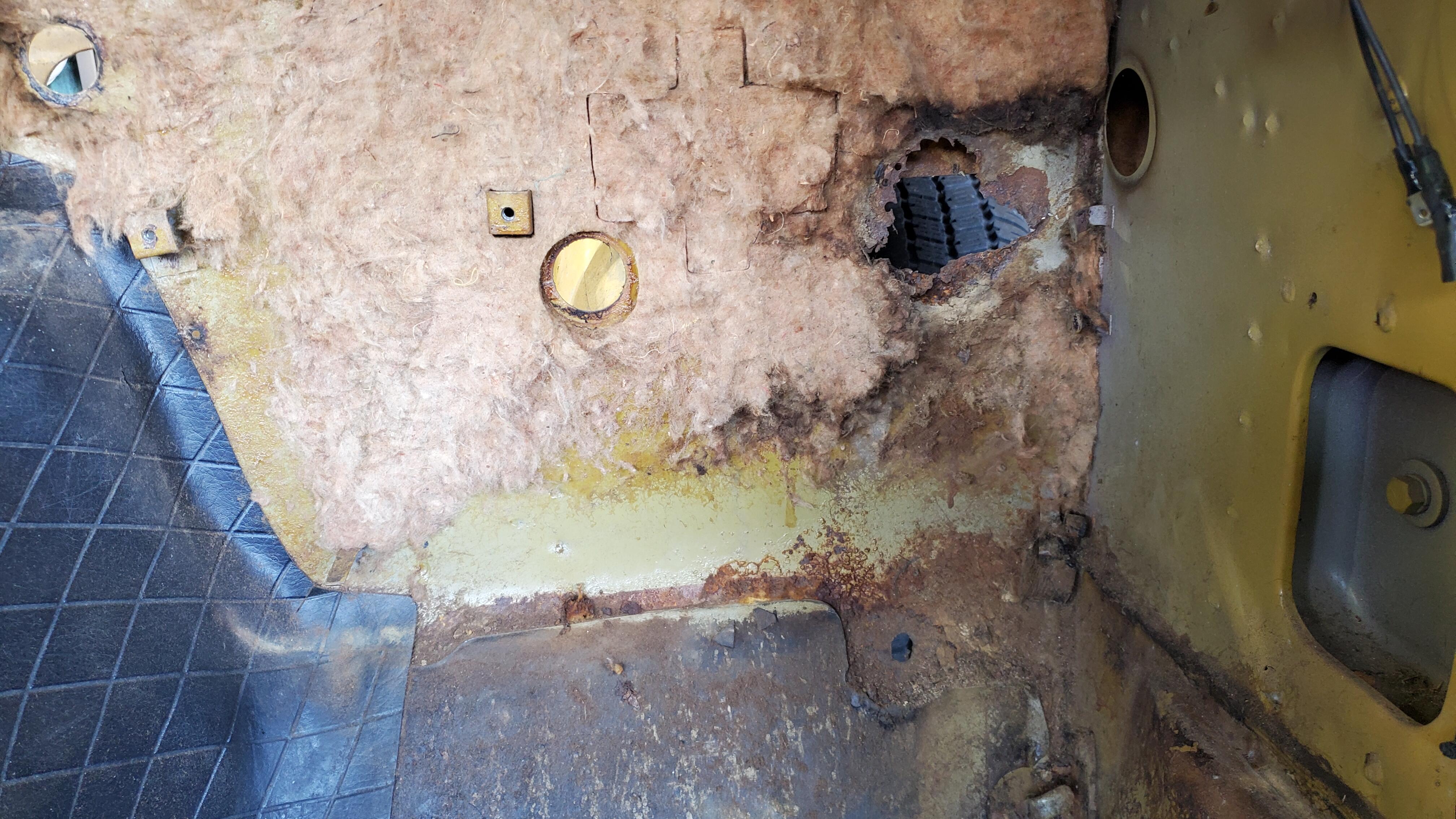

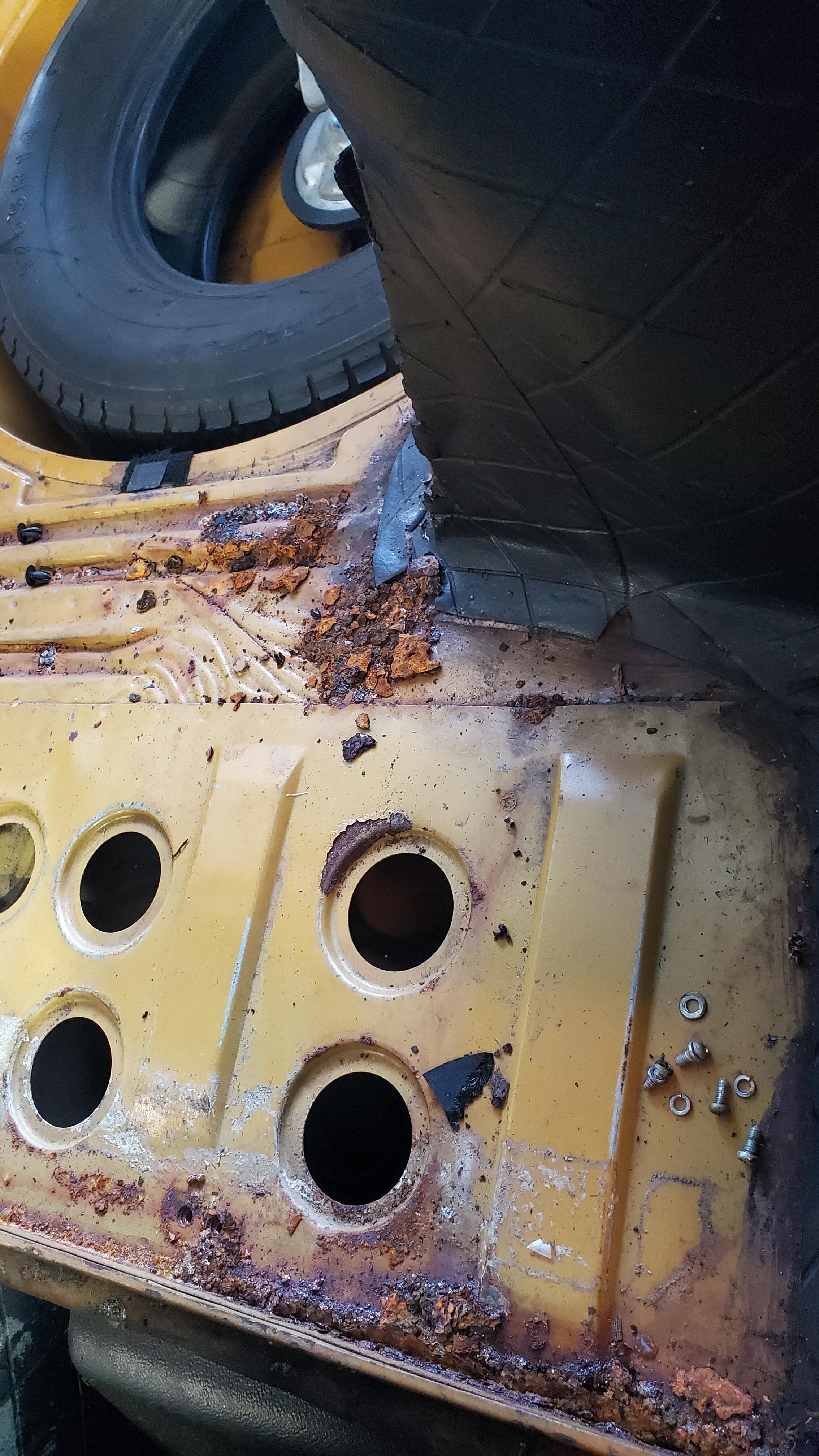

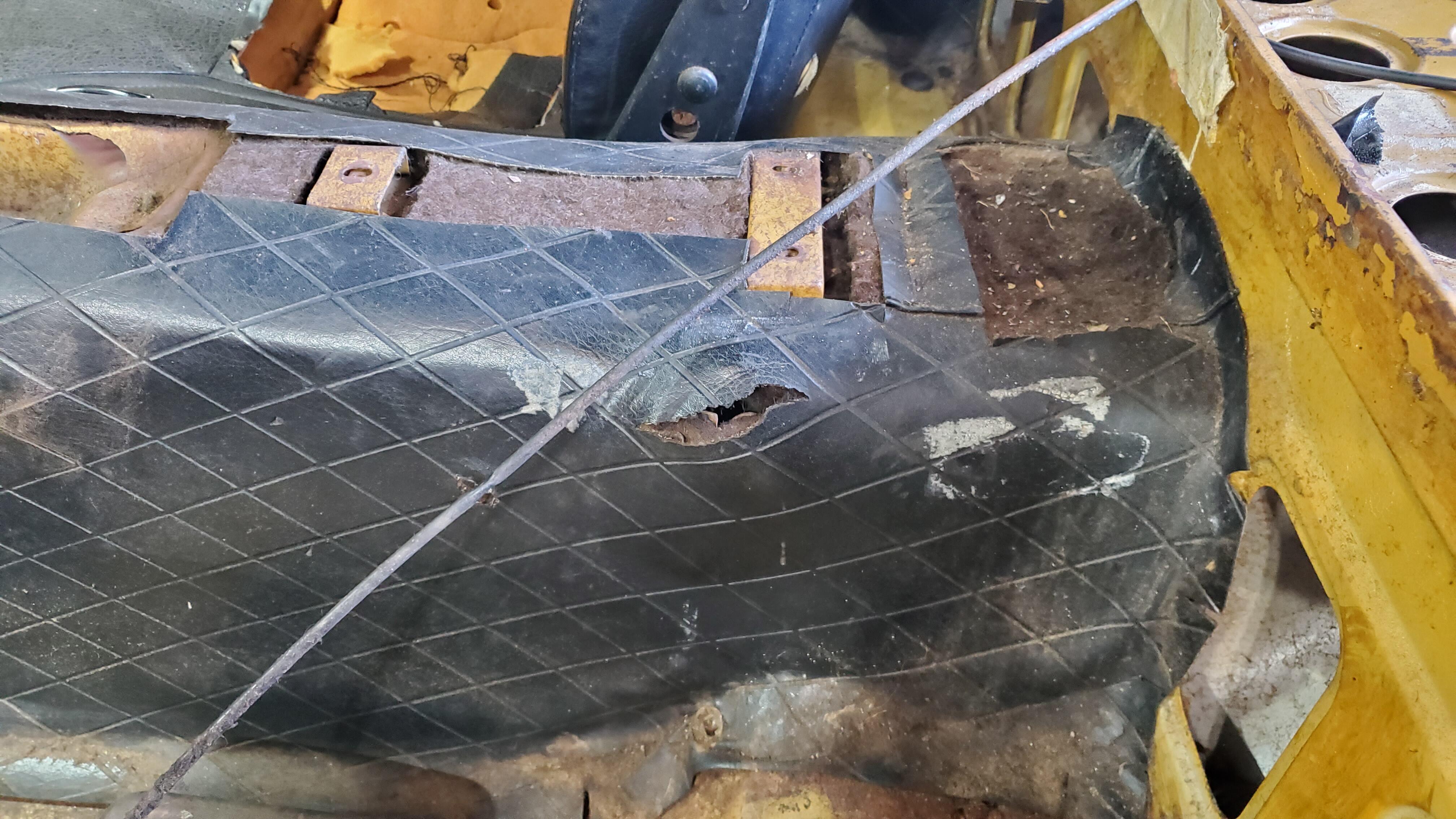

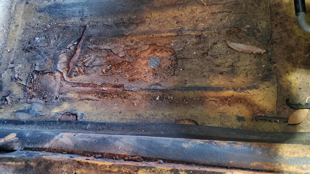

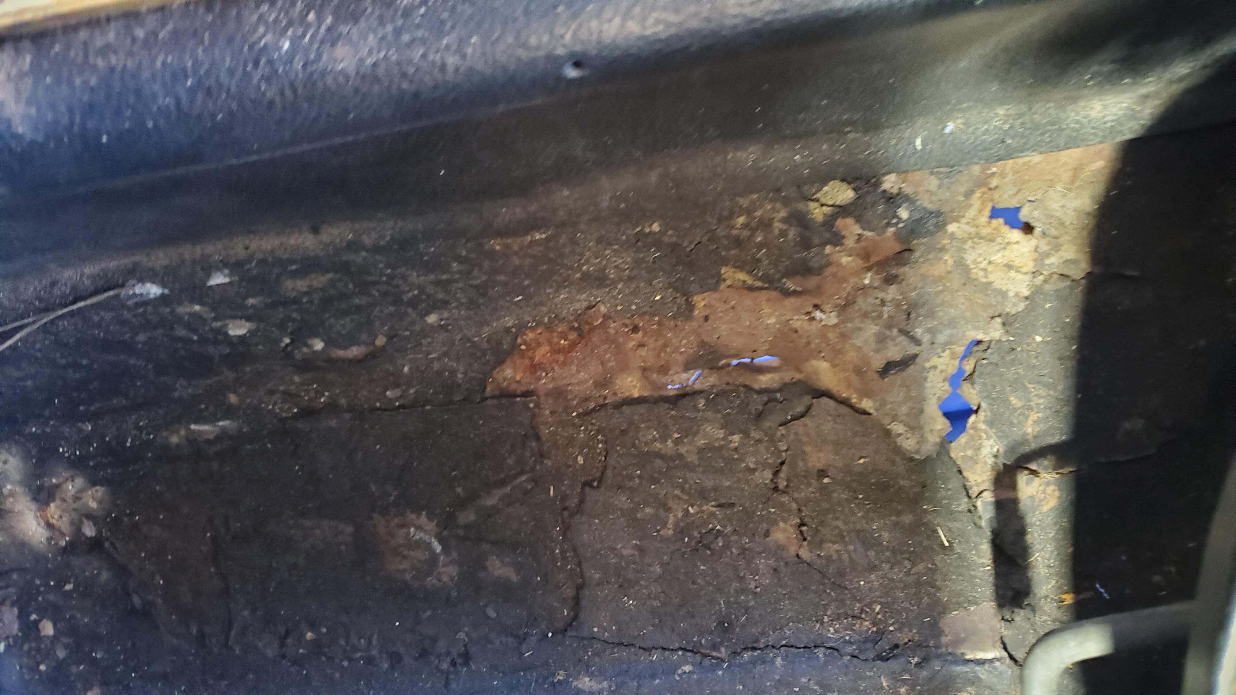

There is a lot of rust, so we will need a number of patch panels in the usual places.  Pictures of some of the rust areas are also below.

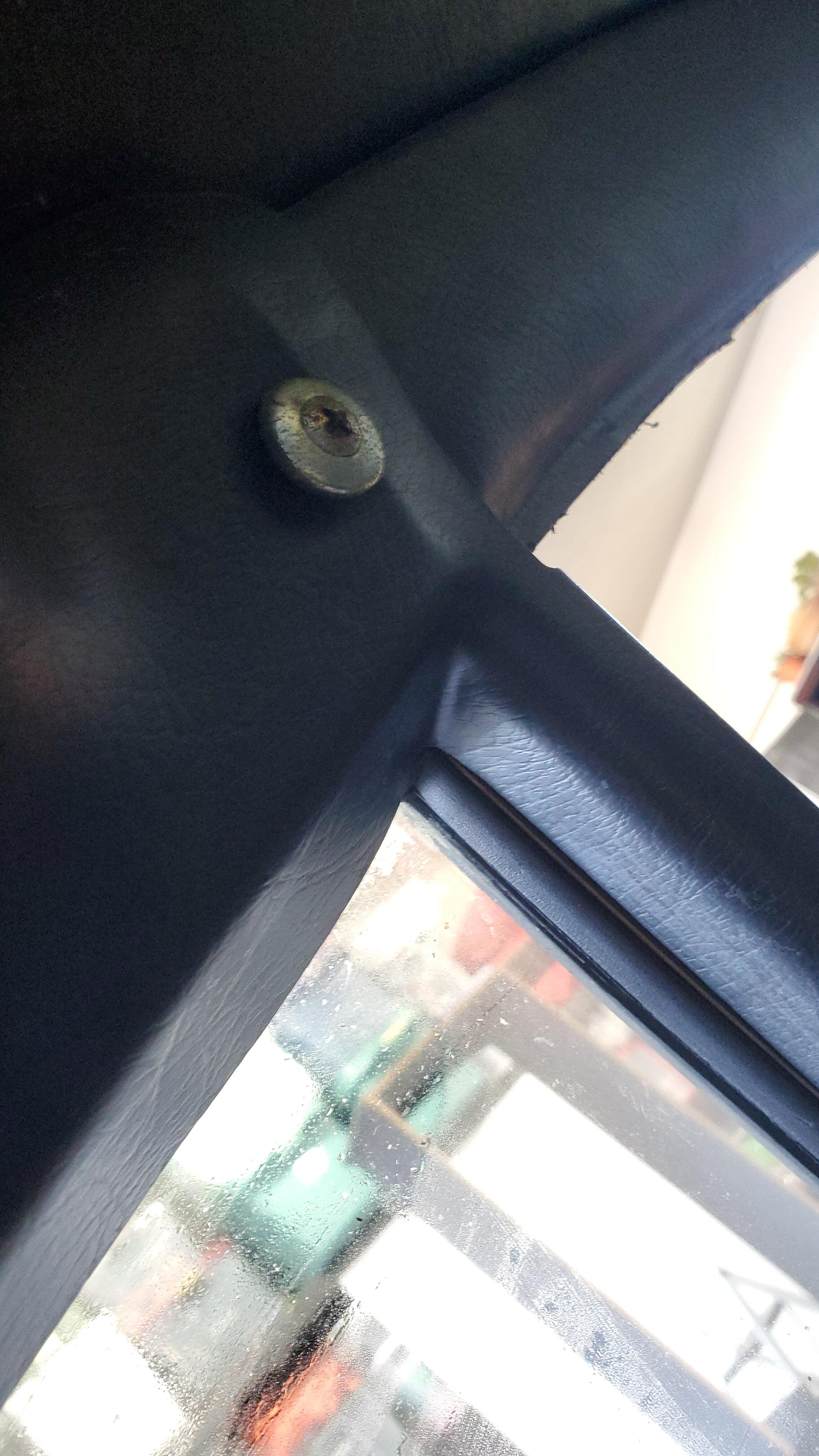

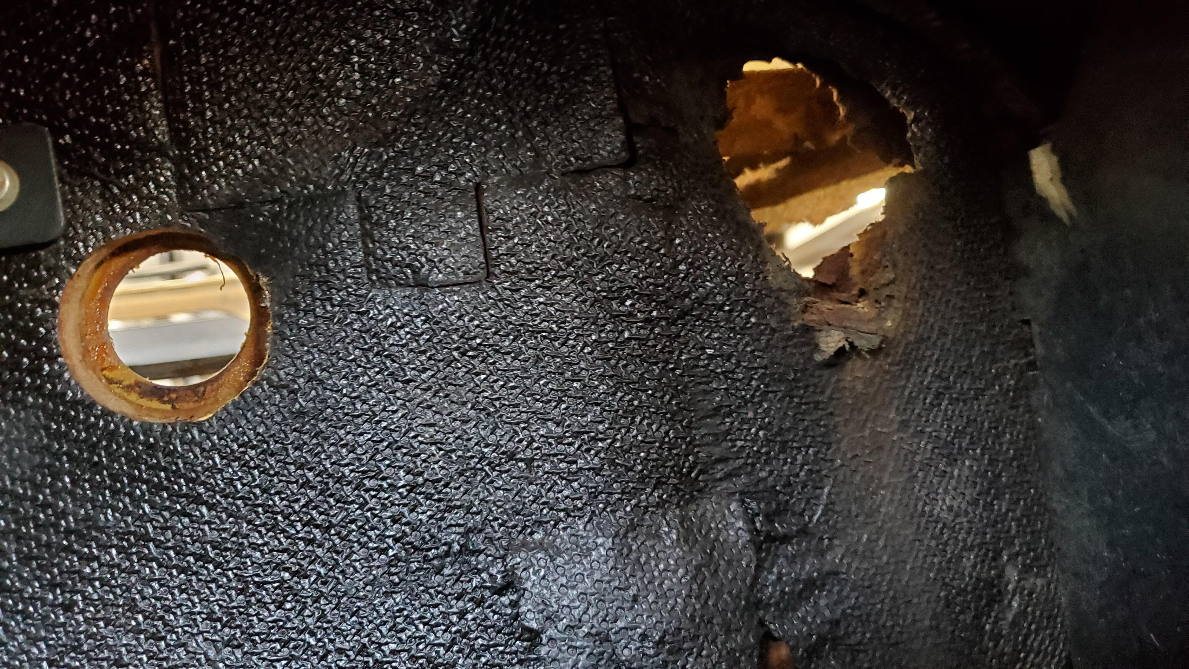

The interior plastic panels were in great shape, much to my surprise.  No need for new ones except for the rear panel that was damaged during a speaker installation.

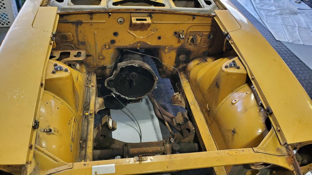

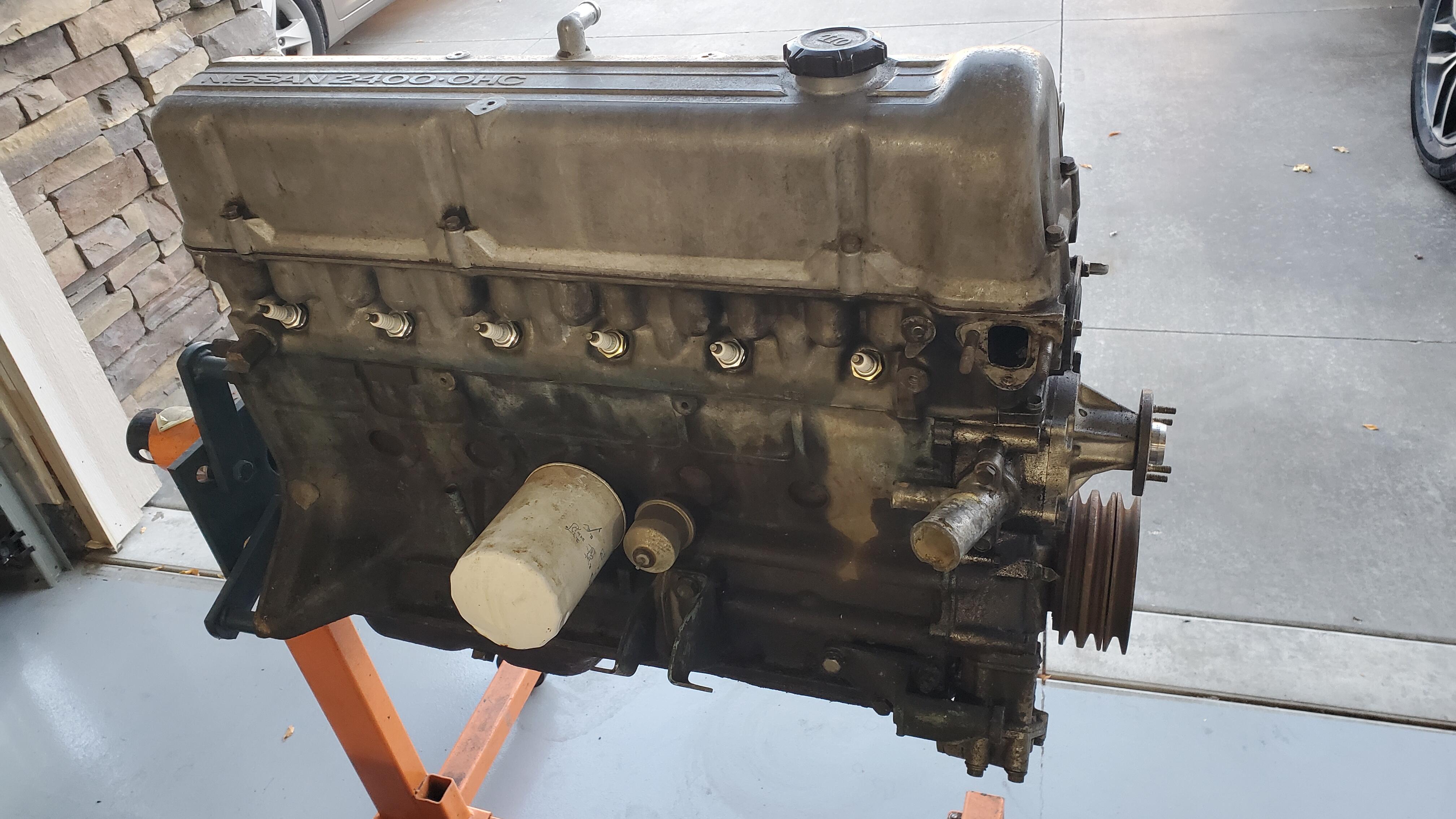

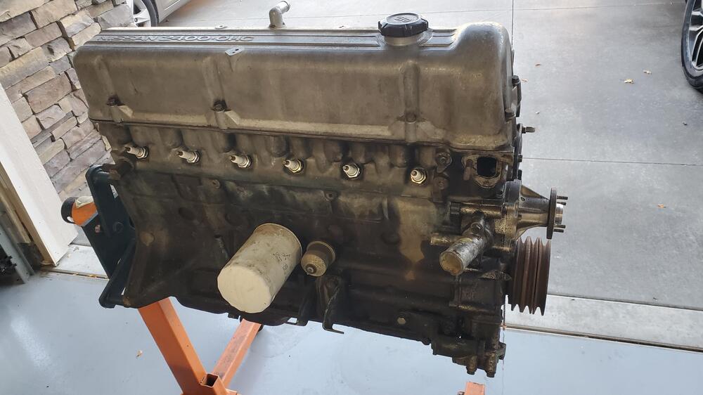

Engine came out easy.

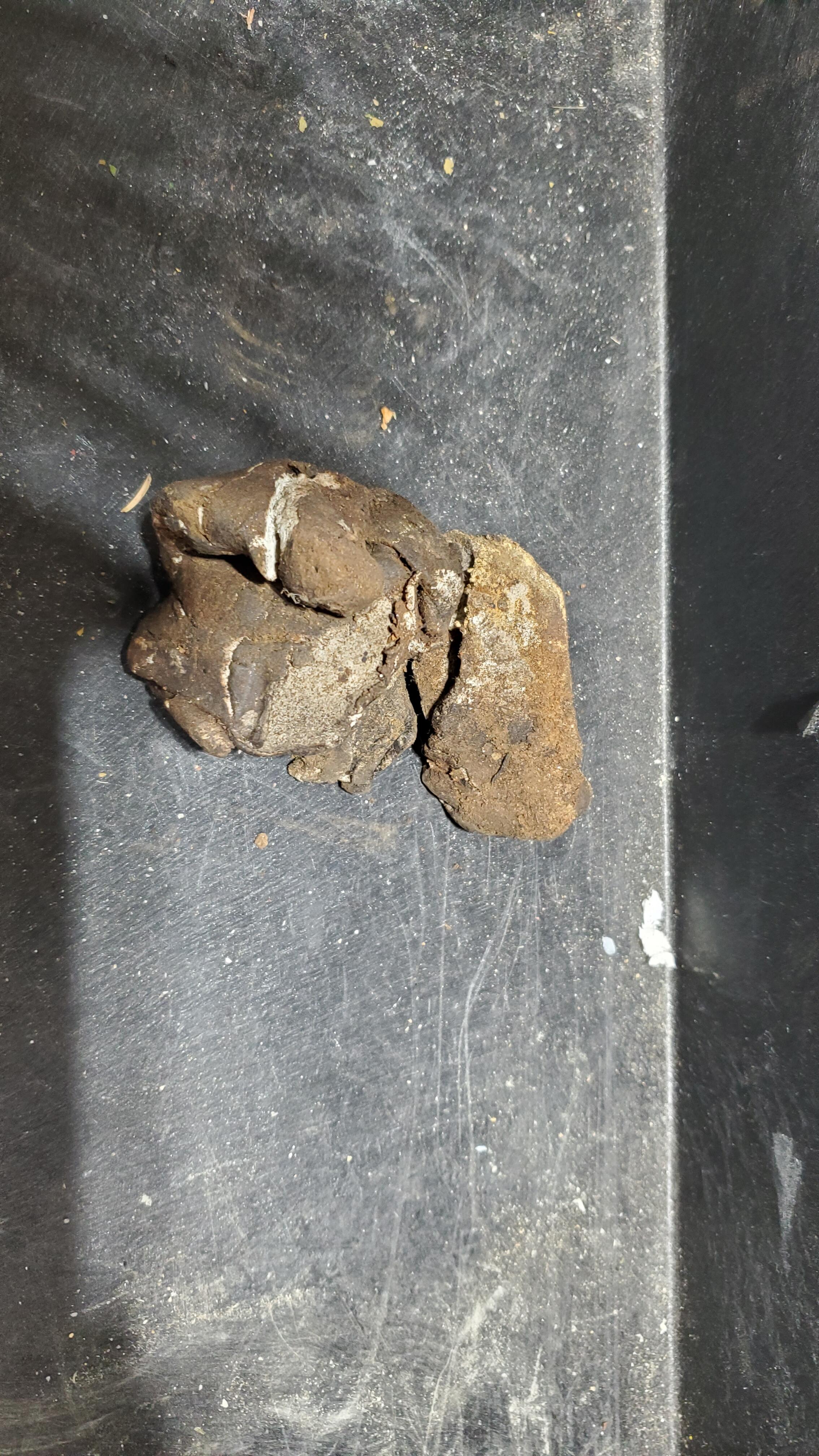

Looks like the car had AC at one time as there is a third pulley wheel on the crank and a large hole in the firewall which was plugged with plumbers putty as shown below...🙃

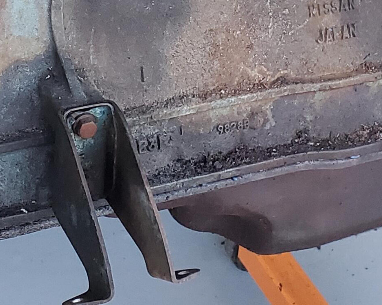

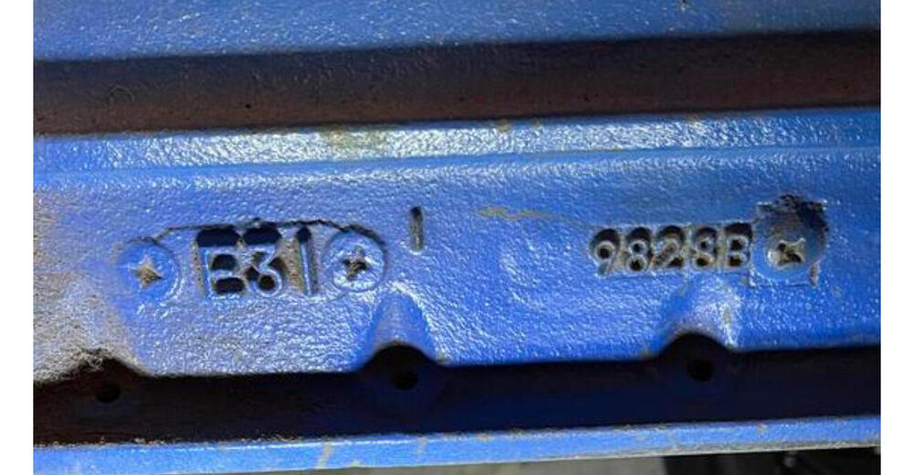

Could you post the engine production number to compare to October cars ?
Edited by dspillman
  On 11/8/2024 at 2:47 PM, dspillman said:
Wow, that is so beautifully complete…
Will be a beauty.!!!
Thanks! Engine number is L24-2079.  You can see it in one of the first set of pictures.
I was looking for production date on the other side of engine…..
same born on dates for

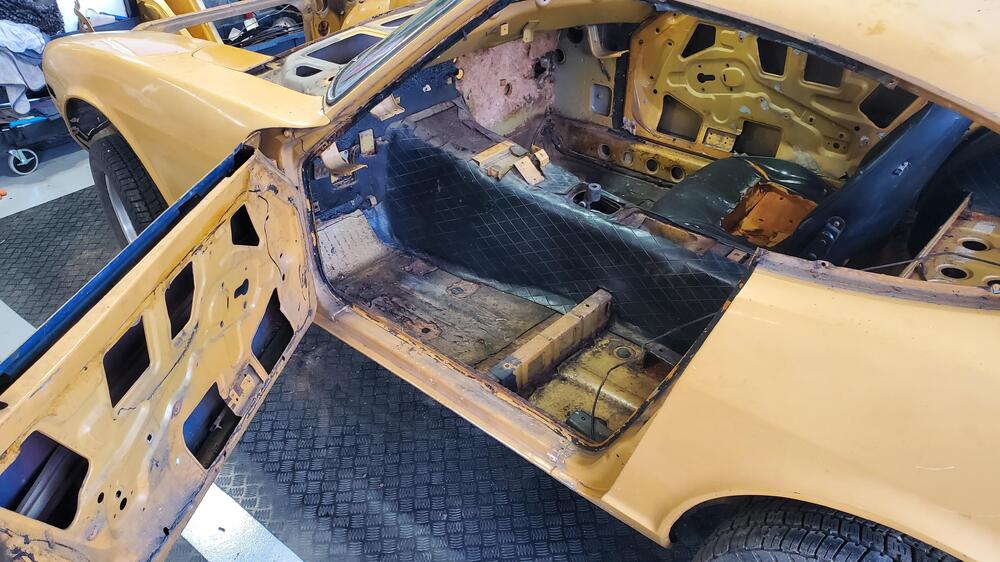

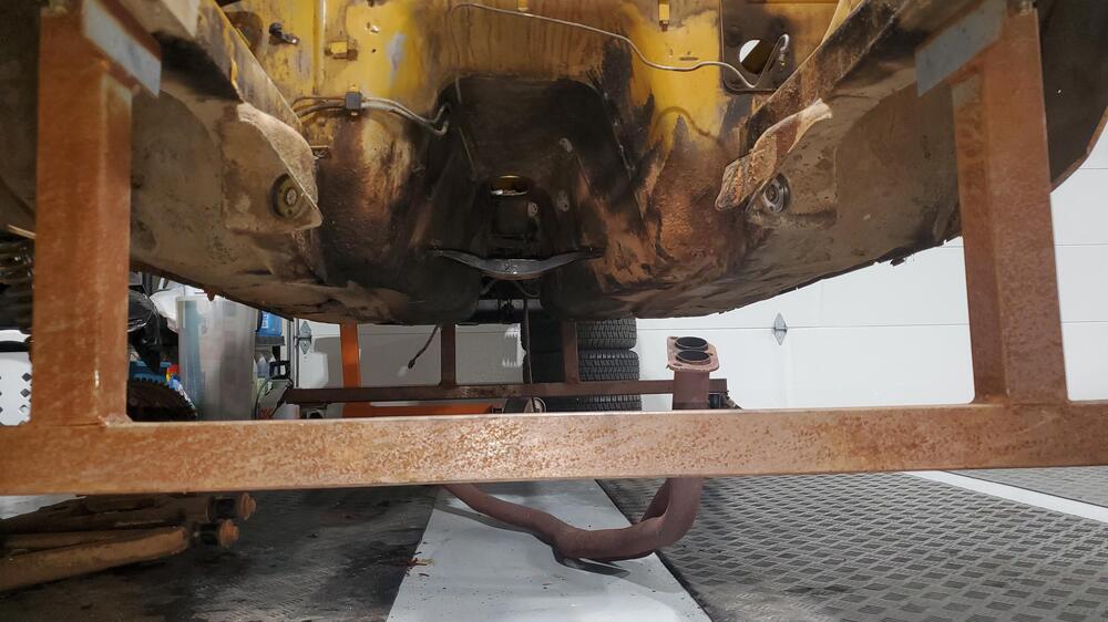

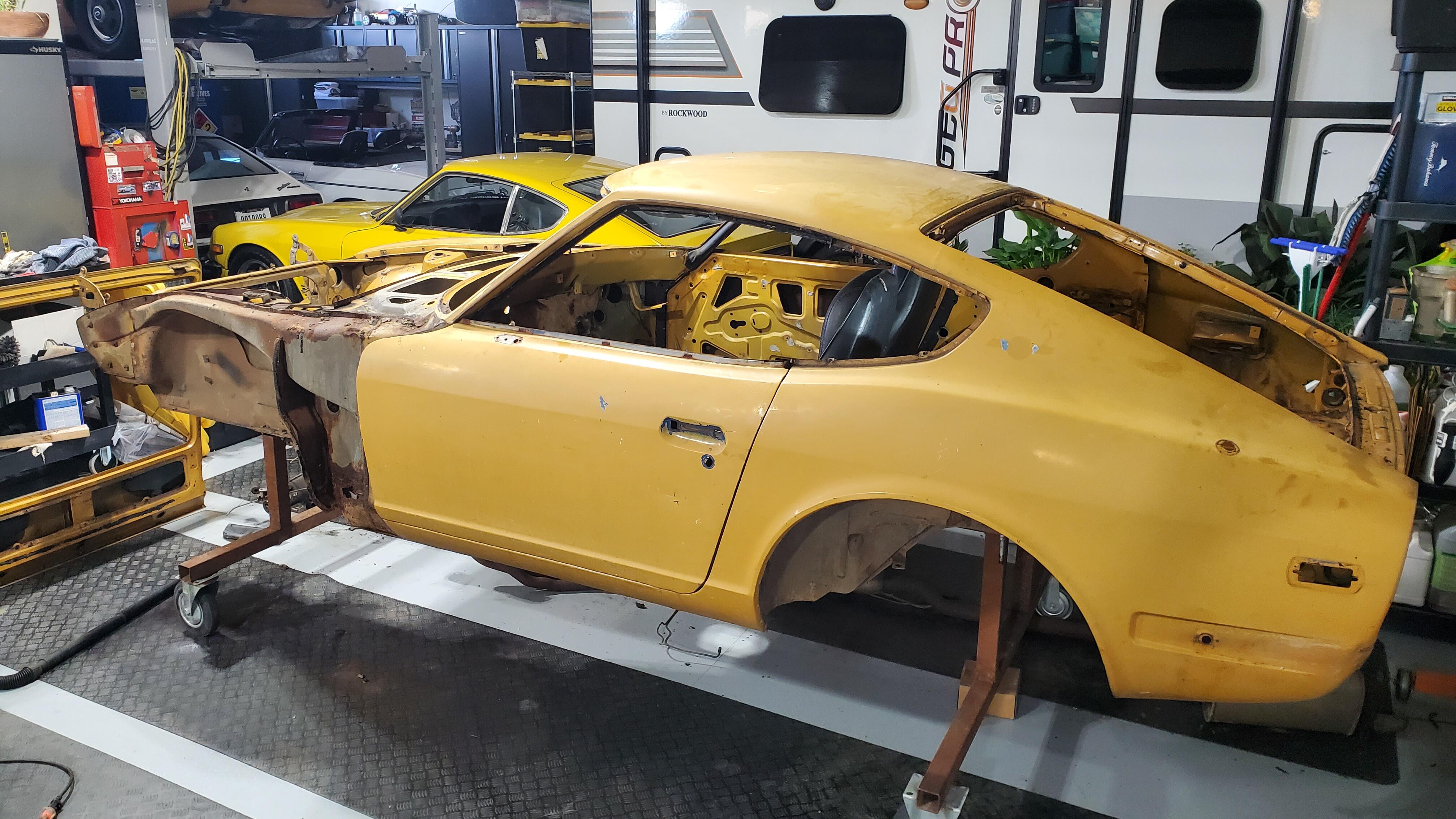

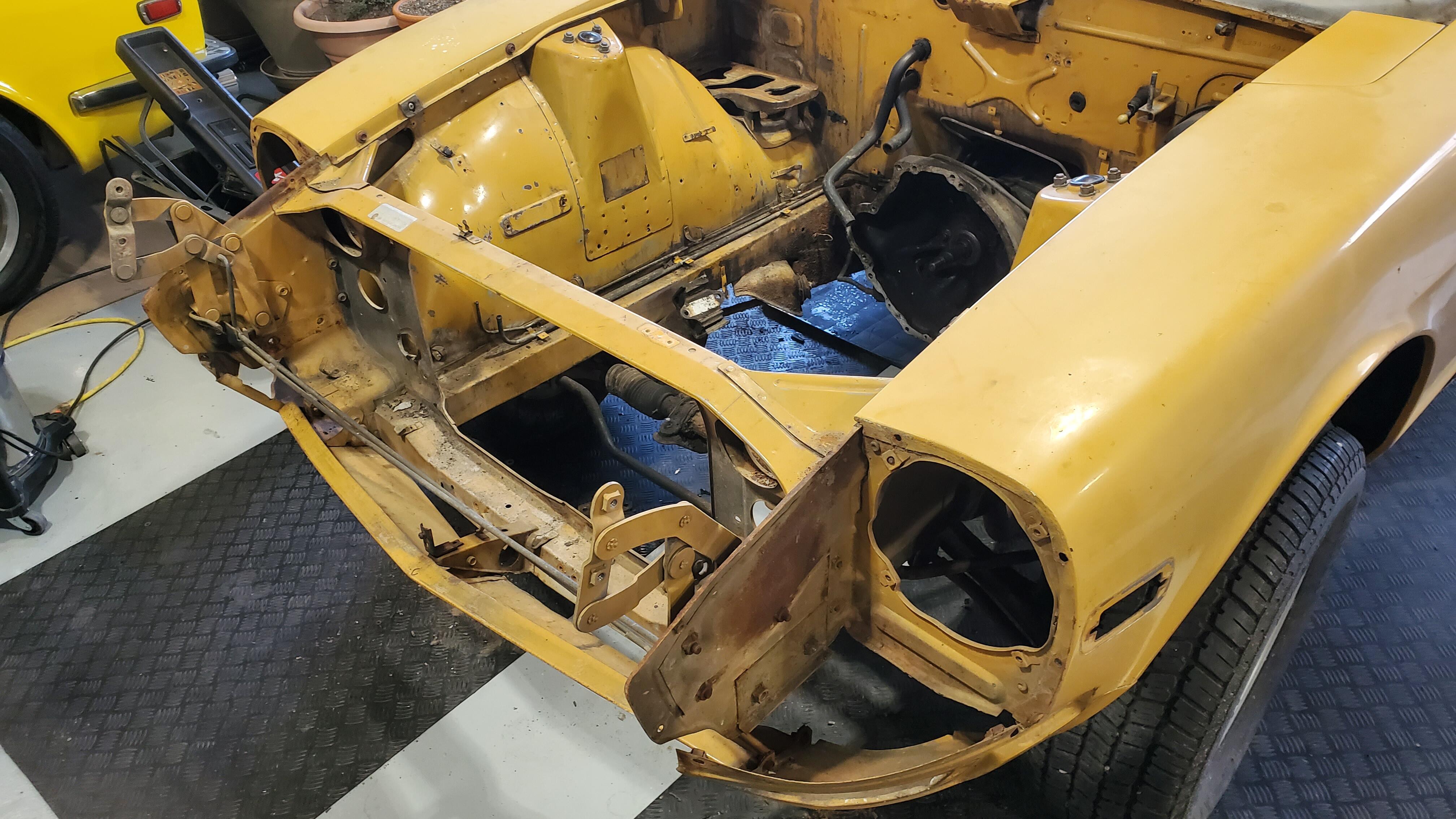

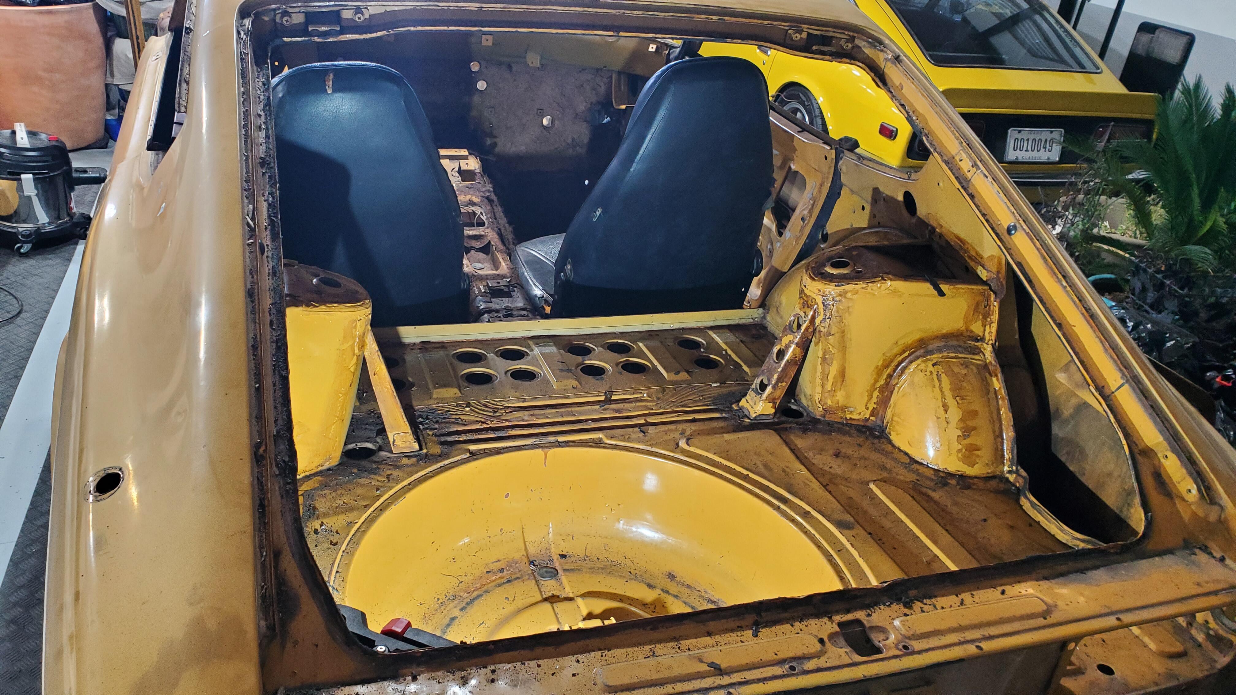

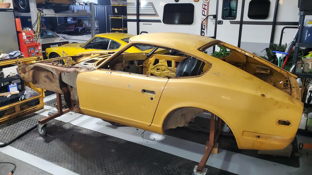

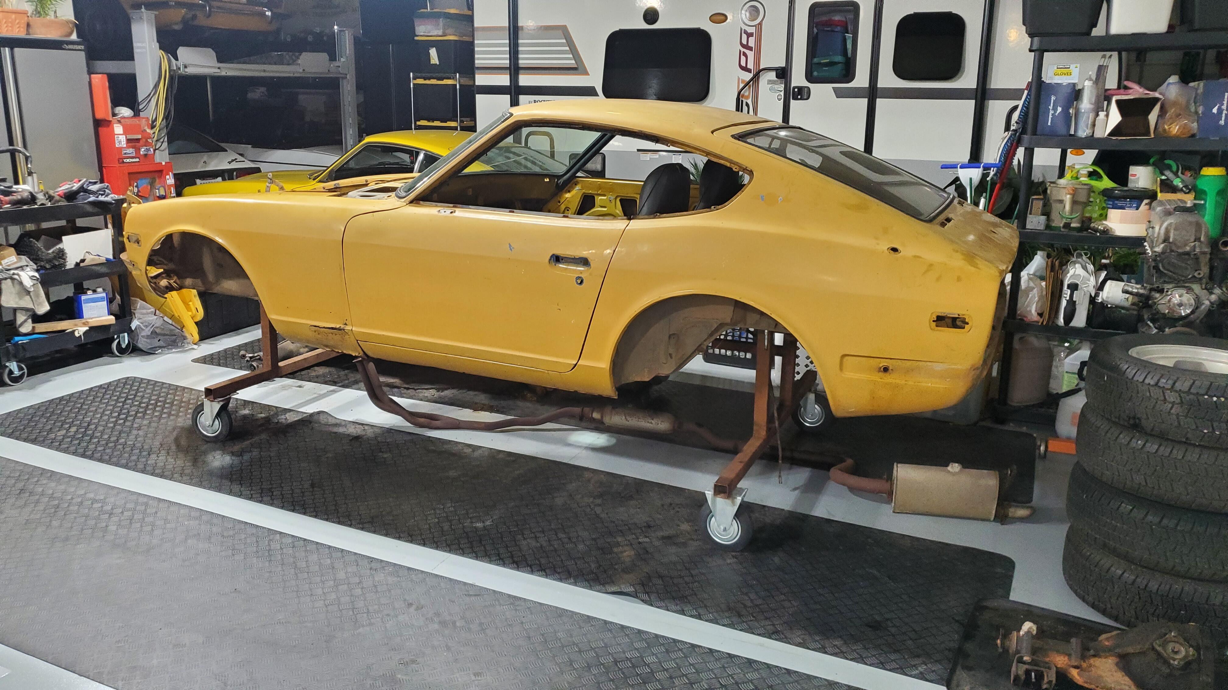

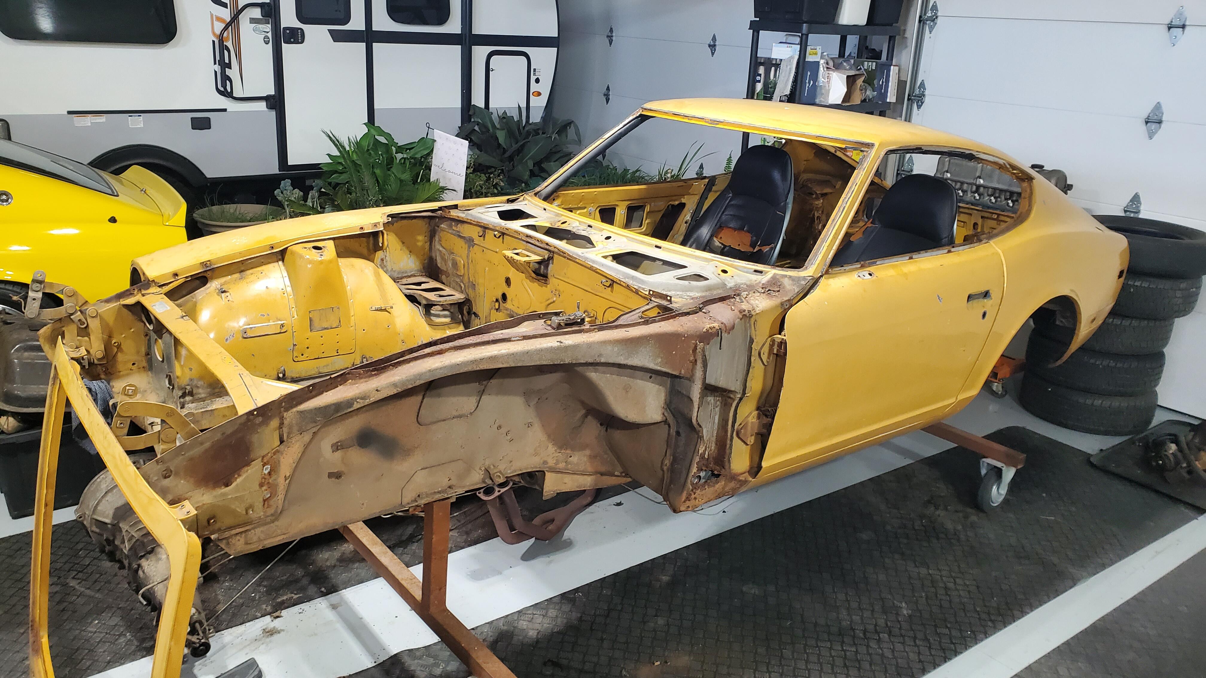

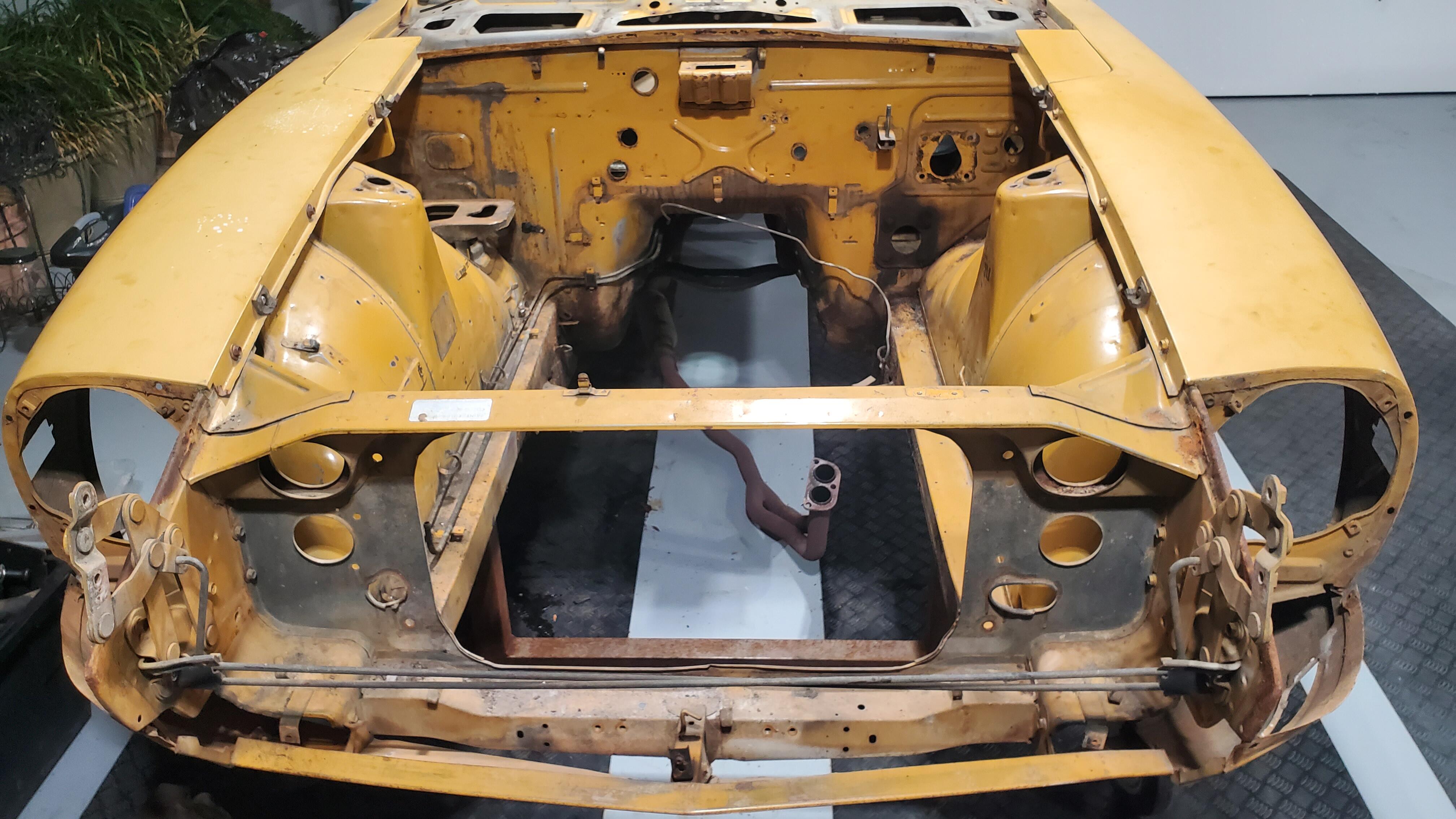

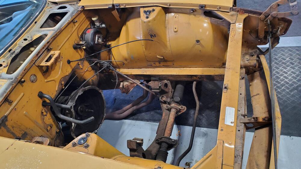

Got the body up on rollers.  This will make working on the underside much easier.  Should have the final items removed over the next couple days.  Pics are below.
The body is just about ready to send to the body shop. I removed the glass, all items on the underside, and all of the body panels.  I scraped off the old weather stripping and am now just doing final cleanup.  I still need to drill and tap a few of the rusted out bolts as well. I will make an assessment of which patch panels we will need so  shop can weld those in.
The nice surprise on the car was the good condition of some of the interior parts.  The headliner and A pillar vinyl is perfect as were all of the rear plastic panels, except for the rear panel which a PO had modified for speakers. Also, the doorsill plastic was in good shape and just needs to be cleaned.   This will make the interior much easier to restore as some of the aftermarket items for these items are not the best. Often, aftermarket panel holes don't align and I have had headliners where the manufacturer's glue is poor with the vinyl detaching from the foam in hot weather. So, having these items in good condition will be a nice help.
Latest photos are below.
