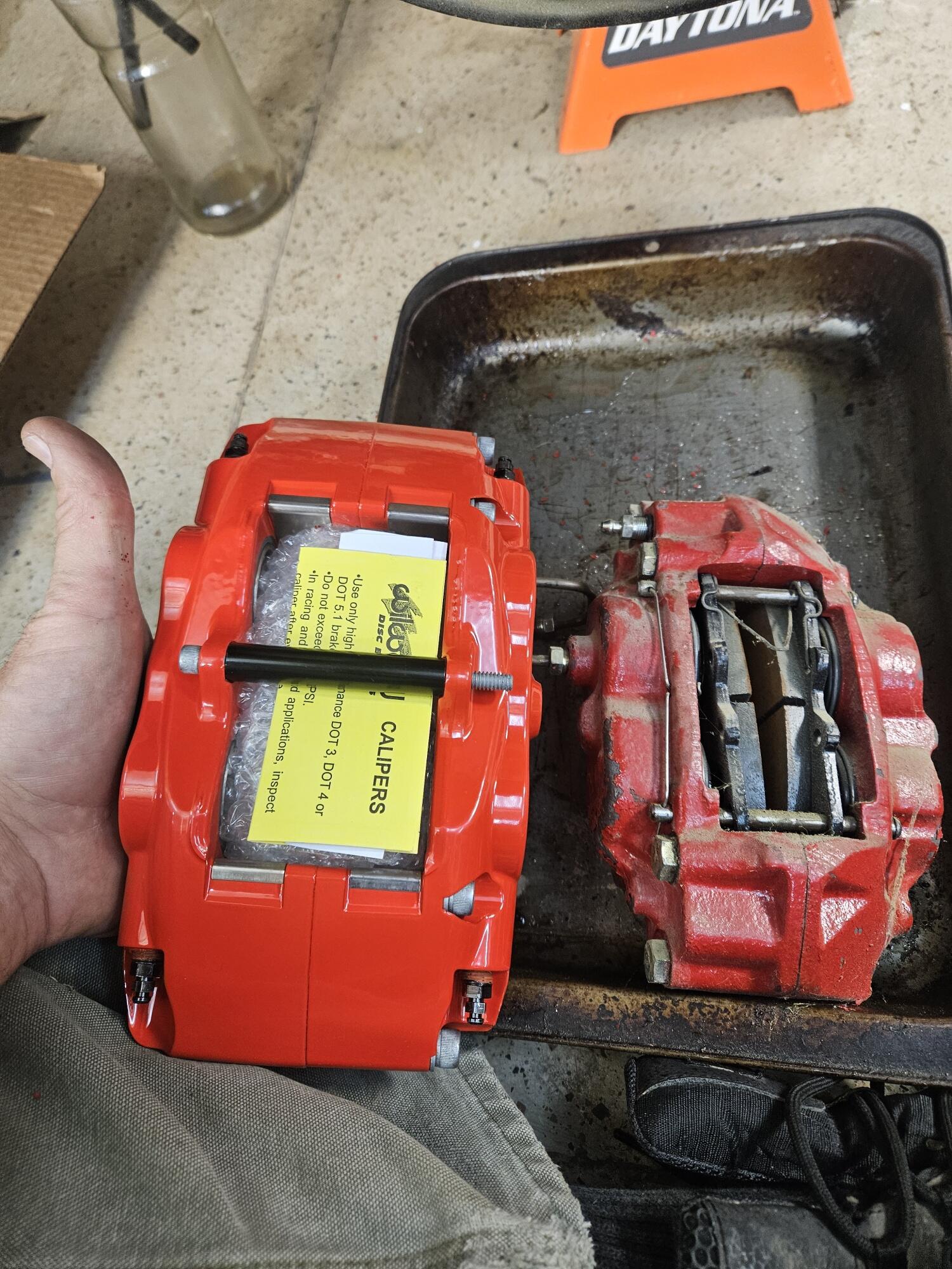

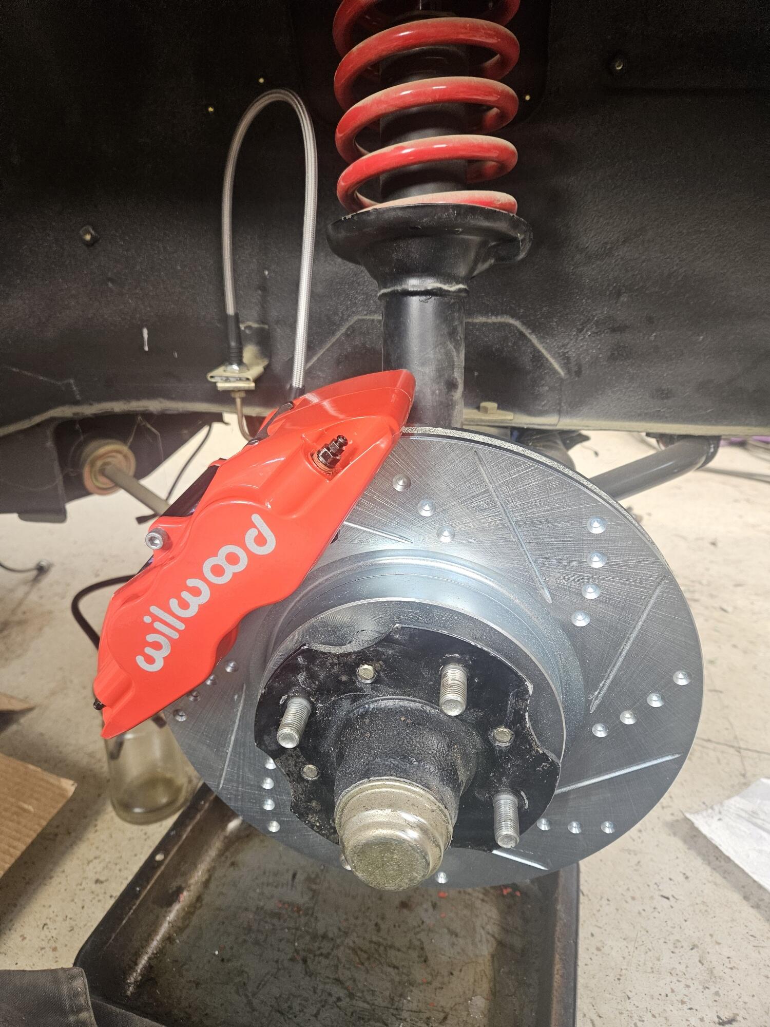

The new front calipers are very light. All aluminum. Here it is compared to the Toyota caliper

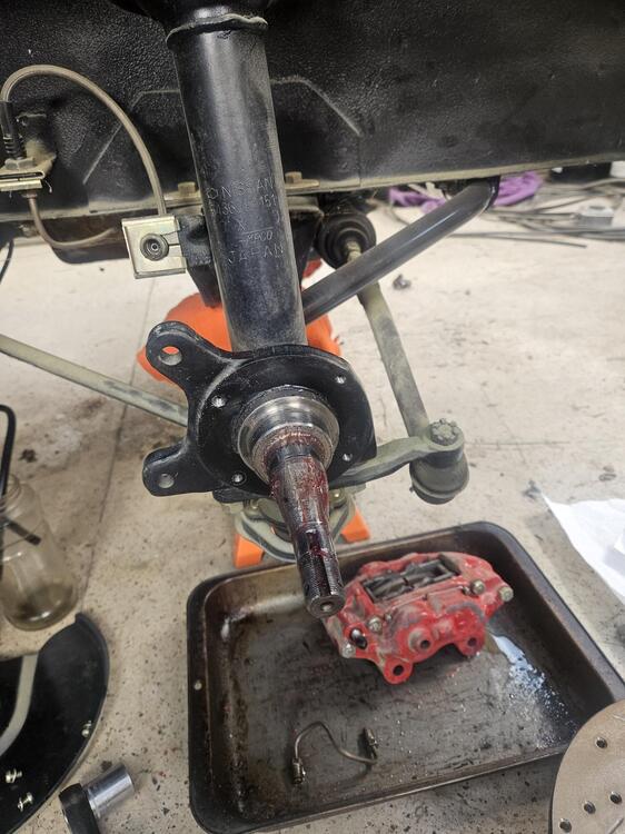

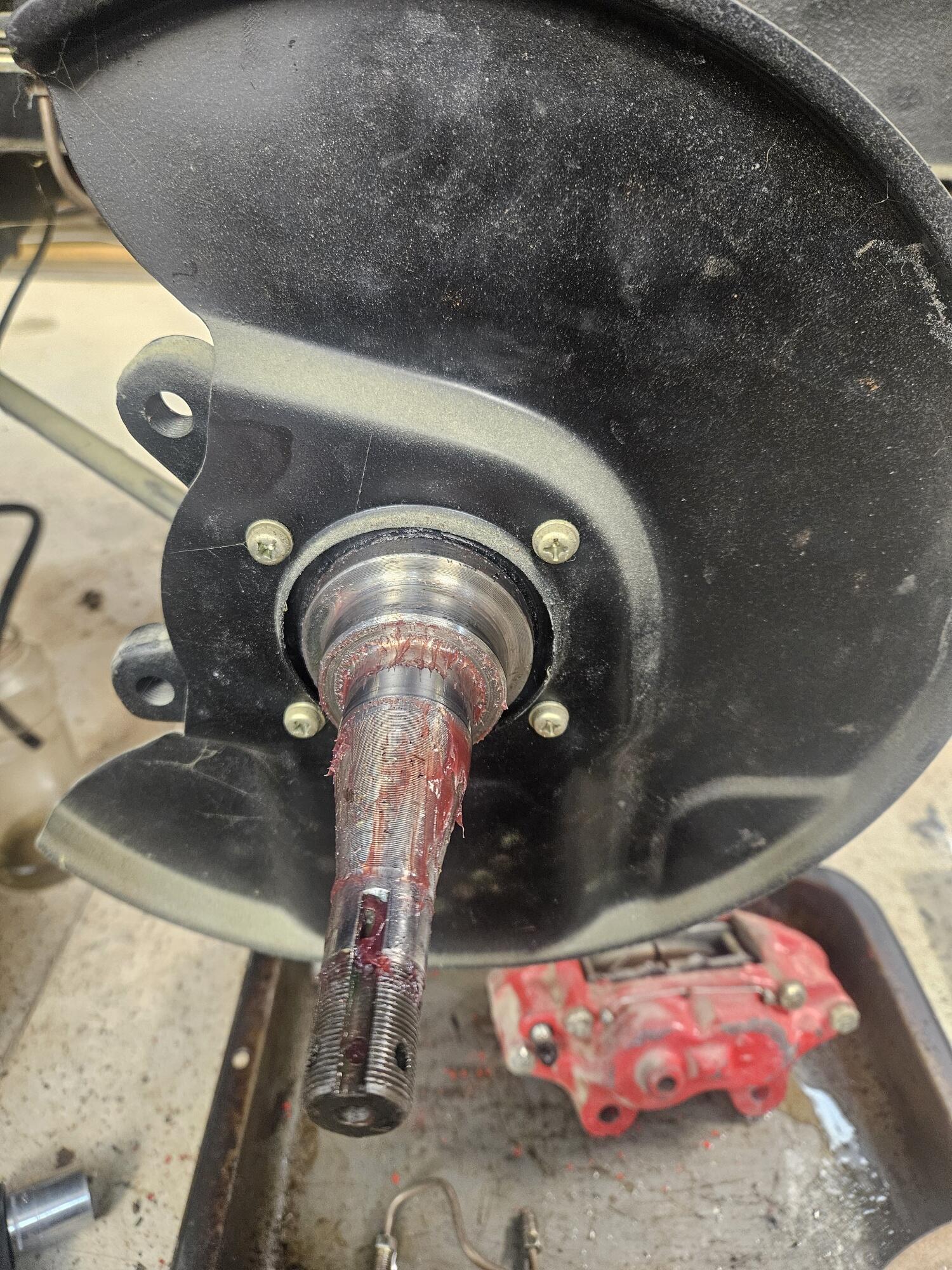

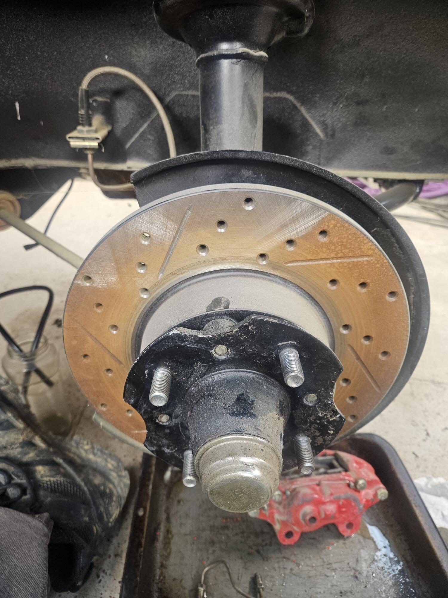

Here is the starting point for my front brakes. I did have the Toyota caliper on and the dust shields have been trimmed

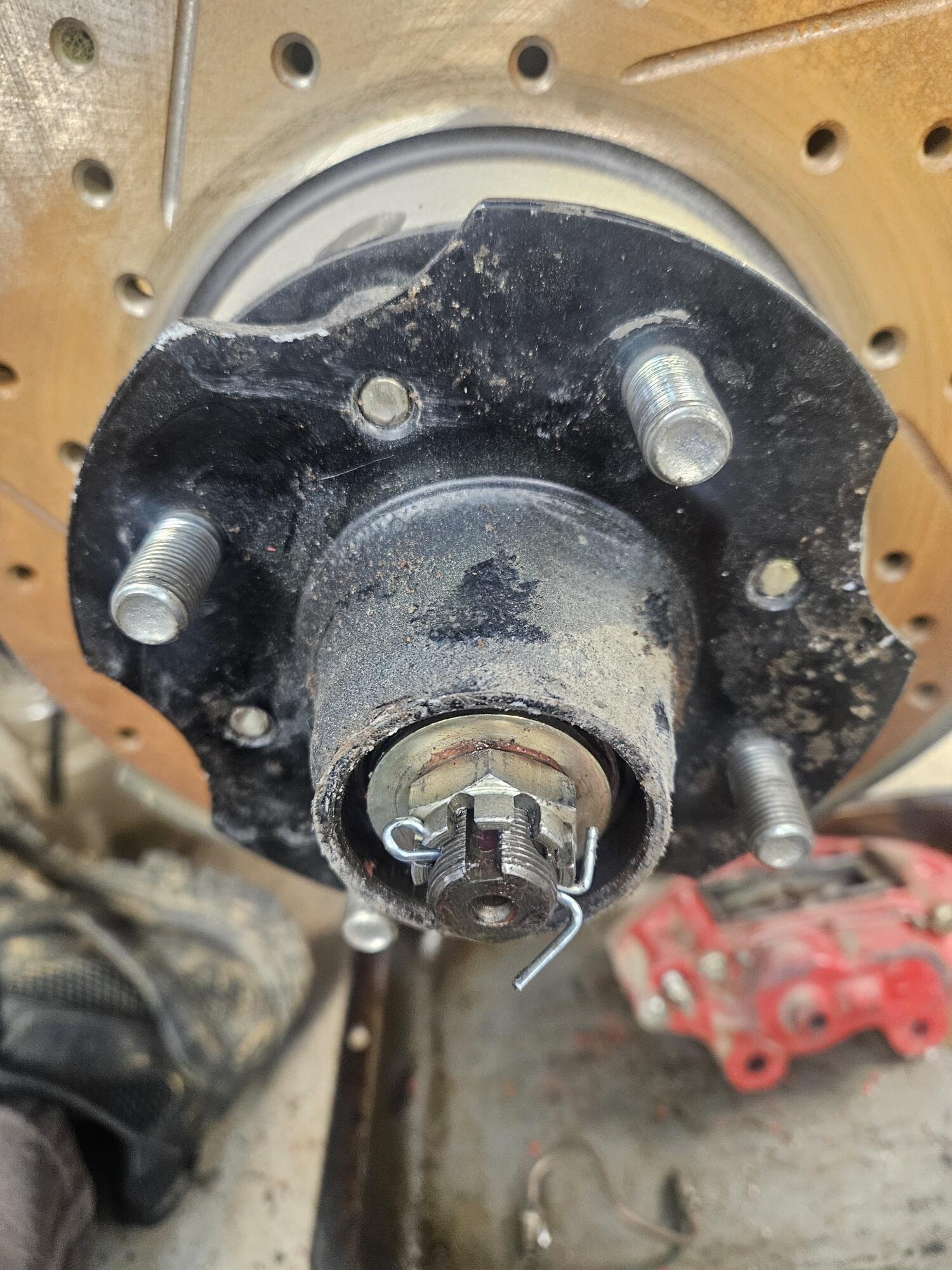

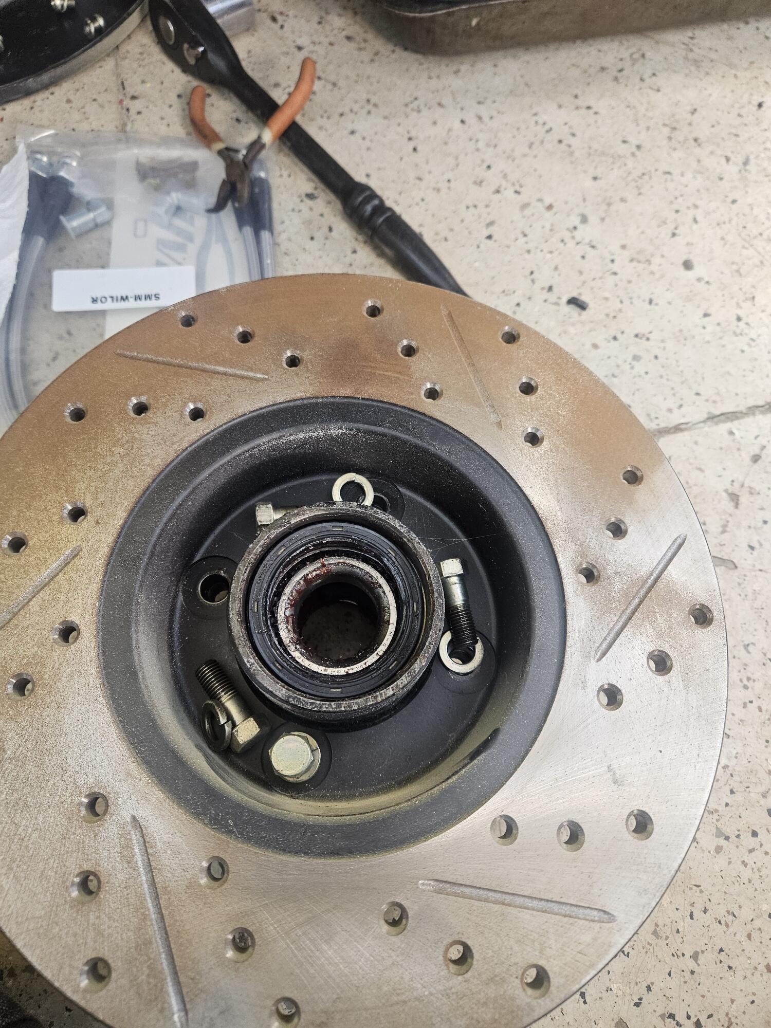

Hub has to come off
Then the dust shield needs to come off

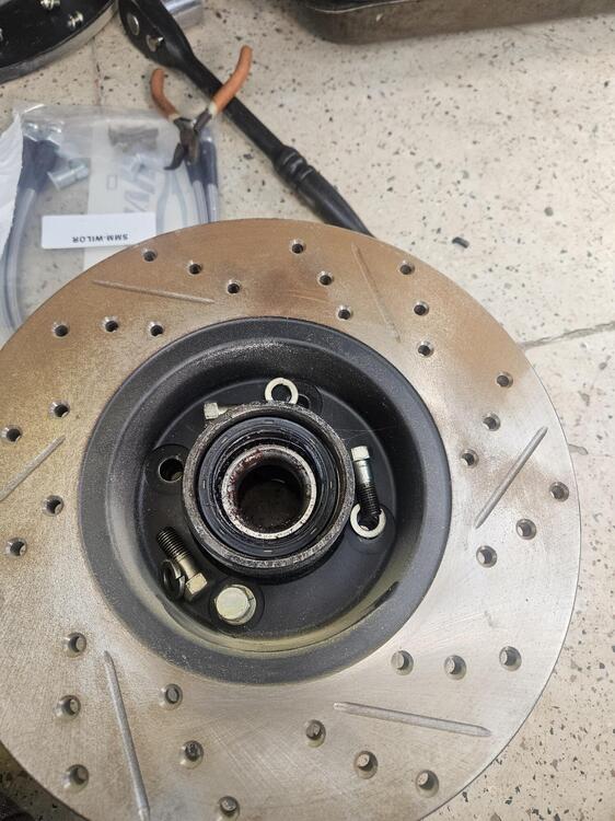

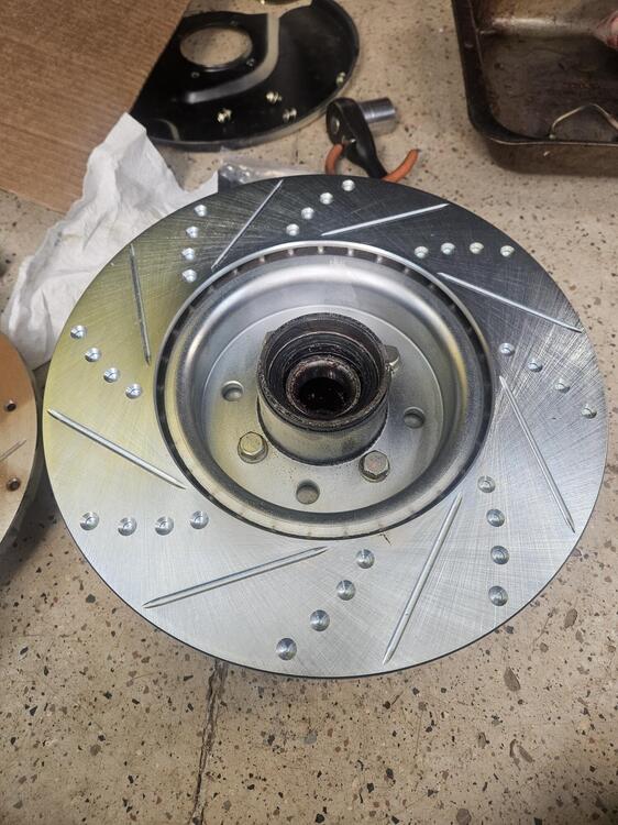

Then remove the bolts from the hub and swap rotors
A brass hammer might be helpful to get every thing lined up and seated

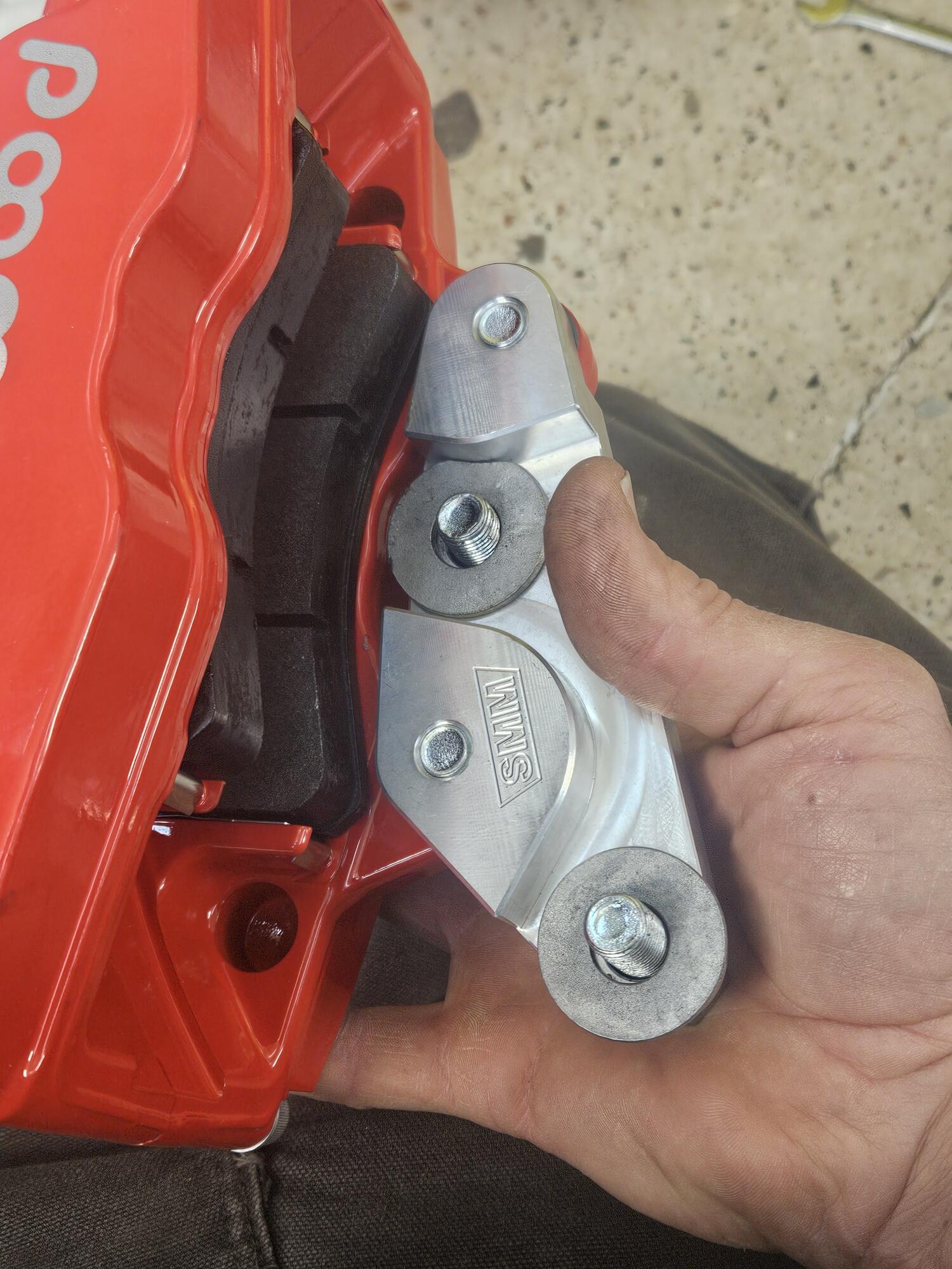

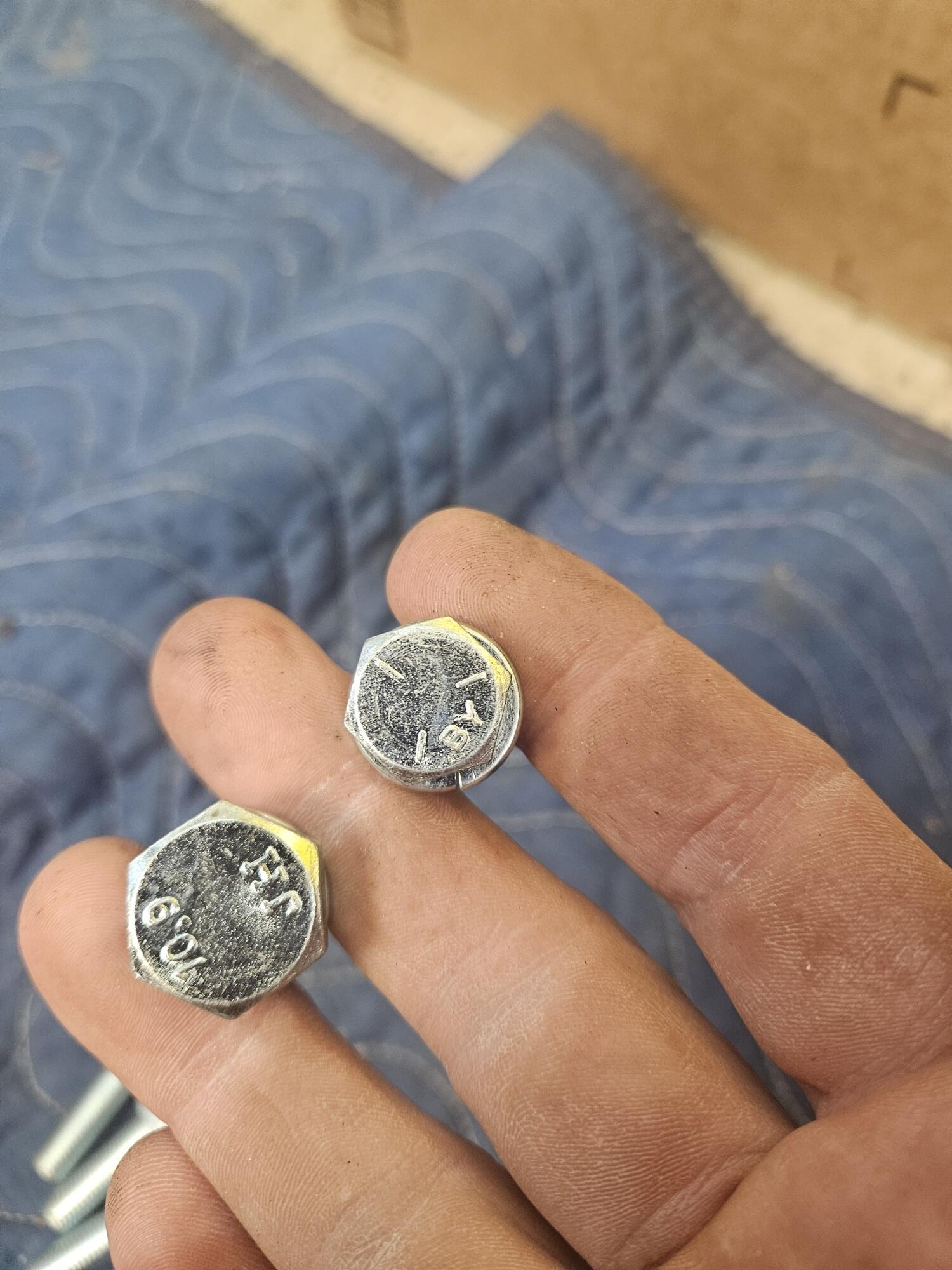

Everything on the Wilwoods seems to be SAE so there are two different bolts in the kit. The two metric bolts for bolting the adapter to the strut ears and the two SAE bolts for attaching the caliper to the adapter plate

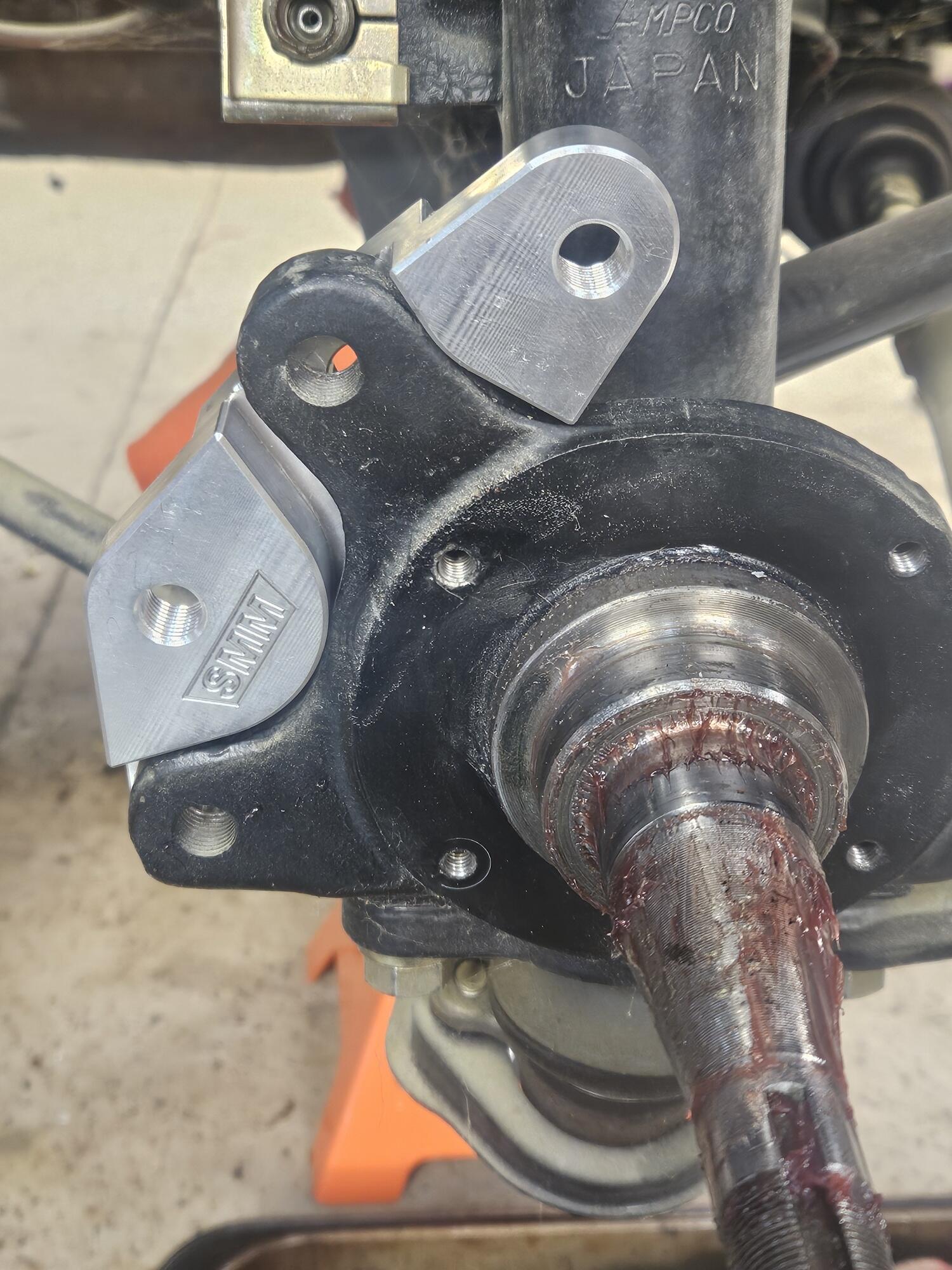

The Silvermine logo appears to face outward on these adapters

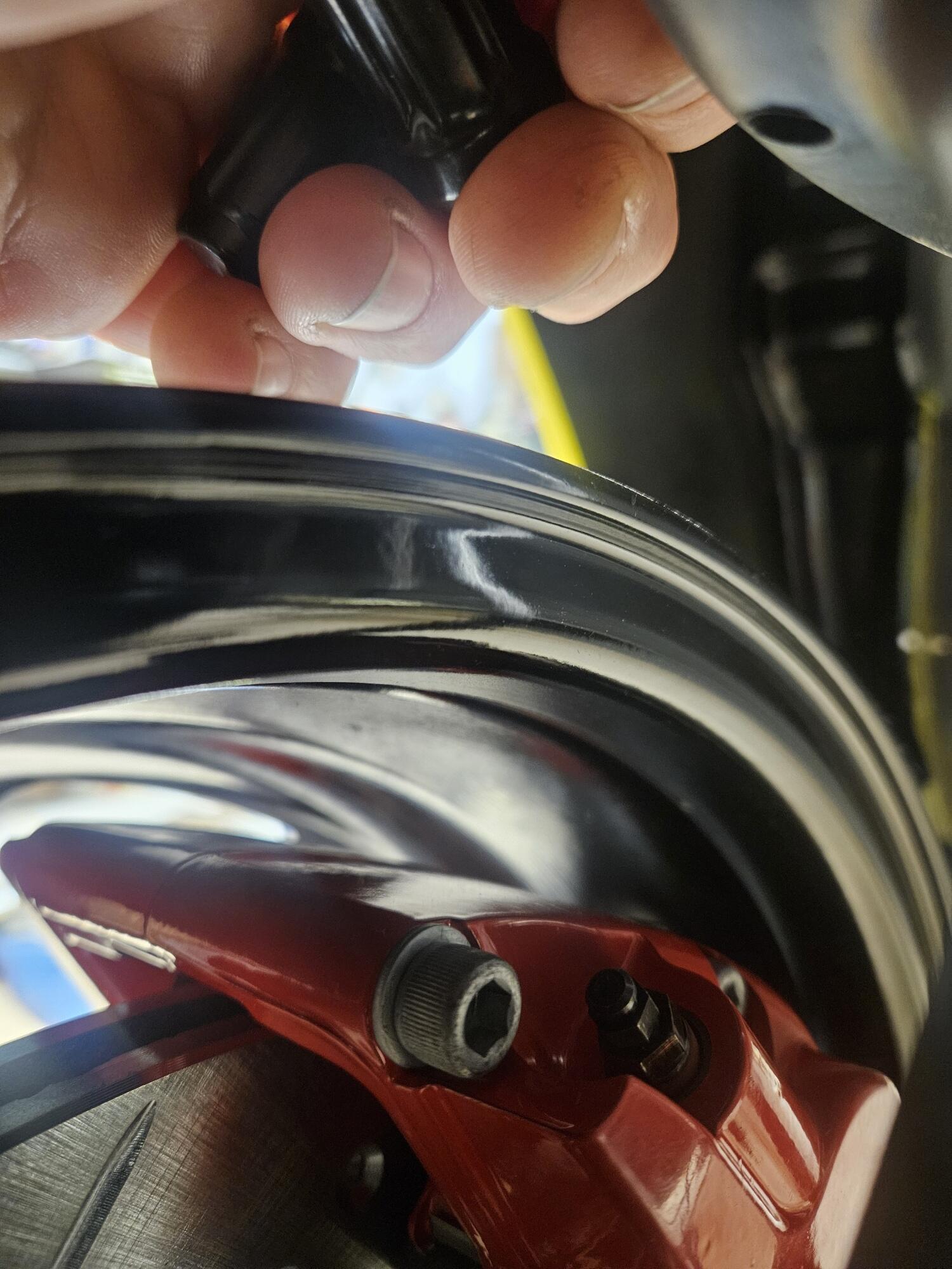

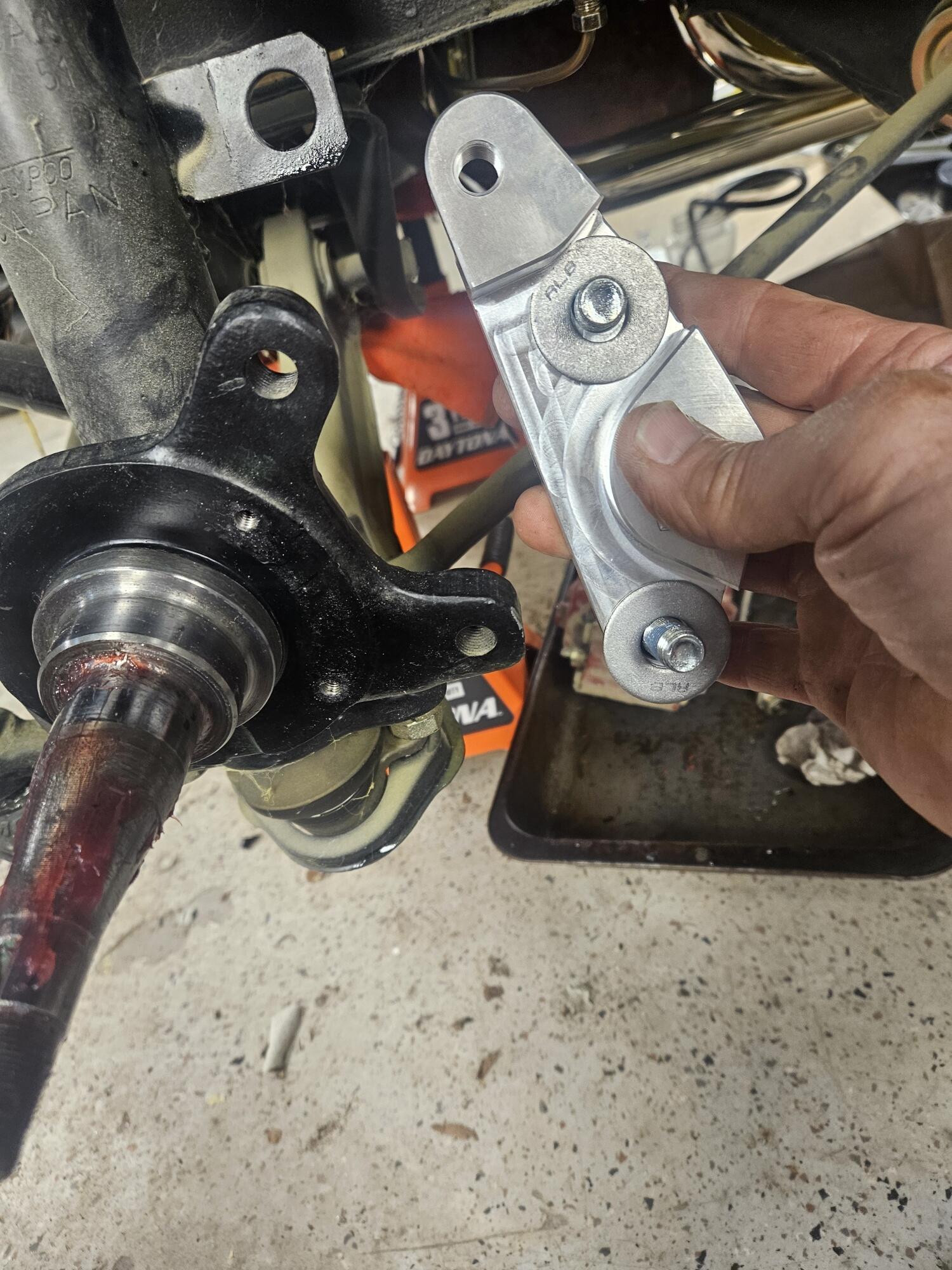

When I first bolted this side up, it bound up against the rotor. So I had to add some washers to space it back a little bit. The metric bolts have plenty of length so that wasn't an issue. I didn't have any pretty washers to use so I used these.
Also I had to trim the upper washer because the OD was too large to center over the hole
All together
It is easier to add the washers when installing the adapter if you know you'll need to
I guess you could install it with washers and you don't need them you can drop them out. It's a lot easier to drop them out than get them in and centered over the bolts.

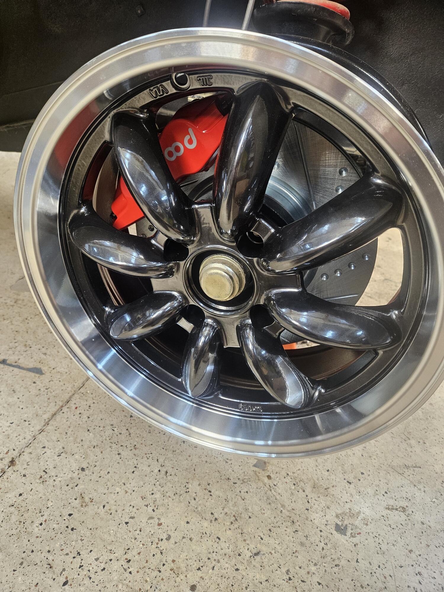

I’m thinking possibly going with the Panasport 16”+11 offset wheels from ZCarGarage. A bit pricey. Can you post some pics and the offset you are going with? Thanks
On 12/14/2024 at 2:02 PM, Mike said:
Hopefully your wheels clear it..  😉  Do you have a shot with the wheels on?
Sixteen inch Rota RB's +4
15" might actually clear. It'd be close
