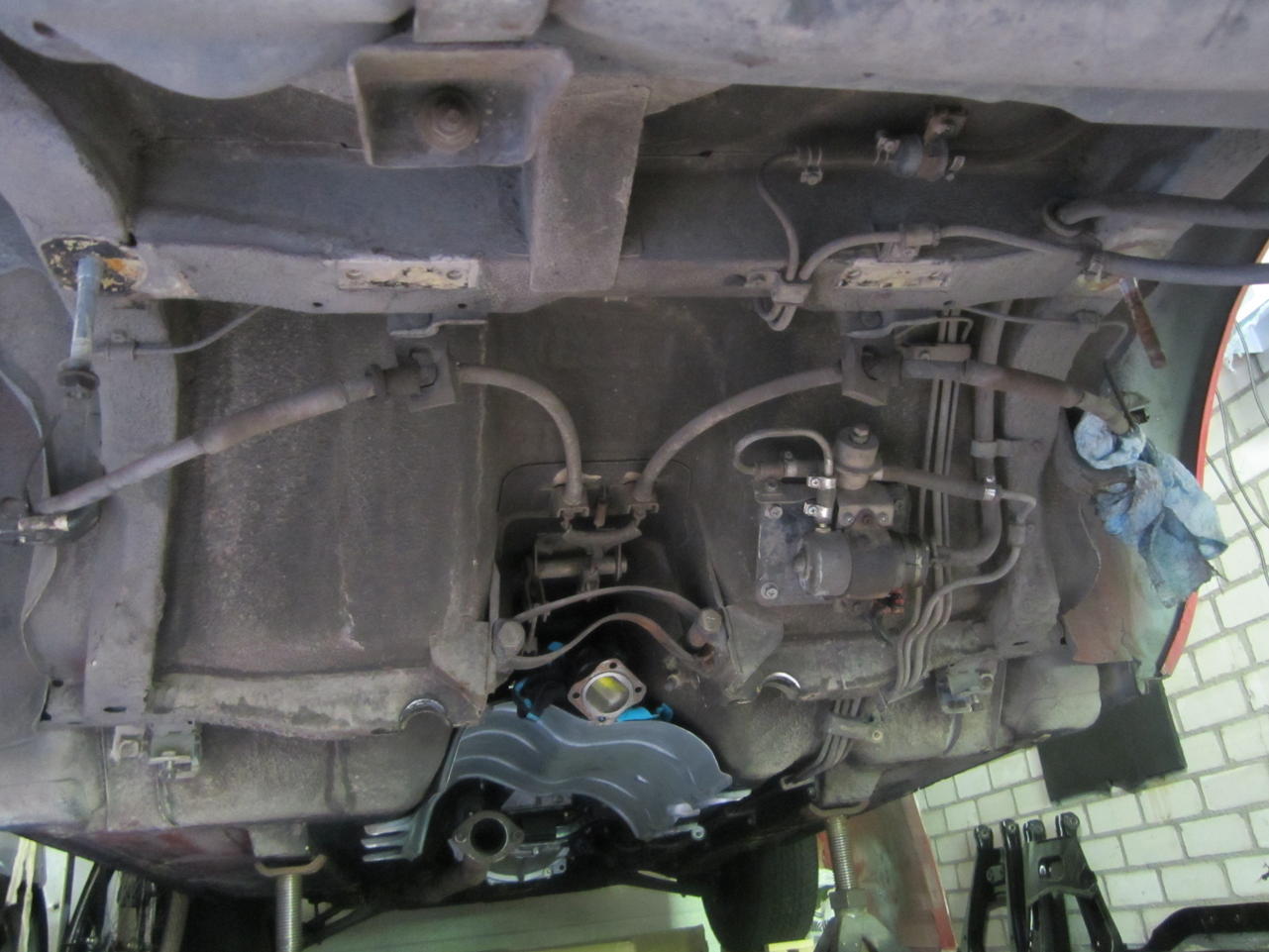

Could someone take a picture of how the hose that connects the tank to the fuel pump is routed on a 77/78?  Mine has always sort of hung under the car suspended over the half-shafts with various zip ties which isn't right.

Here's a pic I hoovered from the web some time ago. Not my car:
Thanks! This is interesting and I'll tell you why.  The car ran horribly after I replaced the old tank-to-pump hose (due to age) and I eventually found that I had 20psi coming out of the fuel pump due to me zip tying the tank-to-pump hose higher than where it had been before being changed.  After lowering the hose (to a couple inches over the half shaft where it had been i believe) I saw my psi go up to 32.
The car used to run great before I replaced the hose so I must not be hanging it right as it idled at 36psi.  Long story short, I don't understand how these pumps are able to spit out 36psi when routed that high compared to how I had it.
Edited by chaseincats
