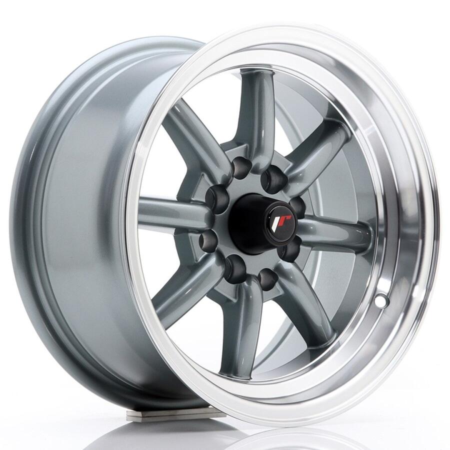

Posted March 24Mar 24 comment_675412 Hello guys, My 240z has had Fenton mag wheels for about as long as i have the z. They are vintage i had them restored but they where never really wobble free in the steering wheel. Im tired of it and i want a new set. I believe my current et is about -10 or -12 6J.New wheels in 14 inch are for some reason very hard to find. If anyone has links or tips for wheels let me know.I found these here in the Netherlands, but how does that fit? My tires are just new 195/70/14 so i want to put them on my new wheels. https://www.rrwheels.nl/Webshop/Velgen/JR-Wheels-JR19-14x7-ET0-4x100-4x114-3-Gun-Metal-Machined-Lip-JR19147040073GML?_gl=1*1lnpsoo*_up*MQ..*_gs*MQ..&gclid=Cj0KCQjwhYS_BhD2ARIsAJTMMQYjrdrV1uoWUoH-JPr48noPlqm8ACaUM83a714piBIyVVkLIDfB_04aAqfUEALw_wcB Link to comment https://www.classiczcars.com/forums/topic/69306-14-inch-aluminium-for-stock-240z/ Share on other sites More sharing options...
March 24Mar 24 Author comment_675413 I feel like 7j could be to wide? Not sure if et of 0 will work with stock 240z. Any tips or advice appreciated. I need something that can drive trouble free on the stock suspension without rubbing the fenders in corners, bumps or with a passenger Link to comment https://www.classiczcars.com/forums/topic/69306-14-inch-aluminium-for-stock-240z/#findComment-675413 Share on other sites More sharing options...

March 25Mar 25 Author comment_675421 Dutch reaction from the shop:You need a lathe on the wheel to make it fit the hub..so that's not good Link to comment https://www.classiczcars.com/forums/topic/69306-14-inch-aluminium-for-stock-240z/#findComment-675421 Share on other sites More sharing options...
March 25Mar 25 comment_675425 If you want to go 14" wheels (most people are doing 15" or 16" now):MSA Has the Konig Rewind, which is a 15" thoughVTO Wheels has a 14" Classic 8.Do a search on the website for either wheel or check out our wheels/tires thread.Mike Link to comment https://www.classiczcars.com/forums/topic/69306-14-inch-aluminium-for-stock-240z/#findComment-675425 Share on other sites More sharing options...
March 27Mar 27 Author comment_675439 yeah i like to keep 14 inchWheels | VTO WheelsI saw they have 34mm postive offset, what ET is this ? I need it to fit with stock suspension not rubbing the arches.. Link to comment https://www.classiczcars.com/forums/topic/69306-14-inch-aluminium-for-stock-240z/#findComment-675439 Share on other sites More sharing options...
