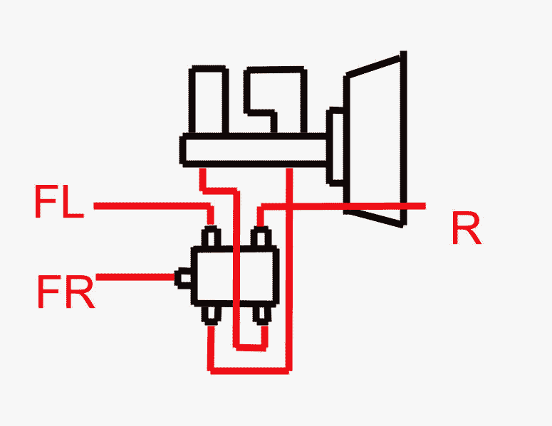

Hi, thanks for your replies,
I didn't know how the break balancer was supposed to be hooked up (I bought the car with every thing already pulled apart) so is this correct (see attached picture)
I've got a air compressor break bleeder I can try, if that doesn't work I will pull it all apart again and see if there is anything obvious.
