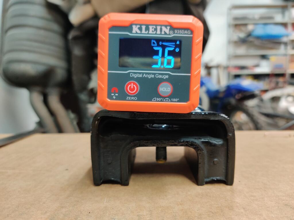

13 hours ago13 hr Author comment_675798 I bought one of these Magnetic Bore Laser Sight to help with alignment of the transmission to the differential. Still pondering on the options for how best to solve my issue. Edited 13 hours ago13 hr by inline6 Link to comment https://www.classiczcars.com/forums/topic/69334-how-vibration-free-is-your-70-71-240z/?&page=2#findComment-675798 Share on other sites More sharing options...

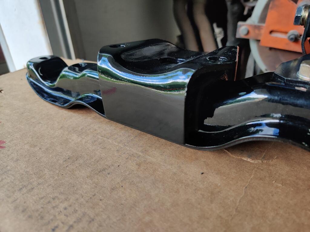

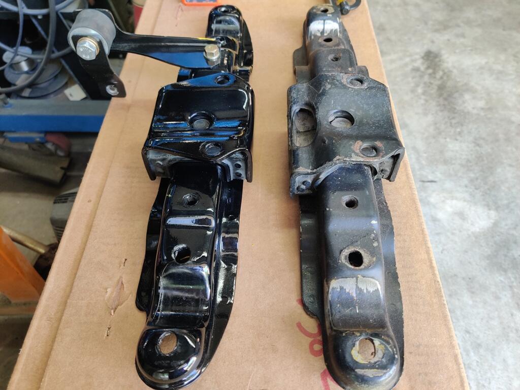

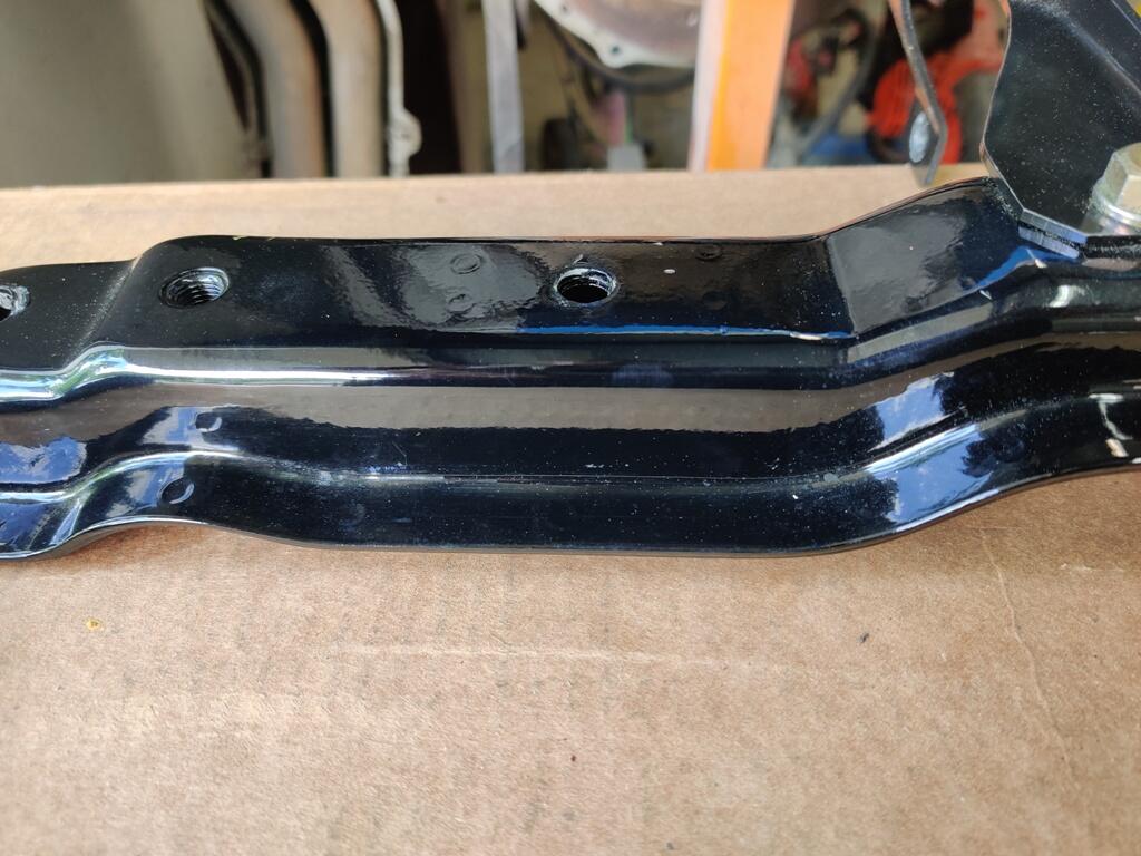

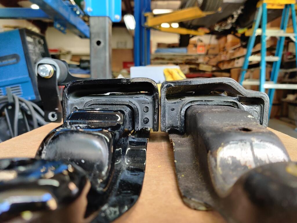

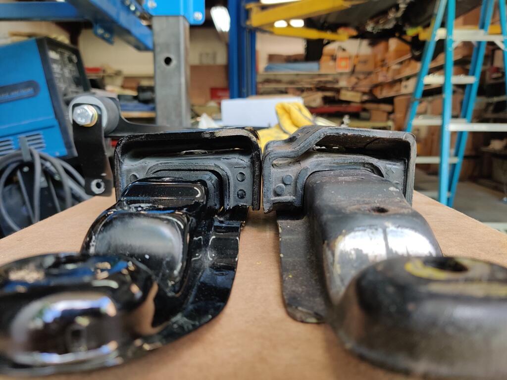

13 hours ago13 hr comment_675800 22 hours ago, inline6 said:I backed off the bolts securing the transmission mount (Techno Toys Tuning) to the body to see what kind of change in angle would result. Picture of the mount I have (for use with the 240SX transmission) in the early Z:Do you have a Nissan factory transmission mount to try? Maybe you're fcoused on the wrong member. The T3 mount is the only "non-factory" part. Link to comment https://www.classiczcars.com/forums/topic/69334-how-vibration-free-is-your-70-71-240z/?&page=2#findComment-675800 Share on other sites More sharing options...
13 hours ago13 hr Author comment_675801 Good thought. I do. I will have a look at it to compare. Link to comment https://www.classiczcars.com/forums/topic/69334-how-vibration-free-is-your-70-71-240z/?&page=2#findComment-675801 Share on other sites More sharing options...
