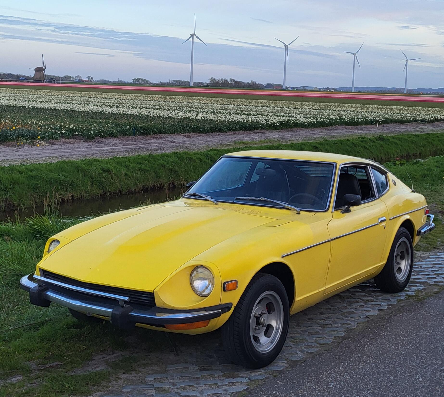

i also put a photo of my car here. This was how i got it. the paint is awful on it. on the photo it looks good but it has been dan with a paint brush. so you can imagine how it looks. i will bring it to the paintshop and make it the factory green again. because on the fire wall in th engine bay you can also see that is was green before. I just love that color.
