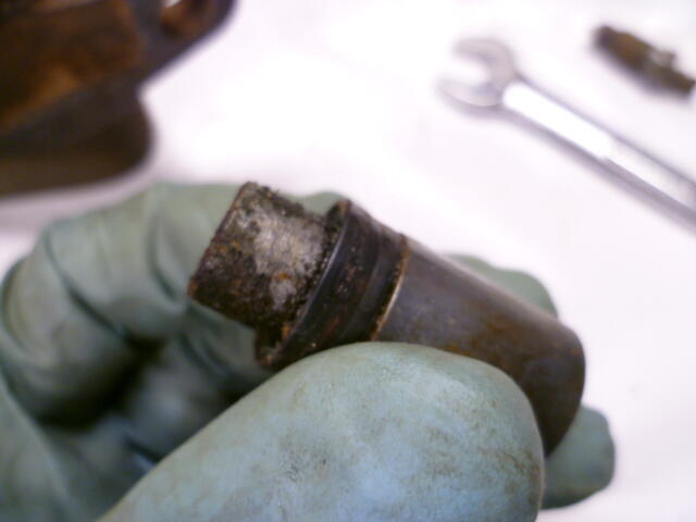

So I took my Z out of hibernation yesterday after 4+ months. Started up checked everything, car drove fine (so I thought), stopped at store, went about 200 yards, and lost clutch pedal, almost all the way to the floor. Pulled over and checked master cylinder bowl, it was full, but black (was clean last fall). Turned engine off, went right into gear, started up car took off, headed home (2 miles). Good until dam stop lights, shut engine off 2 more times, till I made it home.
Pulled master cylinder, found it stuck, (original to the car). Ordered a new one (OEM Nabco).
