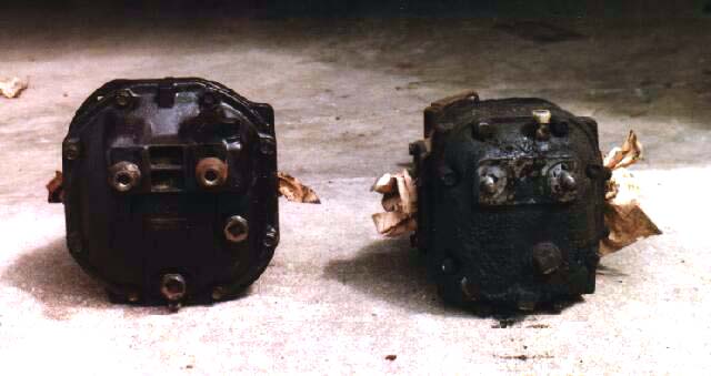

Also, how do you tell the difference between a R180 and a R200 by looking at the rear face plate???? Mine clunks a bit, wonder what is causing that?

That's good advice on checking out the clonks from the rear, however if its not too pronounced then it might well be a symptom of the R180 diff design itself. Even when new, these cars suffered from the dreaded clonk ( magazine road testers remarked on it ) and this was pretty much down to the design of the R180 and the amount of time that it would take to set up the backlash properly for each unit. The Factory attempted to improve this situation by matching sized components of the diff as much as possible, but basically blueprinting each individual diff would have been too costly time-wise. Some R180 diffs are noisier than others, but they all seem to suffer from a rather complicated design wityh multiple shims under the side covers. The R200 is much easier to set up and has an inherently better design - so they are usually much quieter.

I agree about the clonky R180 diff situation being worse in the S30-series Z cars than in almost anything else they were installed in. It really must be a case of the semi-trailing type of rear suspension on the other models masking the shortcomings of the R180 design. Interestingly, I've noticed that the higher numerical gear you go for in the R180 the more clonky they are. I used to run a 4.875 LSD-equipped R180 for a short while and that was really noisy. My diff rebuilding specialist told me that this would be because the pinion gear was so small and it had so few gear teeth on it. He asked me not to bring any more R180's to him for rebuild, but he doesn't mind doing R200's...............:cross-eye
