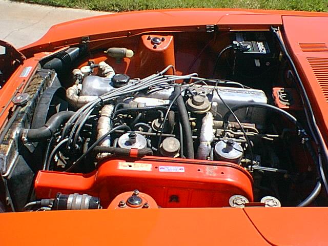

Just picked this car up from some moron in southern BC. Can you guys help me figure out what these lines are, and what I can just shave off? It's such a mess.
My 260Z Gallery with Labelled Pictures
I found this engine which belows to a member on this site. I labelled some hoses... The setup looks simplistic and functional.... Can you help answer my questions?
Thanks so much.
I really want to get this running so I can start the bodywork and interior restoration.

What I see is someone has made a very good compromise to keep all the vapor control items operating without the stock air cleaner.
A. (Same as "E") crankcase ventilation line in it's stock configuration.
B. Brake booster Vacuum supply line
C. the fuel bowl vents were originally connected to the air cleaner. There's nothing wrong with the way this has been modified, UNLESS the vents are exposed to too much vacuum, witch will lean out the mix.
D. That was connected to the air cleaner to supply a slight vacuum to the vapor system. Hopefully, it's now connected to the new air cleaner and NOT to a vacuum tap on a carb or manifold. The system only needs a slight negative pressure.

Victor, You get an AAAAAAAAA+++++++++. Thanks for the compliments on the car. Any suggestions on what would work better. Thanks Goose, yes to the crankcase Straight through no other connections. I suggest you get rid of the flat top carbs and go with round top, also get rid of all the hoses and smog stuff like you see on mine. What you see is the after..I did that to mine. Here is the before pic......................
I think they are asbestos. I removed the wrappings today to install a fuel filter and new hoses. Now I feel cancerous ;)
Thanks again for the help guys. I removed a lot of hoses and stuck on some rubber plugs from NAPA. Tommorow i'll pick upa few more and some more hose to replace the old fabric stuff.
