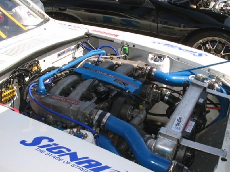

Gav240z: Yeah they're single turbo. What you've probably seen was a VG30DET, the single turbo version of the VG from the Z31 300ZX.
The VQ's are far smaller and alot lighter than the VG. Make the same power and more torque than a VG30DETT in standard form too.

Apparently, being an alloy block (not as stiff) they aren't capable of as much power as the VG........but seriously, I'm never gonna be pushing the motor to that level.
The japs seem to comfortanly and reliably pull 550+HP for the VQ's.
