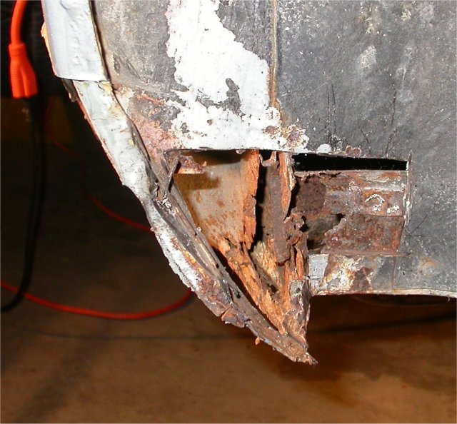

Well, a few weeks ago I removed 2/3 of the left Rocker for replacement, and I was vacillating about cutting out the lower rear quarter to get to the back end of the rocker. The quarter panel had been replaced 12 years ago and still seemed to be in good shape. I think it was Escanlon that suggested I might consider what things looked like under the quarter, and tonight I did. Poke, prod, cut, chisel, and in the end, it looks like this. Yikes! At least I'll be able to replace the entire rocker intact, and then the lower quarter dogleg. Thorough cleaning out, POR-15ing, and maybe I'll never have to do it again. Hopefully.

Hole-y Sh*t, Batman! Good thing you opened it up Mark.

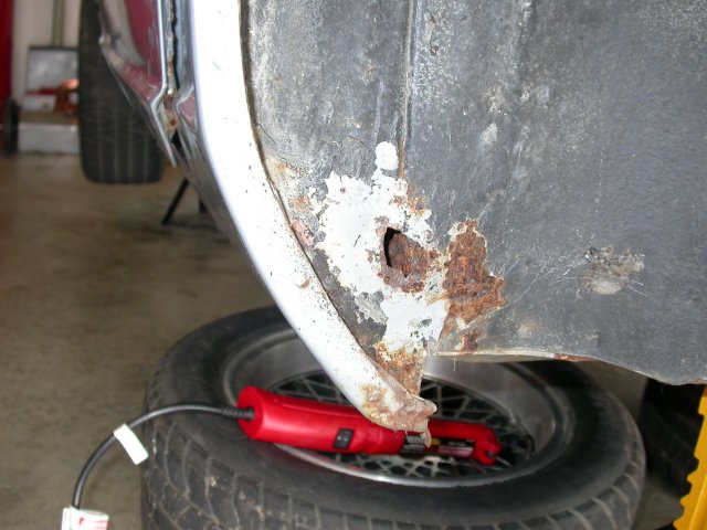

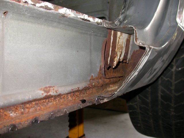

Not much. I had some indications, however. Here is a pic of the rear of the rocker before I started hacking on the quarter panel. Note that the outside of the quarter looks pretty good. The end of the rocker inside it is rusty, but reasonably intact. However, see the next two pics...
Here is the wheel well behind that portion of the rocker before work started. Hole doesn't look too bad, right?

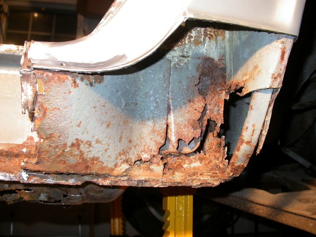

Until you start making it "bigger". Abrasive cutting wheels make quick work of removing metal :devious: .
I know it's no consolation, but your pics could be the ones I should have taken of my car.... mine was rusted just as bad and in the same exact spot. I noticed the bondo in the dog leg when I bought the car, but didn't realized it had rusted the inner fender panel out like it did.... I ended up having to buy a whole inner fender panel just so I could cut out the patch panel at the bottom where the dog leg wrapped around it so it could be welded back like it was, damned hard to fabricate that piece with the compound curve and lip for the dog leg to weld into the fenderwell.... Mine was rusted out on the outer side even worse than yours. Looked the same under the dog leg too.....:disappoin

I don't think I'll be that lucky. The quarter is just as good on the passenger side, but the Rocker is even worse in front on that side, and I expect to see the same stuff under the rear quarter. There's even a little hole in the wheel well on the passenger side in about the same place as the drivers side. Not quite as big, though, but it doesn't take much to let the water in. Oh well, by the time I get to it, I'll have a lot more experience, right? :ermm::cry:
