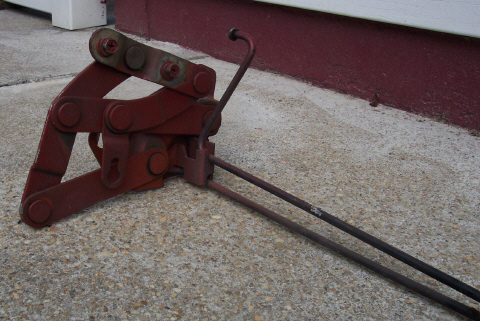

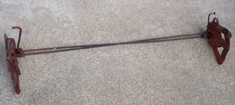

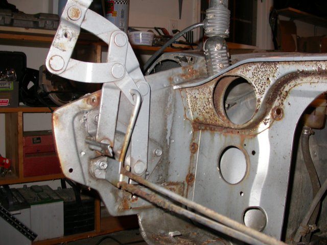

Posted August 6, 200321 yr comment_46318 Does anyone have a picture of their hood spring and tension bar.I am trying to put them together and I dont remember how it came out nor do I have a good diagram to follow. If anyone can help me out that would be great. Been working on this for two days.Mark Link to comment https://www.classiczcars.com/forums/topic/7383-hood-springs/ Share on other sites More sharing options...
August 6, 200321 yr comment_46324 See if these help... Link to comment https://www.classiczcars.com/forums/topic/7383-hood-springs/#findComment-46324 Share on other sites More sharing options...
August 6, 200321 yr comment_46325 Passengers side... Link to comment https://www.classiczcars.com/forums/topic/7383-hood-springs/#findComment-46325 Share on other sites More sharing options...
August 6, 200321 yr comment_46351 Pics of ones still on the car: Left Side: Link to comment https://www.classiczcars.com/forums/topic/7383-hood-springs/#findComment-46351 Share on other sites More sharing options...
August 6, 200321 yr comment_46352 And the right side: Link to comment https://www.classiczcars.com/forums/topic/7383-hood-springs/#findComment-46352 Share on other sites More sharing options...
August 6, 200321 yr Author comment_46357 mdbrandy ,Perfect. Thank you very much. This will really help me out.Mark Link to comment https://www.classiczcars.com/forums/topic/7383-hood-springs/#findComment-46357 Share on other sites More sharing options...
August 6, 200321 yr comment_46359 I've got about 10 more pics of the hinges and springs (I was worried about gettting them back together too!), but I thought these were the best. Let me know if you think you need any other angles. Link to comment https://www.classiczcars.com/forums/topic/7383-hood-springs/#findComment-46359 Share on other sites More sharing options...
