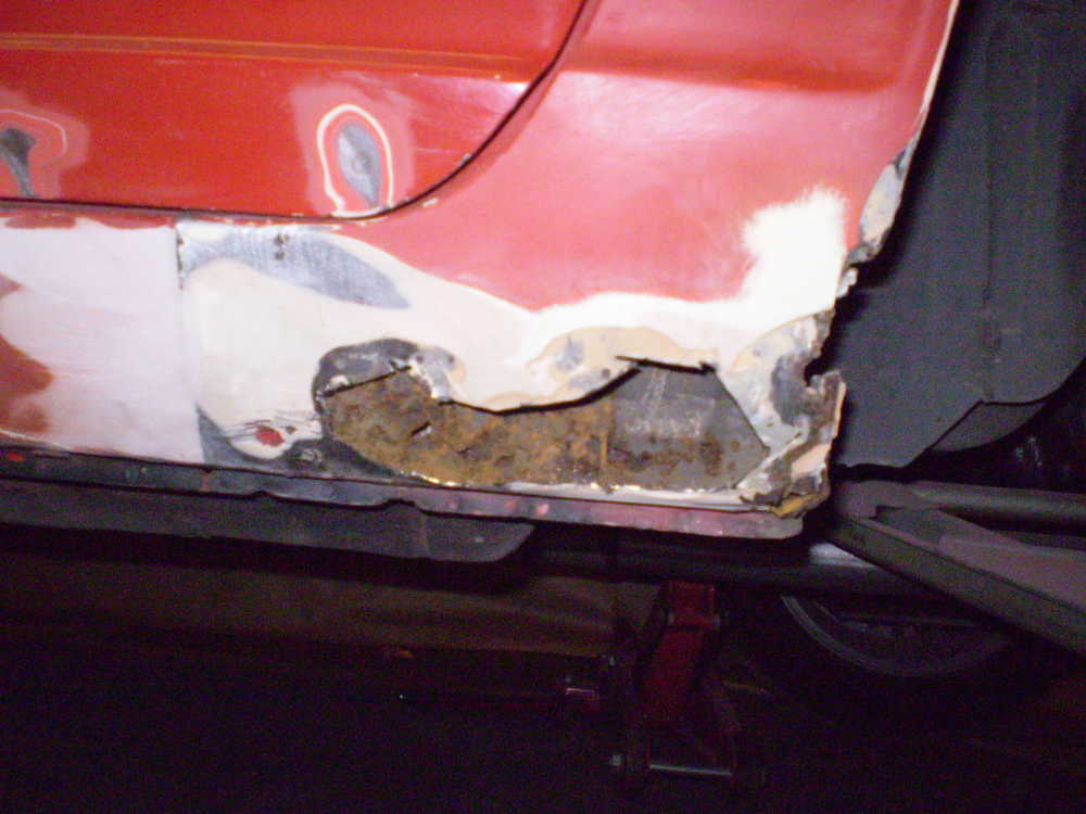

2) wheel well area, mainly the DOGLEG See attached picture, this is what I'm dealing with before I shoot primer before the paint job.
3) The fog machine is an excellent idea, you can rent one from a party supply store or music store that supplys lights and such for small cover bands.
It only leaves a powdery residew which can easily be blown out later on.
I get the same problem with mine but every detail is being looked over as I do the body work for the upcoming paint job.
Isn't this lovely, found it while sanding out what I thought was a paint bubble.
Turns out that it's a great spot for exhaust to come in, time for more sheet metal.
