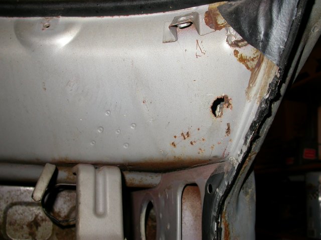

When I stripped my car down, under the dash on the passenger side, I found a small hole rusted through from the cowl area. Inside the cowl area, you can barely get to this hole, and there was a big piece of some kind of dried up "sealer" over it anyway. Never would have found it without removing the dash. Undoubtedly was leaking water into the passenger compartment.
