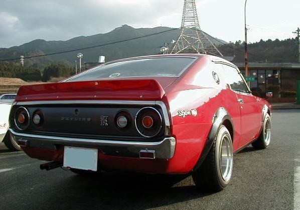

Um, just seeing from your avatar picture, you have GL tail lights, not GT... not that it matters mechanically as I think the GT was simply higher spec in air con and a tape deck etc... but your car might be a GL not a GT.
Japanese C110's didn't have Nissan badges on the rear at all, simply "Skyline" and "GT"... see attached

No, I think the only one to have the reverse lamps centred and the park lamps on the outer was the GTR, I've got images/scans of a German 240KGT sales brochure that I'm translating using babelfish, being they're images though it means I have to type it all out, there's about 6 pages (incl. of pictures) all up but I should be done soon, I do it when I'm bored, but with my new car, I probably won't be too bored anymore. :D

Maybe you've seen a GT with a GTR tail-light section, if so, you should go chase it up, would be an excellent find.

As for the tail lights, I may have mentioned to Alfadog or someone a while back on how to get a GTR look, I've done it with my earlier coupe (no pics), but you need to get your hands on another set of tail lights to do it. It involves a) removing the reverse/brake light unit and separating the two from one another (pretty easy) B) using the spare tail lights remove them from its body and filing away some notches etc to enable it to fit the old reverse light assembly. (Keep an eye out for the sealant in there, its very well preserved so take your time removing it, I done it with a flat screwdriver.) c) when re-assembling the new reverse lamp unit use a quality sealant also, not some glue, but a proper one like say windscreen sealant or something. Now what you have is effectively 4 red tail lights but the centre two are working as reverse lights, this is fixed by routing the wires from the centre two to the existing tail light wiring, and fitting a small clear lense lamp somewhere as a reverse light. I mounted mine within the "beaver" panel, cut a small hole and mounted the lense flush with the panel so it wouldn't protrude and look crap. Just route the reverse wires to this lamp and away you go.
Tedious, but to get that look with limited options, it worked fine and looked good, esp at night with the 4 tail lights on.

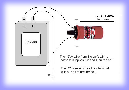

Oh JMT240KGTR, is it any particular model of R30 that the electronic dizzy will fit from?

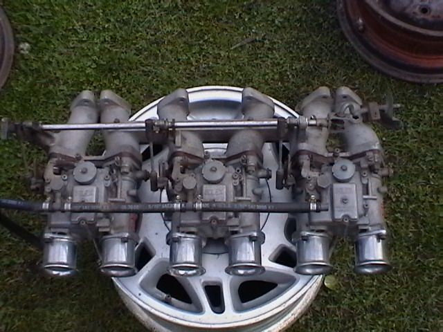

And and for everyone to stare at I've attached a picture of the Triple Solex's. MMMMMmmmmmmm, Triple.

R30 Skylines w/EFI is the go. Make sure it has the larger coil than a standard points dizzy model, and the dizzy with the module with the 2 prongs for the wires. See below for wiring
I've actually got a Mallory Voltmaster coil sitting here that I got for another car in the hope of getting an electronic dizzy for, which didn't happen, would it be possible to use the mallory instead of having to grab the coil as well from the wrecker (the wrecker is reknowned for being a rip off) or is the module attached to the coil or the dizzy itself?
