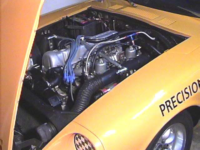

August 27, 200321 yr comment_47907 I would agree with Rick about the cooler air. Getting cooler air from up front of the grill would be your best option and easily done too. If it's dryer vent hose it may easily be damaged or fall apart which the hose from Race Parts Wholesale works great. Here is an older picture of that idea I used in the past, since then I have changed it and added an HKS filter infront of it, but same idea of getting fresh cooler air from up front. Craig Link to comment https://www.classiczcars.com/forums/topic/7623-ram-air/#findComment-47907 Share on other sites More sharing options...
August 28, 200321 yr comment_47973 Here's a photo of Victor's "El Cheapo" Cold Air Induction! Whataya think? Link to comment https://www.classiczcars.com/forums/topic/7623-ram-air/#findComment-47973 Share on other sites More sharing options...
August 28, 200321 yr comment_47983 Hi Victor, Nice implimentation! I think I'll try that myself! Best Regards, Landmizzle '72 240Z Originally posted by Victor Laury Here's a photo of Victor's "El Cheapo" Cold Air Induction! Whataya think? Link to comment https://www.classiczcars.com/forums/topic/7623-ram-air/#findComment-47983 Share on other sites More sharing options...
