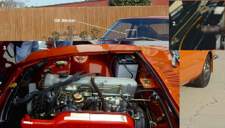

I purchased a decal set for my 72 240z from Banzai Motorworks. Looked thought all my Sport Z mags and all my reference and restoration manuals for pics of proper location. Can't find any photos or even any descriptions. Any suggestions other than to find someone who has a concours model and take a look under the hood?

1. This photo is of a 1973 with 14,000 original miles for sale on ebay back in January. If you look real hard, you'll see the "OK" sticker on the passenger side quarter window.
2. This picture shows where the silver radiator coolant decal goes on the fan protector. Also, you can see the small kind of orange colored "Nihon" radiator decal right next to the top hose. This photo is of my 1973 Z taken back in 1992.
3. The engine close up is of a 1972 Z Store car taken at the MSA show back in 2002. The photo shows where the air cleaner decals are placed.
