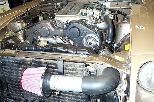

January 23, 200223 yr comment_2291 Unfortunately to have it all (as I wanted as well) - reliable starting, no overheating, not too loud, daily driver etc, then you have to go forced induction or another engine. I went pioneering in my neck of the woods and put a VG30DET engine in it and with very liite modification am getting over 280 bhp at the rear wheels with tractablilty, relative quietness (still makes a nice throbby note) and most of all no hassles with reliability.If you like any more info, let me knowGreg Link to comment https://www.classiczcars.com/forums/topic/775-250-bhp/#findComment-2291 Share on other sites More sharing options...

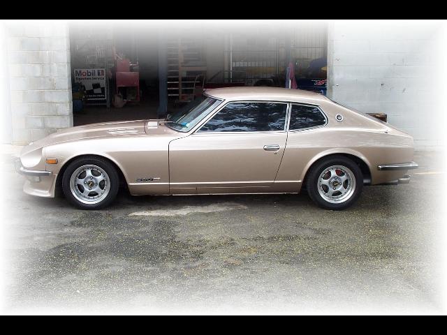

January 23, 200223 yr comment_2296 bigmac,How about showing us some picts man? I want to see this beast![m] Link to comment https://www.classiczcars.com/forums/topic/775-250-bhp/#findComment-2296 Share on other sites More sharing options...

January 23, 200223 yr comment_2303 Mike, this is a few photos I have at work Greg Link to comment https://www.classiczcars.com/forums/topic/775-250-bhp/#findComment-2303 Share on other sites More sharing options...
January 23, 200223 yr comment_2304 Ah, okay... I've seen that one. I didn't realize it was this one...Thanks! Link to comment https://www.classiczcars.com/forums/topic/775-250-bhp/#findComment-2304 Share on other sites More sharing options...
January 23, 200223 yr comment_2305 and another Link to comment https://www.classiczcars.com/forums/topic/775-250-bhp/#findComment-2305 Share on other sites More sharing options...
January 23, 200223 yr comment_2306 Sorry Mike, I thought you had seen it before. Link to comment https://www.classiczcars.com/forums/topic/775-250-bhp/#findComment-2306 Share on other sites More sharing options...
