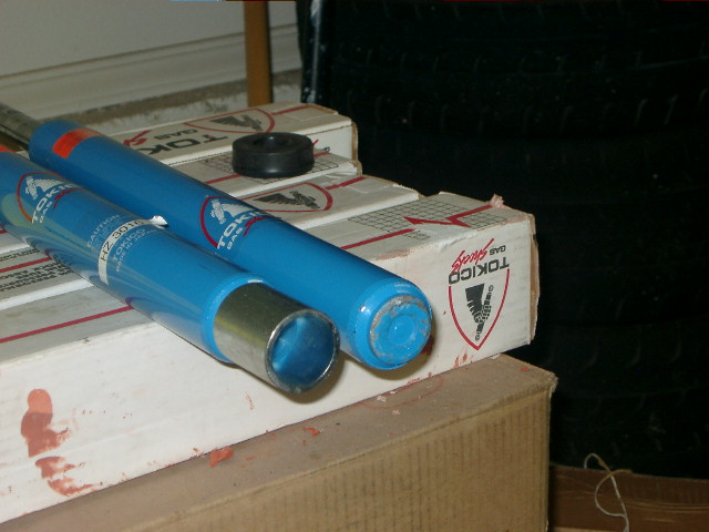

Both boxes say '3106', but the contents are different. One is the standard 3016 cartridge. First of all, it has a new sticker on it that says '3016'. It is a front--with an extension. The cartridge body is about 2" shorter and it has a piece of pipe pressed onto the lower seat to make up the difference. So, resting on the ground, both cartridge BODIES are exactly the same length. But, at full extension, the rod on the altered strut is 3/4 of an inch longer. Now, I know cartridges technically have no 'spring rate'. But I have to push down on this thing with, say 50 or 75 lbs of force to get it down to the same length as the other strut, and wouldn't that translate into the suspension? And what about the valving? Why would Tokico add an extension and relabel something?
Has anyone ordered Tokico Non's and seen this modification to the 3016 strut cartridge? Has anyone ever ordered a strut from ANYONE and seen the factory modify a different model to fit your length? Should I use these two different struts in the same front end? I can't help but believe it will make a difference from right to left.

Just got my cartriges today. Both boxes say '3016' on them. But one is a 3016 and one is a different strut that has been modified to adapt to a 3016 'size'. The cartridge body is about 2" shorter and it has a piece of pipe pressed onto the lower seat to make up the difference. There has been a new sticker that says "3016" applied over another model number on the cartridge. So with the 2" extension in place, the cartridge body is now the right length for the strut tube. But the free length of the rod is about 1 inch longer than the true 3016. Now, even though struts technically have no 'spring rate', I can't help but think this would affect things. It takes 50 or 75 lbs of my force to push the odd cartridge rod down to the same level as the normal one. This HAS to translate into a suspension. And what about valving? What weight car is this short strut from? Is the 3016 discontinued or something? Why would Tokico modify a cartridge with an extension and package it as a replacement? Is this the way all 3016's are going to be from now on? This really has me befuddled and I don't think I should use these two different strut cardridges on the same car rear end.
Please advise.

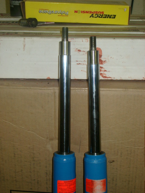

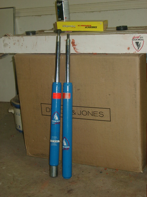

For those with absolutely nothing better to do but follow my little soap opera and are thinking, "WTF is he rambling on about, demented old fool." Here are a couple of pictures of what I received in the mail from a company I have purchased many Tokico cartridges from with excellent results. I think the problem is Tokico.
By the way, these were ordered as a pair of 240 rears.
steve77
...and here's the REAL itch in my panties... There is no way I am putting these two struts on the same end of a car. If they were hydraulic, it might be different, but Tokico non's are pressurized, of course.
Both these struts are labeled HZ3016
steve77
Originally posted by Zvoiture
Check out pegleg.
One of them is a Pirate copy. HAAAAAAARRRRRR!
Either that or these are the very rare Neck-car versions for a staggered ride height. Just put the short one on the left side of the car and make sure you keep turning left.

Latest news: Thursday I actually received a PHONE CALL from Coung at autocarparts. Seems the pix worked! Just to think they would have saved well over a week of e-mailing.... Coung expressed his deepest regrets and wanted to verify by phone which strut in the picture was actually the desired one. He said they have never seen Tokico add an extension to a stock model and repackage it (or at least no one has ever complained about it). He said they were in the process of "opening all the boxes in the warehouse to see if there were more." They are sending me a single full length unit (if they find one!) and I am to return pegleg.
We will see.
