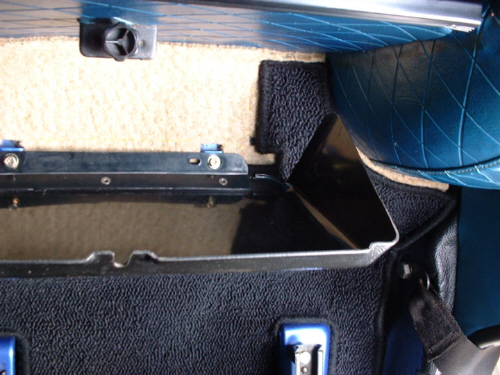

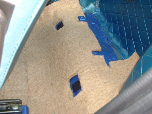

November 12, 200321 yr Author comment_56794 Hello everyone, I posted these photos already in Alan's thread. I post these again for this thread. This photo shows 1969 fairlady Z432's jute pads.Japanese Z does not have a plaque of manufacture date like US & CANADA model. The Z432 is owned by Mr.WATANABE and he reported this Z has a date stamps DEC 1969 on the back side of the steering wheel,and this Z was registerd in japan very late DEC 1969,there is a document still with this car. kats Link to comment https://www.classiczcars.com/forums/topic/8002-original-jute-material/?&page=2#findComment-56794 Share on other sites More sharing options...

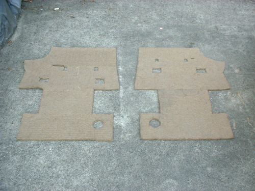

November 12, 200321 yr Author comment_56797 Hi, This photo shows my new jute pads for my 1970 240Z. I made this by myself after returned home from SAGAMIKO event very carfully looking at Mr.WATANABE's perfect example. Actualy I got these from Mr.NISHI(professional restorer) first,but these were not correct shape as you see on this early thread. I was lucky to have extra jute then I cut and attached and trimed them together. kats Link to comment https://www.classiczcars.com/forums/topic/8002-original-jute-material/?&page=2#findComment-56797 Share on other sites More sharing options...
November 12, 200321 yr Author comment_56800 And I found early fairlady Z's tool box layout is just opposite from US & CANADA model. So I need to be carful to cut my new jute because fairlady Z's jute pads shape are just reversed right and left. I forgot to see of plastic tool cover's shape,I think they are also opposite? I think the box(plastic cover) for the rench and red rods can be applied right and left,but the box (plastic cover) for the jack and choke plates can not be applied both side due to the shape is made only for a paticular side right or left. kats Link to comment https://www.classiczcars.com/forums/topic/8002-original-jute-material/?&page=2#findComment-56800 Share on other sites More sharing options...

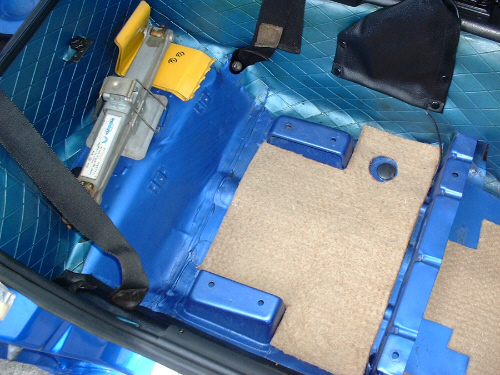

November 12, 200321 yr Author comment_56801 The last photo for this thread this jute is behind right seat's. kats Link to comment https://www.classiczcars.com/forums/topic/8002-original-jute-material/?&page=2#findComment-56801 Share on other sites More sharing options...
November 12, 200321 yr comment_56803 Kats,Did you make tracings of the patterns? I removed the jute padding from my tunnel and traced a pattern. This is very interesting. Does the jute cover the rear bulkhead? Is the jute exposed under the tool lids. or does this have carpet also?Your car is looking great! Link to comment https://www.classiczcars.com/forums/topic/8002-original-jute-material/?&page=2#findComment-56803 Share on other sites More sharing options...

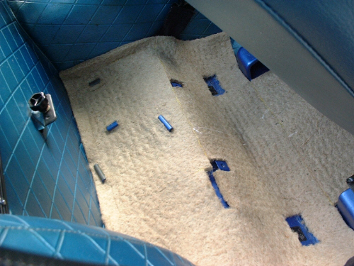

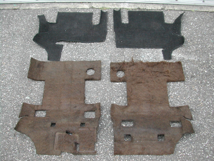

November 13, 200321 yr Author comment_56849 Hello everyone, I made a mistake,I was wrong about the tool lid for jack and choke plates. I checked mine,it seems to me it can be applied both LHD and RHD. If there is anyone can check and make a comment for this topic here,I will very happy. 26th-Z,I did not trace from Mr.WATANABE's original. Just I added extra jute while seeing original photo in my computer and using my imagination fully. Because Mr.NISHI was made nealy perfect jute already so it is easy work for me. I post photos of my jute restration from the bigining.It started from "something short" but finally got perfect shape. And Mr.NISHI said original jute might get dyed with a kind of anti-rust liquid. This photo was the first apperance of my new jute.It was not correct for my march 1970 240Z. This fat "T"shape is started from late 1970. I also saw Mr.YAMADA's original jute manufactured late 1970 fairlady Z-L at sagamiko event, This Z is series 1(I know Alan do not say like this) but there is a very small rib across from the center tunnel to the body side sill behind both seat mounts.The hight of the rib is just same as the thickness of jute pad. So jute pad should be this shape,being separated by this rib. I mean my march 1970 Z do not have the rib,so jute pad needs not to be separated,it is natural to guess the jute pad might look much bigger than this,it might be one piece from the tool lid area to under the seat. At last,my guessing was veryfied"right" when I saw Mr.WATANABE's truely original jute pads. 26th-Z, you saw Mr.WATANABE's jute pads photo,there are two black carpets they are exactly original. Also Mr.YAMADA's late 1970 fairlady Z-L have just same shape carpet,sthey are original too. I orderd Mr.NISHI to make carpets ,he knew original shape about carpets but he used to say did not know the original about jute pads. Mr.NISHI was also attended sagamiko event with his family to sell their magnificient products and so many OEM parts. At the event,Mr.NISHI and I got the answer for the jute pads. By the way,Mr.WATANABE and Mr.YAMADA both said to me "I have never think about jute pads,today it is the first time to me to look at them really carfully " Thank you, kats Link to comment https://www.classiczcars.com/forums/topic/8002-original-jute-material/?&page=2#findComment-56849 Share on other sites More sharing options...

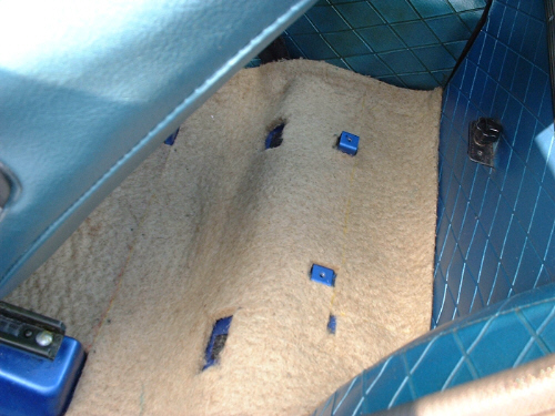

November 13, 200321 yr Author comment_56853 This was the second step,I asked Mr.NISHI to cut the jute which was the same shpe as carpet. At this time,I did not attached them(new tool lid area jute and the fat"T"shape jute) togather because I did not have a confidence for originality. kats Link to comment https://www.classiczcars.com/forums/topic/8002-original-jute-material/?&page=2#findComment-56853 Share on other sites More sharing options...
November 13, 200321 yr Author comment_56854 I cut and attached extra jute for original shape. I dicided to do this because at sagamiko event I saw the Mr.WATANABE's original jute pads. kats Link to comment https://www.classiczcars.com/forums/topic/8002-original-jute-material/?&page=2#findComment-56854 Share on other sites More sharing options...
November 13, 200321 yr Author comment_56858 assembled with a tool lid and a carpet. Link to comment https://www.classiczcars.com/forums/topic/8002-original-jute-material/?&page=2#findComment-56858 Share on other sites More sharing options...
