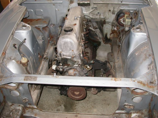

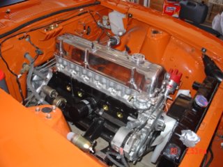

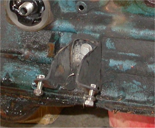

Nope, those mounts look OK. Notice that the right one comes out flat on top and the left one angles down. So, doesn't look like the problem. Sorry. There are only three mounting points for the engine and transmission - those two and the rear of the tranny. I don't see how the rear can be off if these are OK. Got me now...:ermm:
OH! I was looking at the photos wrong - the mounts are different, but they DO appear to be reversed! the one that comes out flat on top should be on the right (passenger) side of the engine, and it looks like you have it on the drivers side.

I think you are right, I looks like they are reversed. Damn it, no I have to lift the motor again. :mad:
Hard to tell for sure from the angle of the photo, but it does seem that the engine is sitting just a bit too "straight up". Easy to get the mounts mixed up and a relatively easy thing to fix.
I had both mounts on the wrong sides of the engine while it was on the engine stand being rebuilt, and only realized my error 5 minutes before I was to install the motor in Bambikiller. :stupid:
I see the difference now. Thanks for the help. Its kind of a bummer after spending 7 hours on the car including installing and aligning hood, now I have to go back and rent the picker to redo the mounts. Oh well, at least I know the problem.
