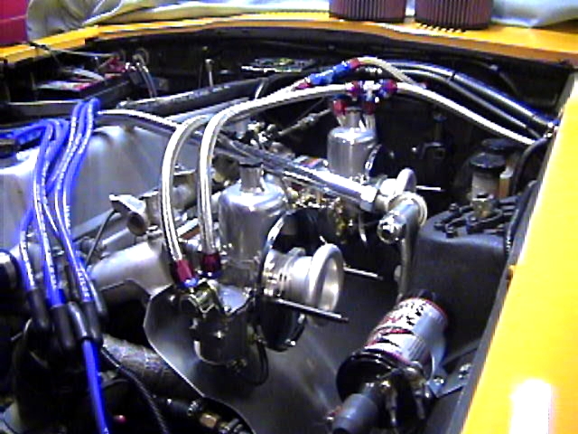

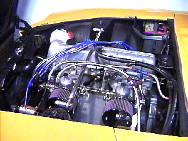

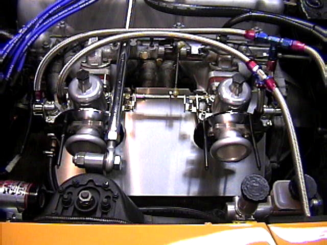

Posted September 27, 200321 yr comment_51057 I think my back is broken from leaning over this thing all day long. Just finshed installing a pair of modified Z-Therapy SUs tonight. I also cut a larger heat shield from some stainless and installed it to help keep the heat off the carbs from the headers. Link to comment https://www.classiczcars.com/forums/topic/8101-new-sus-heat-shield/ Share on other sites More sharing options...
September 27, 200321 yr Author comment_51058 I used a set of full radius air-horns and a pair of K&N filters. I still need to dial them in and sync. them better with each other. One thing I was amazed about with this change, was the tone of the carbs as they take a deep breath with the mash of the peddle. The exhaust tone probably drop down about 2 octaves too. I thought there was another problem when I first fired it up! Guess now it's flowing better than ever. Time to clean up and this week-end we'll sneak her out onto the road.:pirate: Link to comment https://www.classiczcars.com/forums/topic/8101-new-sus-heat-shield/#findComment-51058 Share on other sites More sharing options...
September 27, 200321 yr Author comment_51060 Here's one more pic. Link to comment https://www.classiczcars.com/forums/topic/8101-new-sus-heat-shield/#findComment-51060 Share on other sites More sharing options...

September 29, 200321 yr Author comment_51313 Ya know Victor I can't remember the mfg. of these cam plates? I got them from a guy in a Z shop in San Fransisco, I gotta dig around for the paper work. But they seem to have alot of adjustment in them, and they are now set with a little neg. camber, but I should probably have em checked again soon. Anyhow, Chino is still here. Just not many corn fields or dairies-cows around anymore. All industrial, cement, homes, and shopping centers. The past 5 years things have changed alot! The prison is still there and the land below that area is still not developed much yet. I live off from Pipeline and Chino Ave. area by Don Lugo High School, if ya know the area? There is the 71 Expressway that starts from the 57 fwy / 210 and flys thru the Chino / Chino Hills area and connects to the 91 fwy. This really helps traffic out in the area and makes things easy to get to around here. Chino is a good City. I'm grew up in Upland & Ontario and now in Chino to stay. Another pic with the filters put on and buttoned up for now. . . Link to comment https://www.classiczcars.com/forums/topic/8101-new-sus-heat-shield/#findComment-51313 Share on other sites More sharing options...
