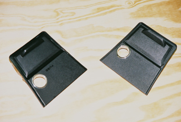

The early ashtray is on the right. The semigloss paint finish reflects light more than the black plastic. The ashtray on the left is solid black plastic.

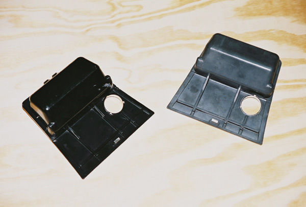

It has a hollow handle on the lid.
Notice the grey? This plastic is a peculiar composition. It resembles "Bakelite" an early plastic from the thirties and forties. Turns out, the only glue that will work is superglue. I used a gel format for my work with this plastic. It doesn't dry so fast and allows time to adjust and clamp the repair.

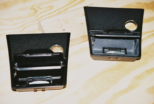

My ashtray is the gray plastic (?) also. It looks as though Nissan had just put these ashtrays on a flat surface with the lid on and shot black paint on the top and sides. The inside lip where the lid rests is half black and half gray plastic due to the quick paint job. Like yours my inside is still the natural gray color. Unlike yours the underside of mine is still the natural gray color.
Stevemasum
The underside of mine is still grey. I'll get better with auto pictures, I promise! Yes, it has "overspray" down the sides and they must have painted it with the lid shut. The early radio face plate is similarly made - painted grey plastic. It resembles a thermoplastic - yes.
