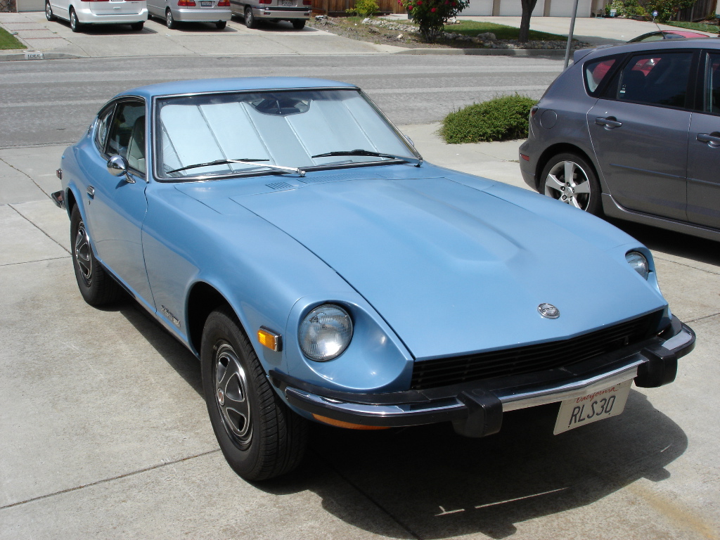

The PO of my 260z had the car repainted in 2001 and there are some small areas of paint fade on the car now. I really don't want it to spread and I am afraid to wax it as I have heard that it can cause more damage. The paint fade just started and it is on the hood. Would insulating the hood with that tin-foil looking heat resistant aircraft sheet on the underside slow the fading process? Also, there are some cleaning agents that say they remove light paint fade and oxidation. How much is little? Would it protect and clean up my paint if I do what Marty advised? The paint does not have a clear coat either and I feel that the repaint was not of high quality.
I am not planning to do a repaint any time soon as the mechanicals have me busy. I just want to see what I can do to protect what I have.

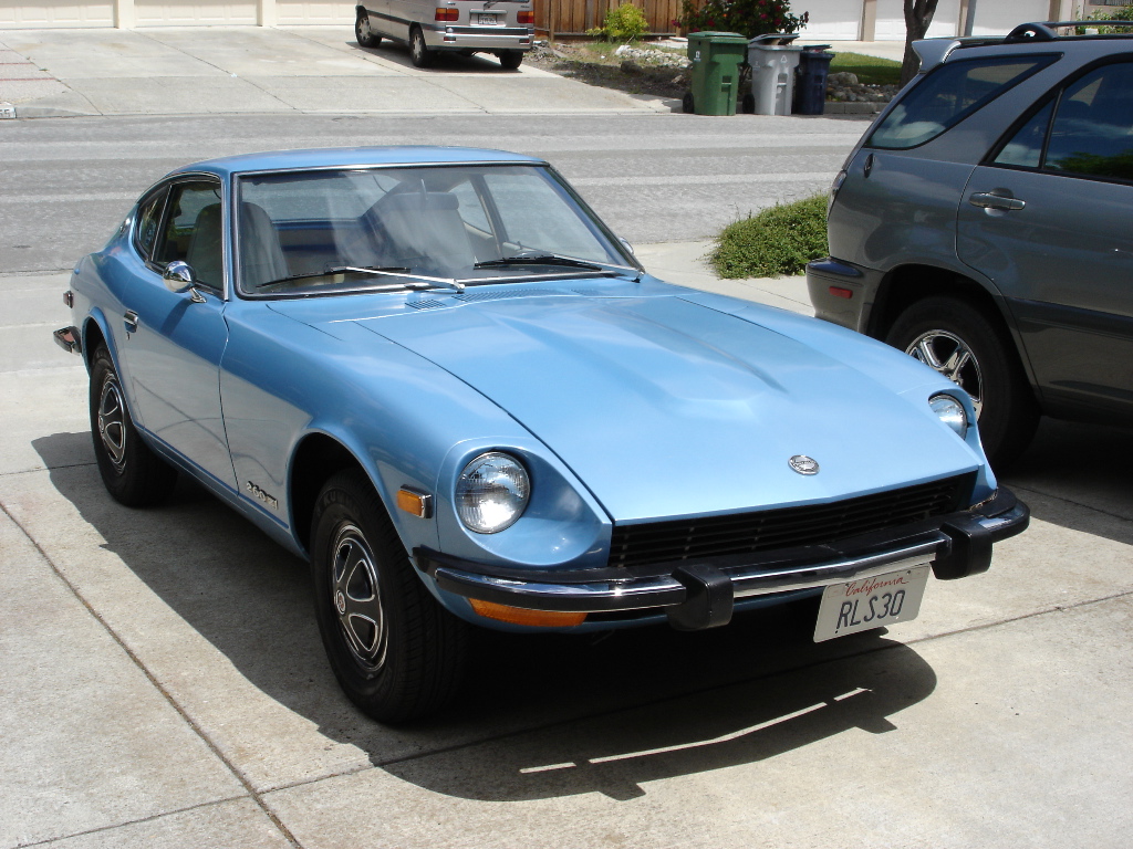

Hi guys, I am really glad that I underwent this project because the results were amazing. There was quite a bit of oxidation on some spots of my hood, and the Mother's cleaner wax took out almost all of it. It is not perfect like Marty stated earlier, but there is only a small bit of oxidation still on the hood.
1. I first washed the car thoroughly with the Mr. Clean autodry system.
2. After the car was completely dry, in the shade and cool (the car had sat in the garage for a few hours), I started using the clay bar. I kept the surface lubricated with the Mother's California Gold showtime instant detailer.
3. I moved on to another section after the paint felt smooth.
4. After the car was done (about 4 hours) I started the waxing according to the directions on the bottle.
5. I waxed the highly oxidized areas about three times Karate Kid style wax on-wax off, and then I for the last one I let the wax haze before rubbing out with a micro-fibre cloth.
6. Once completed, I took a lot of pictures and stared in awe.
I am planning to wax the car every 4 months. I really want the paint to last and look good, but I don't want to overwax it. Would this be the right amount of elapsed time to wax it?
Thanks for the inspiration and kick in the butt. Here are some pictures. The first one is where you can see some fade on the hood. The others are after the complete treatment. It is ready for the Blackhawk show now :).
