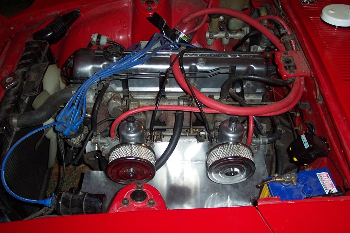

December 28, 200321 yr comment_62081 Sorry to hijack the thread. Just looking for some more ideas to help my vapour lock problems. As is I now have a high volume electric pump and I've also built a quick dodgy aluminium heat shield between the carbs and the exhaust manifold. However the carbs still get incredibly hot when I shut the car off on a hot day (been 40?C lately). It'll always start up fine, but will die after about a minute, usually when I'm pulling out onto the road. After that it wont start for a good 15-30min. *grrrrr* Does that sound more like the fuel boiling in the carbs, or still somewhere along the fuel lines? The heat shield helped a fair bit, but it still will get rather hot under there when you turn the car off. The only solutions I can see are either a vented bonnet which I don't like the look of and can't afford anyway and my other idea was to install a small therofan at the front of the engine bay to keep some cool air flowing over the carbs for say 10 minutes after you turn the car off. Sounds like a reasonable idea? Any other ideas? Thanks, Justin Link to comment https://www.classiczcars.com/forums/topic/8282-ceramic-coated-headersextractors/#findComment-62081 Share on other sites More sharing options...
December 28, 200321 yr comment_62083 Here's a pic of the setup if it helps at all. Link to comment https://www.classiczcars.com/forums/topic/8282-ceramic-coated-headersextractors/#findComment-62083 Share on other sites More sharing options...
December 28, 200321 yr comment_62088 Originally posted by Datto-Zed Any other ideas? In the USA, when Nissan had problems with the Flat Top SU's and heat soak causing problems, they insulated the fuel rail with a set of small blankets that were aluminized on one side and some sort of insulation like asbestos fibres on the inside. They surrounded the entire fuel rail with these. I would consider some sort of passive system like that before engineering a more complex system like a timer or temperature activated fan.Just my (Cheap Assed) $.02Carl Link to comment https://www.classiczcars.com/forums/topic/8282-ceramic-coated-headersextractors/#findComment-62088 Share on other sites More sharing options...
December 28, 200321 yr comment_62089 Do you think it would be the fuel boiling in the fuel lines though, considering I have a electric pump pushing a good volume of fuel?I was thinking it would be a case of the fuel boiling in the carbs/bowls, but now keeping in mind it will run for about a minute as I idle it around and then die, that sounds more like the carbs aren't getting any fuel and it dies after all the fuel in the bowls is used? Sound plausible? How long would the car be able to idle for with only the fuel in the bowls? I might give that a test tomorrow. Link to comment https://www.classiczcars.com/forums/topic/8282-ceramic-coated-headersextractors/#findComment-62089 Share on other sites More sharing options...
December 28, 200321 yr comment_62090 Does the fuel system recirculate? If so, the electric pump will be constantly pushing fresh petrol through the fuel lines, in which case there should be no vapour locks.My '77 had that sort of stuff Carl mentioned wrapped around the lines so I guess that Nissan thought they were vulnerable. Your heat shield looks pretty good, Justin, but with the carbs sitting above the exhaust and no way for the hot air to rise out it is basically a design problem. Link to comment https://www.classiczcars.com/forums/topic/8282-ceramic-coated-headersextractors/#findComment-62090 Share on other sites More sharing options...
