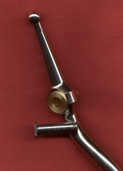

January 10, 200421 yr comment_63590 Damn good idea that everybody keep a set of bushings around. Stock rubber or solid. When ever the time comes that that center console comes out for what ever reason change 'em. Sorta like cheap insurance for that one really bad misshift at redline! . Also I would like to suggest the hair pin that holds the "B" type stick in be replaced WITH A NEW one. Just more cheap insurance. I actually had my shifter come through the boot in my hand while trying to shift. Getting on the freeway, comeing from Motorsport! Man I wish I had a picture of my Girlfriend's face that day!!! :devious: Link to comment https://www.classiczcars.com/forums/topic/8358-stick-shifter-length/?&page=3#findComment-63590 Share on other sites More sharing options...
January 10, 200421 yr comment_63593 The MSA shifter is shown with some solid bushings I machined and installed to replace the stock ones. The other pic shows the difference between the early and late 5 speeds. the shifter with the re-welded, angled arm is from an early box. The straight shifter is out of an 80'ZX. Phred Link to comment https://www.classiczcars.com/forums/topic/8358-stick-shifter-length/?&page=3#findComment-63593 Share on other sites More sharing options...
January 10, 200421 yr comment_63594 MSA shifter pic. Link to comment https://www.classiczcars.com/forums/topic/8358-stick-shifter-length/?&page=3#findComment-63594 Share on other sites More sharing options...
