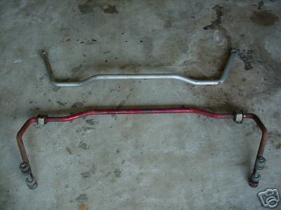

Ok, I'm back and trying to determine the manufacturer of the sway bars in this pic. I found these for sale and the owner does not know anything about them. I'm trying to avoid drilling the chassis to install a rear sway bar, that's why I am asking. I'm also curious which one is the front and which is the rear?

The one at the top of the picture appears to be the front one. That one at the bottom looks like the kind that will require drilling the chassis to me.

The pair in the last pic I have attached above is available to me for $100 so if they are the ST or Ground Control brand I will get them. The problem is that the seller does not know nor has he ever installed them so he does not know how they attach either.

They do not look anything like the Ground Control set pictured on Pg 1 of the thread.
I don't think they are the S.T. brand either. Shape doesn't look right to me.
Perhaps Victor Laury can confirm (since he has one on his car), but the shape of the Rear bar in your picture looks similar to what I remember the MSA bar looking like. Also, no mounting brackets are shown, so even if it WAS the right style bar, you'd be then searching (and paying more $$) for the rest of the hardware needed to install it on your car.
If you are going to want to buy a used set of bars, I'd pass on these and wait until you find a seller who can show you a picture of a complete set-up that confirms that what you will be getting is what what you want to have.

I believe that I will be passing on these Bambi, I was already leaning that way since he could not confirm anything about the brand or style.
Yes, patience is what got me the car I have for the great price I paid. I will just keep looking and if I do not find the right pair by the time I have other things done and am ready to start autoxing then I will have to pay out for the new set.
