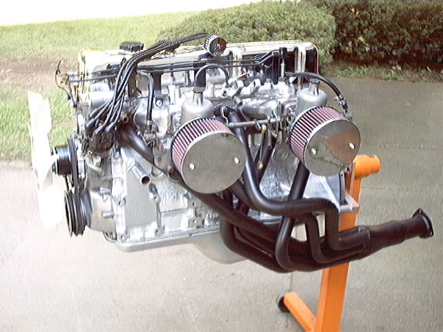

October 19, 200321 yr comment_53723 I went with 6-1 header from Arizona Z-Car. Right after the flange I put a 22" resonator and a 15" resonator where the muffler should be. It sounds great. Not too loud but not stock. Link to comment https://www.classiczcars.com/forums/topic/8450-headers-exhaust-suggestions/#findComment-53723 Share on other sites More sharing options...
October 19, 200321 yr comment_53726 pic Link to comment https://www.classiczcars.com/forums/topic/8450-headers-exhaust-suggestions/#findComment-53726 Share on other sites More sharing options...
October 19, 200321 yr Author comment_53730 very nice pic love the finished look Link to comment https://www.classiczcars.com/forums/topic/8450-headers-exhaust-suggestions/#findComment-53730 Share on other sites More sharing options...
October 19, 200321 yr comment_53743 Hey Victor, have you had any problems with the appearance of your header? I got the same (ceramic coated 6-1) and the pipes have 'fogged' up near the head and I can't clean it to a shine again. Not sure what happened Link to comment https://www.classiczcars.com/forums/topic/8450-headers-exhaust-suggestions/#findComment-53743 Share on other sites More sharing options...
October 19, 200321 yr comment_53747 Thanks seerex. Looks good there but the paint peeled off in no time. Next time I'll try ceramic coating. Live and learn. It is a good thing the engines come out so easily. Link to comment https://www.classiczcars.com/forums/topic/8450-headers-exhaust-suggestions/#findComment-53747 Share on other sites More sharing options...
October 20, 200321 yr comment_53763 Originally posted by blitzkraig Hey Victor, have you had any problems with the appearance of your header? I got the same (ceramic coated 6-1) and the pipes have 'fogged' up near the head and I can't clean it to a shine again. Not sure what happened Yea, It fogged a bit. Sort of whiteish/pearlish. I was thinking it would come off with that good German polish - Flitz is it? But I haven't tried it yet. Link to comment https://www.classiczcars.com/forums/topic/8450-headers-exhaust-suggestions/#findComment-53763 Share on other sites More sharing options...
