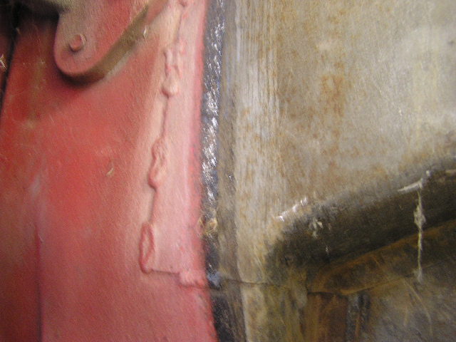

Posted October 25, 200321 yr comment_54580 Took the front wing off and cleaned up noticed some ugly tack welds where should be spot welds? Do you think the inner wing has been replaced? The rest of the welds seem ok. Is the standard under body treatment painted underseal? Link to comment https://www.classiczcars.com/forums/topic/8549-accident-damage/ Share on other sites More sharing options...

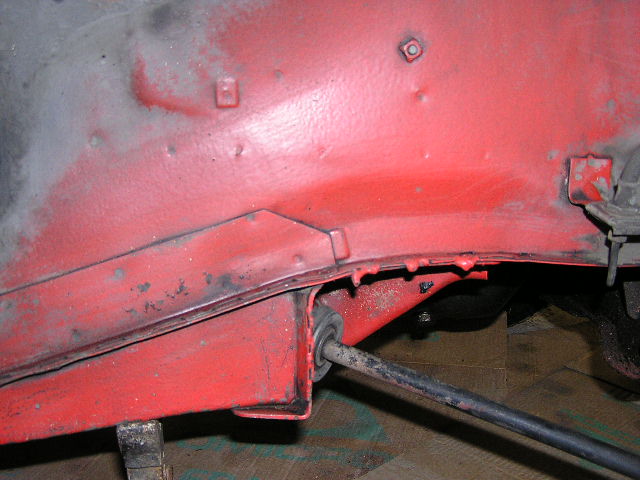

October 25, 200321 yr Author comment_54581 Heres a picture of the rear welds Link to comment https://www.classiczcars.com/forums/topic/8549-accident-damage/#findComment-54581 Share on other sites More sharing options...
October 25, 200321 yr comment_54582 Nick Looks pretty standard to me. Virtually the same welds on my unrestored car. That's a pretty good original inner arch if you ask me, if the paint is mostly still there under the dirt. Over here in Pomland we got a black underseal coating in the wheel arches and on the floorpans ( fat lot of good it did though .) My ex US CA car has no undercoating at all just paint and 30+ years of dirt all the best Andrew Link to comment https://www.classiczcars.com/forums/topic/8549-accident-damage/#findComment-54582 Share on other sites More sharing options...
October 25, 200321 yr comment_54600 My car has the exact same welds.:classic: Link to comment https://www.classiczcars.com/forums/topic/8549-accident-damage/#findComment-54600 Share on other sites More sharing options...
October 25, 200321 yr comment_54601 Mine has the same thing, it's factory. The only place on a Z that didn't get a spot weld is what you pictured.The ones over the T/C mount look better than the ones that were one mine that's for sure. I've seen some that hung down an inch. Link to comment https://www.classiczcars.com/forums/topic/8549-accident-damage/#findComment-54601 Share on other sites More sharing options...
