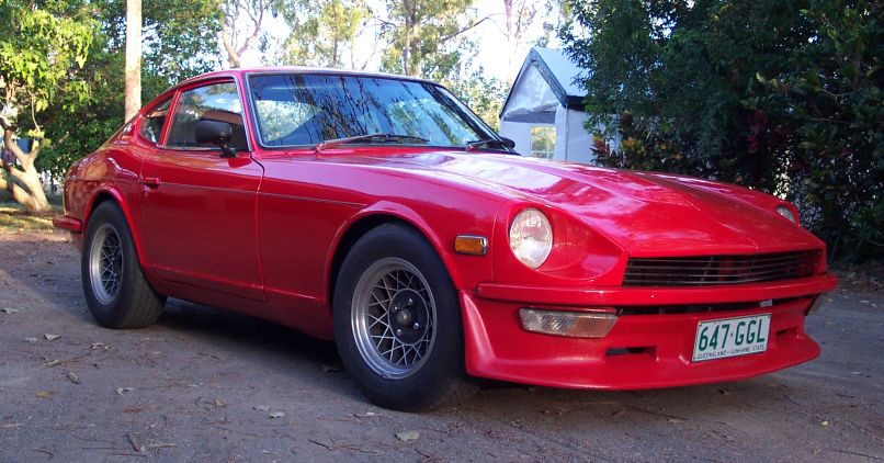

Hmm....doesn't look like much difference in the photos does it? It certainly made quite a big difference in person. Before it had somewhat of a 4WD look to it because of the ride height and big tires.
Looks a lot better now. :)
