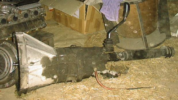

Could you tell me/do you know what 5speed was in the 81 L20E HR30 Coupe? I recently removed one for my 240K, haven't got around to putting it on yet, still need a few more bits and pieces.
I have attached a picture of it, as you can see it has a bent stick, and there's no identification plates on it anywhere (there is on the auto on my 240K) There is also a number stamped into the very top of the bellhousing but it doesn't seem to correlate with any transmissions numbers I've read anywhere else.
Hey Ben, Firstly, thanks for your response.
Secondly, are you sure it wont fit? the designation you just gave me (FS5W71B) is the exact number of the optional 5speed, listed in my 240KGT C110 series Factory Parts Manual.
So I guess, it should fit going by the parts manual which changes my question to.. are you sure that it's that tranny number? I did some basic measuring and it is physicall shorter than the auto, but I also grabbed the front section of driveshaft which from my bush mechanic measurements, seems to make up the difference. Or am I completely off track? :ermm:
I don't know the model number that seperates the stumpy' box from the 'regular' boxes found in the '70's & '80's Nissans. But all wide ratio OD boxes are designated FS5W71B (Floor shift, 5-speed, wide ratio, 71 series, B variant).
The driveshaft in the R30 cars is 2-piece (as you have discovered) with a centre bearing assembly. The 4-cylinder R30's use the 'regular' gearbox, but the 6-cylinders use the 'stumpy' box. If you have ever seen the engine bay layout of a 4-cyl R30, you will notice that the engine is set forward & the gearbox begins about 2/3 of the way into the engine bay.
The stumpy box won't fit into your K, but a Z, C, 810 or 910 5-speed will fit fine. The Z boxes of course could have a 2.9:1 1st or be a FS5C71B (close ratio) box, but it wil still fit (and have better ratios than a C110 FS5W71B).
