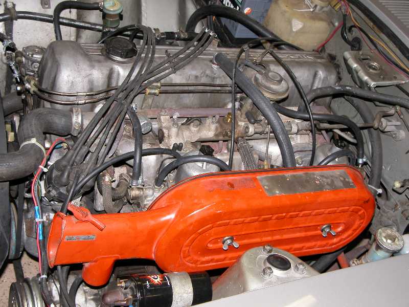

I have what I think is an early 70's aircleaner assy I bought on eBay. (note the manual summer/winter valve) When I put it on, I took the air cleaner element out of the existing 73 assy and it fit perfectly. Later I ordered an new air filter for a 70-71 aircleaner from one of the many Texas online parts places. What came was about 2 3/8" tall which wouldn't fit inside either of my assy's. Turns out the one in there now is just under 2" tall.
I've seen a few eBay auctions for filters for early 70's aircleaners and I've asked them to measure the height. All have come back at 2 3/8". So I'm confused about what I have. And more importantly, where do I get a new airfilter that will fit?

The Air filter element for later 240Z's is indeed thicker than for the earlier (pre FLAT TOP Carb'ed) 240Z's. It SOUNDS like the sellers are giving you the wrong filter. I'll have to measure how thick my filter is for Bambikiller (mifg'd 11/71) I haven't had a problem getting the right filter, though I bought a K&N lifetime filter a couple of years ago and haven't bought anything since then.
BTW your air cleaner can does look like the one of the early styles.

I don't know when the went to the one with the "flap" either. To my knowlwedge there are 3 types of air cleaner assemblies for 240Z's Earliest is the one you have Mark, then the one shown by 240ZMan which both used the thinner filter element, then the one for the Flat-Top Boat Anchor carbs which used a thicker filter.

Now, ZTherapy was selling an adapter to use the later style aircleaner with round top (early carbs). Is it possible that your car came with boat anchors and was converted to Round Tops? Is there an adapter plate of any kind mounted on the Round Top Su's between them and the air cleaner can? Just throwing out questions.
Carl,
Thanks for checking the measurement on yours. Actually, the setup you described is how I received the car: 72 carbs with the adapters for the 73 aircleaner. But that was a pain to tune because the 73 aircleaner drops down lower and it's virtually impossible to get your hands on the mixture nuts. Also, the aircleaner has square air horns and the carbs have round inlets.
So I bought an earlier aircleaner on eBay which is what you saw in the picture. Turns out they both take the same size airfilter which is just under 2" tall. So it may be that I just order one for the 73 - which goes against my instincts.
