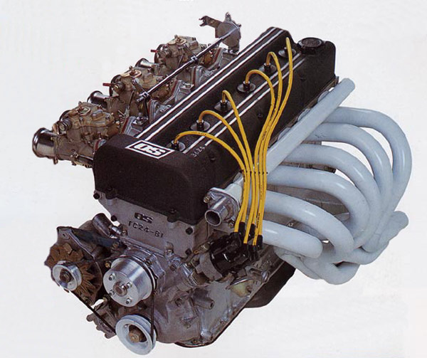

Hi Frank,
I think that might be the twin-cam 24-valve crossflow head conversion for the L-series six that was designed and manufactured by a company called "O.S.Giken" in Japan.
It was called the "TC24-B1", and as far as I remember they were first offered for sale to the general public in the late 1970's.
O.S.Giken are still making high-performance components for street and race cars ( they are famous for their clutch and transmission components in particular ) but they ceased making the TC24-B1 long ago. I spoke to them a few years back about the head ( thought they might have some New Old Stock on a dusty shelf somewhere! ), and they said that they did not have any current plans to re-issue them - even in a limited production run. Their casting patterns are not fit to be re-used, and the tooling costs involved in remaking the patterns would be prohibitive..........
It was a very comprehensive conversion, with many special ancillary parts. It even demanded special pistons and rods.
They were pretty expensive when they were current, and they command very high prices when they come up for sale in Japan ( which is not very often ). I have heard many nostalgic stories from Japanese tuners about the heads that they were forced to scrap after big blow-ups. Quite a few of the heads ended up being used with turbo conversions when they first started getting popular amongst the street tuners in Japan. Indeed, I passengered in a twin-turboed TC24 conversion once and it was mighty impressive for the time. I'm not surprised that so few survive.
