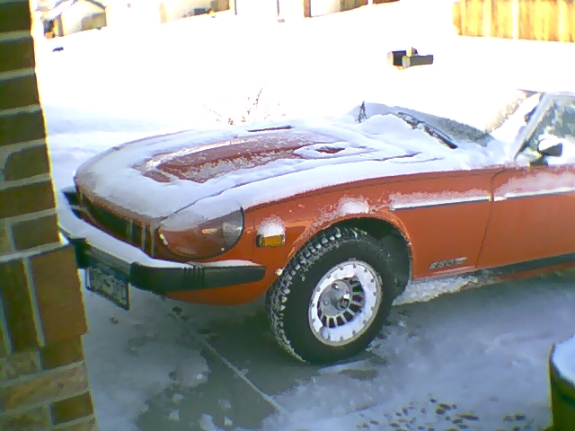

Here is a picture if my car this morning at 10:30AM

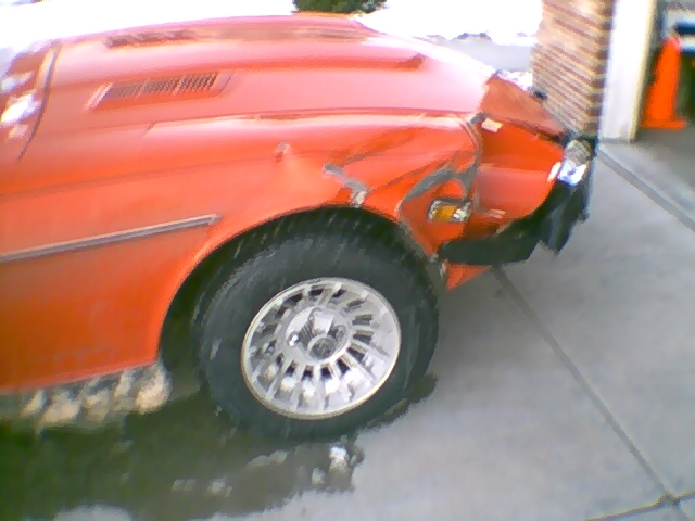

Is this repairable?
How much will this cost me?
I was thinking around $1,500 dollars and alot of work.

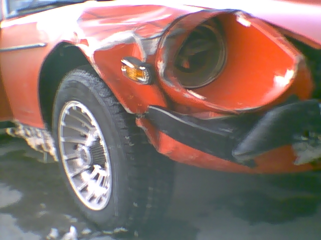

I need a new:
Headlight bucket
Headlight cover (1 side)

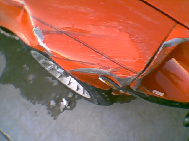

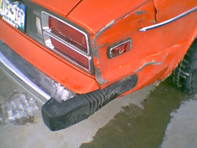

Repair in rear quarter panel
Side Marker Front
Side Marker Rear
New Paint
Bodywork

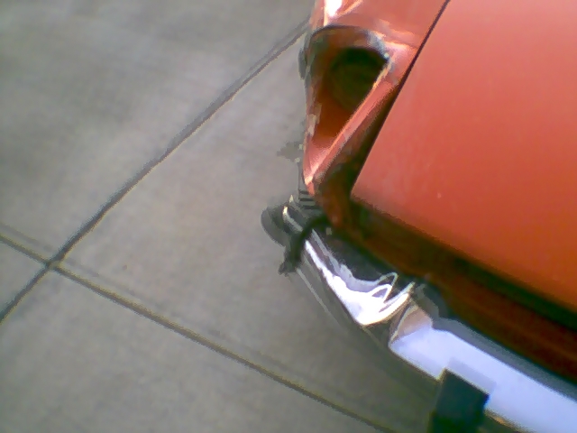

New Front BUmper
New Front headlight
Headlight Bulb
Bumper Shocks
Front Valence
New Hood Hinge
Maybe more.. I dunno, I am in disbelieve...
hours after I took the pictures... I had to take new pictures... just on a different car than I remember now
Not a total loss (except to insurance). The damage is very repairable, especially if you find a parts car with the parts you need. The quarter can be worked back to normal by a "real" body man. Not one of the ones that fixes new cars, but an old guy that knows how to work metal. It is still in good shape. Glad you were not hurt. I am sorry to hear that it happened.
Let this be a lesson to those that want to drive in bad conditions with their Z. Not as easy to fix something that is 30+ years old as it is to fix a 3 year old Civic. Gotta be a little careful with vintage cars.
You've only got one choice truthfully... find a parts car.
The bumpers, and bumper shocks are going to be the hardets thing to find. Everything else is easy. Odd how the bumpers for 280's are harder to find than for the 240's now.....
Rear quarter is gonna take quite a bit of work, unless of course, you choose to replace it with a replacement panel, which might be the cheapest and easiest alternative, considering how much labor might go into straightening it correctly.
Not trying to be smart... but you might want to think about one of those "100 dollar jewels" to drive in the winter, if it gets banged up, throw it away.... ought to be plenty of rusty old Chevy or Ford sedans around you could pick up really cheap.:ermm:
