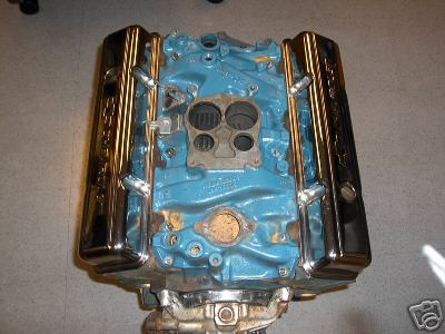

Because in the states, we have a kit designed to swap a smallblock 350 into a 240z. $300 for the kit, $150 for a camaro radiator, $100 for motor mounts, $250 for custom drive shaft, and about $2000 for a carbed sbc 350 w/ a world class t5, throw in another $200 for clutch. Oh, and $100 for an electric fuel pump. What's the RB swap cost? (please include cost of mounts, oilpan with rear pickup instead of front, IC, engine management system, etc)
So, that's 3100 for a complete swap to a 350. Of course, a 350 can be had even cheaper than that, 2k was just a gross estimate with a good carb. I know someone who got a 275hp rated LT1 with a t56 tranny with ecu and harness for 1400 bucks at the wrecker, just had to pull it himself.

The good news is that with the holly carb, installing a plate nitrus system underneith would probably only take a couple of hours....
And while it's not popular on this site, there is nothing wrong with the Chevy V8. Turns dinousaur juice into acceleration as well as anything else.
