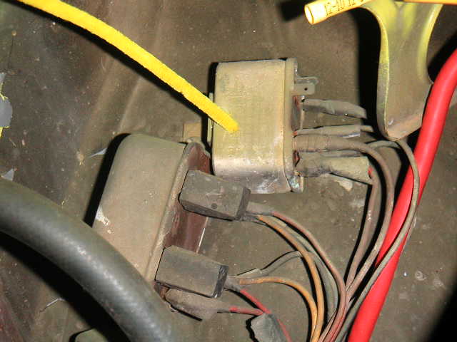

Posted December 7, 200321 yr comment_59760 hey , I have a bunch of loose wires and toggle switches that run from inside the car in the center console area to these relays or what ever they are , never seen them on other peoples z cars are they something the po just did you are they supposed to be there but not the toggle switches, trying to clean out his wonderful way of fixing things , thanks in advance for the help , these are on the fender engine bay passenger side under the batter area and inspection lids Link to comment https://www.classiczcars.com/forums/topic/9209-can-you-id-this-box/ Share on other sites More sharing options...

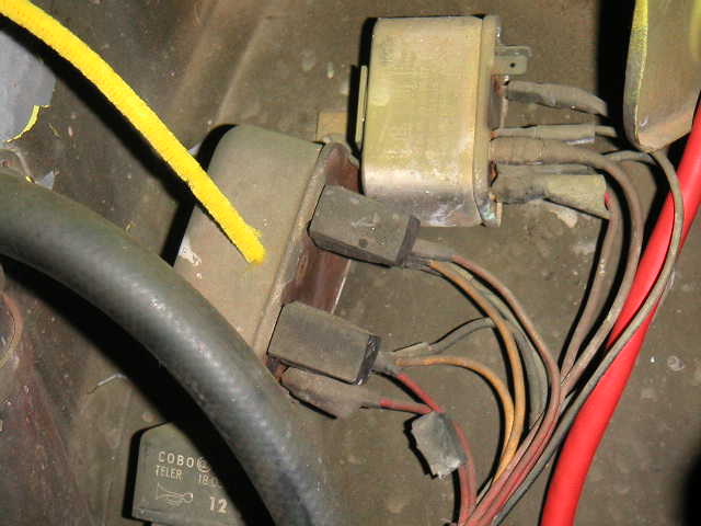

December 7, 200321 yr Author comment_59761 another pic of the 2 mysterious switches Link to comment https://www.classiczcars.com/forums/topic/9209-can-you-id-this-box/#findComment-59761 Share on other sites More sharing options...
December 7, 200321 yr comment_59786 They do look like relays. You're going to have to follow thewires to see where they go. Could be the PO installed them to run high wattage headlights, in which case you'll want to keep them. They could also have been for fog lamps or something else. "Follow the wires, and ye shall be delivered!"Where are the switches that you mentioned? Not shown in either pic unless I missed them. Are they just generic toggle switches? Link to comment https://www.classiczcars.com/forums/topic/9209-can-you-id-this-box/#findComment-59786 Share on other sites More sharing options...
December 7, 200321 yr Author comment_59789 yes there are like 5 regular generic switches that were in the center console where the cig ashtray went Link to comment https://www.classiczcars.com/forums/topic/9209-can-you-id-this-box/#findComment-59789 Share on other sites More sharing options...
December 8, 200321 yr comment_59841 Originally posted by seerex yes there are like 5 regular generic switches that were in the center console where the cig ashtray went OK, some of the wires from the relays should go to a different location. Do you know where they go? Are they just hanging in the air, as if the item being powered by the relays has been removed? if so get rid of all that junk, but be sure to insulate the power wire(s) that energized this add-on wiring, you don't need a short to delvelop. Link to comment https://www.classiczcars.com/forums/topic/9209-can-you-id-this-box/#findComment-59841 Share on other sites More sharing options...
December 8, 200321 yr comment_59847 Do any of these wires go to the canister in your other post, Can I remove this, if so they are horn relays. Only guessing but it makes sense.Alan. Link to comment https://www.classiczcars.com/forums/topic/9209-can-you-id-this-box/#findComment-59847 Share on other sites More sharing options...
