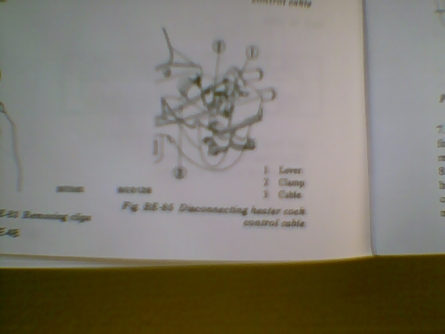

Posted December 7, 200321 yr comment_59769 Well.. as most of you may know of my accident.... I noticed I have anti-freeze leaking all over my passenger floor.. I looked for the source and it is a valve where the Inlet hose for the heater core comes in through the engine bay into a valve and then splits apart to the heater core. Here is a diagram from my book... Link to comment https://www.classiczcars.com/forums/topic/9212-bad-leak-after-accident-can-anyone-recognize-this-piece/ Share on other sites More sharing options...
December 7, 200321 yr Author comment_59770 Can anyone recognize this valve and do they know what the part is? I think I may have to get a new one.. and I don't even know where to start. I spent about an hour reading my Service Manual and I can't find anything about it, other than the picture I posted Link to comment https://www.classiczcars.com/forums/topic/9212-bad-leak-after-accident-can-anyone-recognize-this-piece/#findComment-59770 Share on other sites More sharing options...

December 7, 200321 yr comment_59774 that is the heater unit , it could be either hose the short one is the inlet from the side of the block and the other long one goes the either the waterline spliter if you have water in your manifold or directly to the waterneck above the alternator Link to comment https://www.classiczcars.com/forums/topic/9212-bad-leak-after-accident-can-anyone-recognize-this-piece/#findComment-59774 Share on other sites More sharing options...
December 7, 200321 yr comment_59775 i think I found it in the motorsport catalog page 97 also there is a great blow up on bv on page 69 , what year is the car ? Link to comment https://www.classiczcars.com/forums/topic/9212-bad-leak-after-accident-can-anyone-recognize-this-piece/#findComment-59775 Share on other sites More sharing options...
December 7, 200321 yr comment_59777 ok I need to lay off the painkillers or start reading better , if your is a 78 280 the part number for bv is 54-234and from msa is 16-7646, it calls it a thermo-control units119 through bv and 72 through msa Link to comment https://www.classiczcars.com/forums/topic/9212-bad-leak-after-accident-can-anyone-recognize-this-piece/#findComment-59777 Share on other sites More sharing options...
December 7, 200321 yr comment_59779 Quote Originally posted by PrOxLaMuS© Can anyone recognize this valve and do they know what the part is? I think I may have to get a new one.. and I don't even know where to start. ............. Chloe at Midwest Z is where you start. She will get you the best price and the best service. Check carefully where the hoses run through the firewall (from the engine side at first) as it could be a cracked hose and the A/F runs along the hose to the lower points which are inside your car. See if the hoses are wet there in the engine bay near the firewall. If they aren't, I'd get the hoses AND the valve and replace it all at once. This isn't the kind of job that you want to do twice, as you'll spend a lot of time on your back, upside down in the passenger footwell replacing this stuff.PS you'll be more comfortable doing this job if you pull the passenger seat out so you have more room to lay in there.Just my $.02 Link to comment https://www.classiczcars.com/forums/topic/9212-bad-leak-after-accident-can-anyone-recognize-this-piece/#findComment-59779 Share on other sites More sharing options...

December 8, 200321 yr Author comment_59806 Well the hoses under neath are WET.... But I noticed that when I turn on the heater and start the car.. I see antifreeze comming out of the valve (is it a valve?) I see it squirting down to the hoses. So.. hmm Link to comment https://www.classiczcars.com/forums/topic/9212-bad-leak-after-accident-can-anyone-recognize-this-piece/#findComment-59806 Share on other sites More sharing options...
December 8, 200321 yr comment_59825 it is a valve , have you check to see that the heater hoses are just bad and cracked maybe in an are you can't see, if the hose feels hard and lacks the rubbery feels they might just be bad , much cheaper than the valve and if i was under there doing that anyway I would replace the hoses just to make sure I wasn't under there replacing them after the valve as well, good luck Link to comment https://www.classiczcars.com/forums/topic/9212-bad-leak-after-accident-can-anyone-recognize-this-piece/#findComment-59825 Share on other sites More sharing options...
December 8, 200321 yr comment_59839 Quote Originally posted by PrOxLaMuS© Well the hoses under neath are WET.... But I noticed that when I turn on the heater and start the car.. I see antifreeze comming out of the valve (is it a valve?) I see it squirting down to the hoses. So.. hmm Sounds like the valve is bad from your description. Unless the hoses look virtually new and are soft and supple as "Z beautie's butt", I'd replace them at the same time! As stated before, you don't want to have to do this job twice. Link to comment https://www.classiczcars.com/forums/topic/9212-bad-leak-after-accident-can-anyone-recognize-this-piece/#findComment-59839 Share on other sites More sharing options...
December 8, 200321 yr comment_59840 Please, Take Carls word to heart, he got the pleasure of listening to me bitch when I had a bad hose and thought it was the heater core or the valve. And found it was the hose, AFTER!!! I pulled the heater core out of the car.Replace the hoses if you have ANY doubt in your mind.its not worth the pain of lying upside down in your Z, twice. do it right the first time.Dave. Link to comment https://www.classiczcars.com/forums/topic/9212-bad-leak-after-accident-can-anyone-recognize-this-piece/#findComment-59840 Share on other sites More sharing options...
