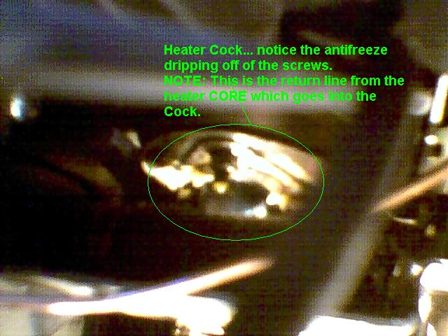

December 8, 200321 yr Author comment_59901 Yeh I will replace everything if I get to it... I have to remove the heater Blower in order to get up there. Really weird place where it is. But I also noticed where there are screws holding that valve up there.. I see antifreeze dripping off of the screws and lots of green antifreeze covering the whole thing. But.. if I get this valve... What is it? Where can I get it? How much is it? .. sorry I am kinda snowed in right now... so i am just wondering so I don't have to go to the Nissan Dealership. Link to comment https://www.classiczcars.com/forums/topic/9212-bad-leak-after-accident-can-anyone-recognize-this-piece/?&page=2#findComment-59901 Share on other sites More sharing options...

December 9, 200321 yr comment_59940 Originally posted by PrOxLaMuS© But.. if I get this valve... What is it? Where can I get it? How much is it? .. I don't think anyone has actually told you that this is a ( Water valve ) It shuts off the coolant from going into the heater core ( during the summer) but the rubber seal on the inside eventually roughts away and the whole valve must be replaced. your best bet for long life on the valve is to keep it open at all times ( heater control on HEAT ) like any thing mechanical, the less you use it the least likely it'll wear out. screw that!!! buy the part and put it in your self, there is no time like the present to learn to work on your Z, every aspect of it. @ clamps and 2 crews, come on once again, good luck. Dave Link to comment https://www.classiczcars.com/forums/topic/9212-bad-leak-after-accident-can-anyone-recognize-this-piece/?&page=2#findComment-59940 Share on other sites More sharing options...

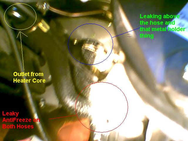

December 14, 200321 yr Author comment_60682 I went into my car today and took some pictures with my crappy camera and a flashlight. I went through and circled and labeled different components. Now this is the view from underneath the passenger dash, under the blower motor and looking at the inlet and outlet of the antifreeze hoses. Link to comment https://www.classiczcars.com/forums/topic/9212-bad-leak-after-accident-can-anyone-recognize-this-piece/?&page=2#findComment-60682 Share on other sites More sharing options...
December 14, 200321 yr Author comment_60683 CLose up of the Heater ****.. notice the antifreeze dripping off the screws.. :disappoin Link to comment https://www.classiczcars.com/forums/topic/9212-bad-leak-after-accident-can-anyone-recognize-this-piece/?&page=2#findComment-60683 Share on other sites More sharing options...
