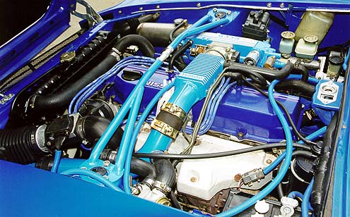

I was thinking bout maybe putting a RB30 (turbo) from the Holden VL Commedore in it. I've seen it done in a 240z (picture). Just wondering how hard it's gonna be? Would it bolt right in? I'll probly get a front-cut or a whole car, so i'll have all the computers and stuff...

I have just bought a RB25DET + gearbox for my 240Z, should be similar to an RB30ET / 260Z, the oil sump needs to be modified and the Z engine mounts line up but the hole distances are different.
The RB30's gearbox will be on an angle towards the passenger side, but that shouldn't be hard to modify.
The guy on this site has put an RB20DET in his 240Z, it should be similar.
