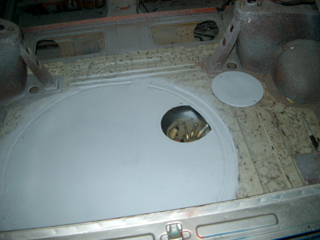

Posted December 12, 200321 yr comment_60383 I know no one asked to see, but JUST IN CASE you ever wondered what a ZX tank would look like in a 1st gen., here are a couple shots of mine. steve77 Link to comment https://www.classiczcars.com/forums/topic/9279-zx-tank-in-a-240/ Share on other sites More sharing options...
December 12, 200321 yr Author comment_60384 And the top, with that incredible, removable sending unit accessible. steve77 Link to comment https://www.classiczcars.com/forums/topic/9279-zx-tank-in-a-240/#findComment-60384 Share on other sites More sharing options...

December 12, 200321 yr Author comment_60391 The advantages are somewhat subjective. It is larger, yet 'smaller'. Yes, it holds 17 gallons. That's kinda a bummer, but who says you have to fill it? the great thing is, it is 'square'. It extends 'left' barely past the diffy. More exhaust and ground clearance. Also, I am putting a ZX harness in this car temporarily and the tank is plug-n-play with the ZX gauges and all. not to mention rust-free.steve77 Link to comment https://www.classiczcars.com/forums/topic/9279-zx-tank-in-a-240/#findComment-60391 Share on other sites More sharing options...
