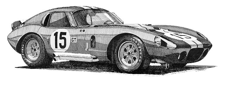

January 18, 200421 yr comment_64775 Typical styling of the period. I thought you guys would enjoy this Cobra Daytona drawing. I'm sure it is copyrighted. Notice the ducting through the hood and the rear duck-tail meant to increase the negative pressure behind the car. Link to comment https://www.classiczcars.com/forums/topic/9373-z-aerodynamics/?&page=2#findComment-64775 Share on other sites More sharing options...

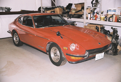

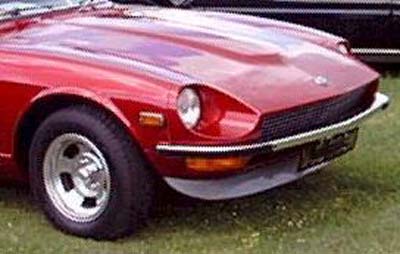

January 19, 200421 yr comment_64874 Guys, Help me out with pictures, please.Chin spoiler Link to comment https://www.classiczcars.com/forums/topic/9373-z-aerodynamics/?&page=2#findComment-64874 Share on other sites More sharing options...
January 19, 200421 yr comment_64875 Oops - try again Chin spoiler Link to comment https://www.classiczcars.com/forums/topic/9373-z-aerodynamics/?&page=2#findComment-64875 Share on other sites More sharing options...
January 19, 200421 yr comment_64876 Chin spoiler on a fairlady Link to comment https://www.classiczcars.com/forums/topic/9373-z-aerodynamics/?&page=2#findComment-64876 Share on other sites More sharing options...
