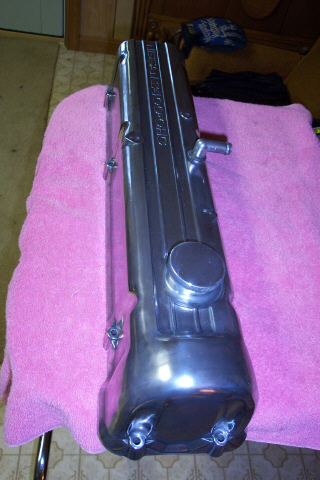

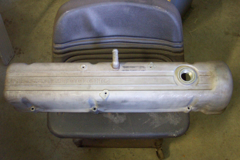

It took me about 10 hours with a buffing stand, 4 different compounds, 4 different wheels, and 4 grades of sandpaper to do mine.... scratches will require sanding.
Before you can get a shine, you have to have a smooth surface. Any small pits or scratches, forget it. Even oxidation will leave just enough small pits to make it nearly impossible to get a good shine.
If you don't have the right tools, it's an even tougher job.....
Mother's and many others you find in an auto parts store will only work to put a shine on something that is already polished, but hasn't been taken care of, from my experience.
Here's a before pic.....
This is after 10 hours of labor... and it's still not as good as I'd like.....:cross-eye
