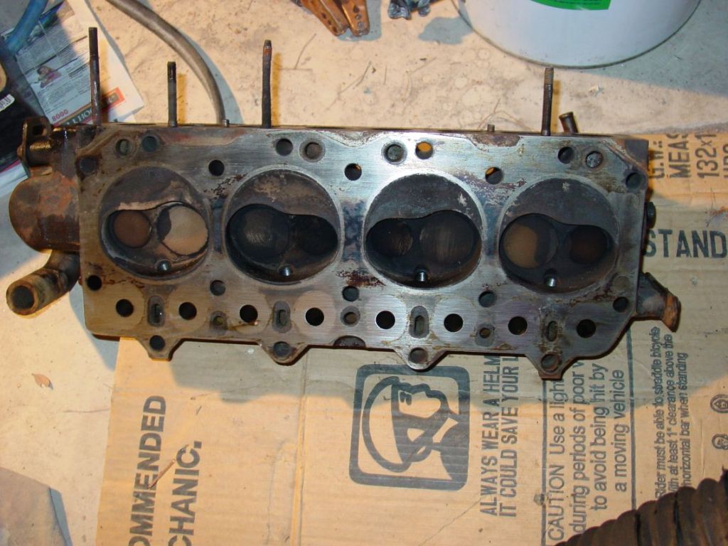

Posted December 28, 200321 yr comment_62068 Well my run of great luck continues . Friday night, my car decides to take a dump, and a big one at that, with no symptoms at all, the cabin fills with oil (lots of holes in the bulkhead). Well it turns out the sumps full of ice coffee and the radiator is sludgy, and there is next to no compression (first time the starter motor has ever turned over the engine convincingly). Now for the good news, the head is straight, and the block is not warped either, bit of leakage around the valvles but not really enough to bother about relapping them in at this stage. So what are your opinions, for a non performance motor, is the Copper head gasket or the fibre gasket better? This stupid car is slowing down the progress on the Z (now its Z related) Link to comment https://www.classiczcars.com/forums/topic/9479-head-gasket-opinion-non-z/ Share on other sites More sharing options...

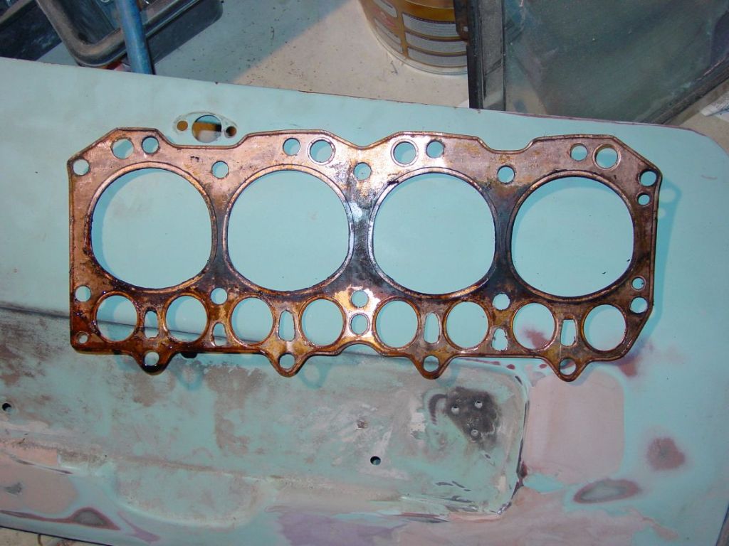

December 28, 200321 yr Author comment_62069 and here is a picture of the head gasket. Doesnt appear to be burning evenly in all four cylinders Link to comment https://www.classiczcars.com/forums/topic/9479-head-gasket-opinion-non-z/#findComment-62069 Share on other sites More sharing options...
December 28, 200321 yr comment_62071 I hate to say this but did you notice the dark spots between the cylinders? This indicates that there was a leak between the cylinders. That head needs to be resurfaced until the entire surface is clean. When it comes to gaskets you will get a bunch of different opinions but I say get one that has the metal rings around the cylinder holes. Felpro makes pretty good gaskets. Link to comment https://www.classiczcars.com/forums/topic/9479-head-gasket-opinion-non-z/#findComment-62071 Share on other sites More sharing options...
December 28, 200321 yr Author comment_62076 There is no doubt that there was leakage between the cylinders, and ultimately the oil and water galleries. The thing is that the head is not warped, not even slightly. I think it comes down to the installation of it. The head gasket was put on with oil, as per instruction manual, and should have probably been done with a sealant as well. Also when i retorqued, I didnt loosen first. All that black build up came off with a piece of sanpaper on glass, and a straightedge confirms the trueness of the block. I guess I need to get it running richer to cool down the head temps and go from there. Link to comment https://www.classiczcars.com/forums/topic/9479-head-gasket-opinion-non-z/#findComment-62076 Share on other sites More sharing options...
