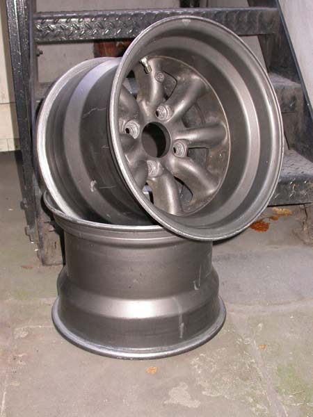

If you can count official Nissan "Sports Option" parts, then there is a little more width available. The Sports Option list for the 432 and 432R offered magnesium 8-spokes ( of the classic Minilite / RS Watanabe shape ) also made by Kobe Seiko, in 8j x 14 from 1970.

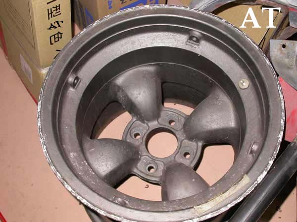

They were never shown in the Sports Option parts lists ( and therefore were not available to the general public ) but Nissan's Works Group 4 & 5 "240ZR" racecars sometimes used the extra rare Kobe Seiko-made 4 spokes. On the Z they used ( I think ) 10j x 15 on the front and 12j x 15 on the rear. You can see these on the 240Z that ran at Le Mans in 1975 & 1976, which was an ex-Japanese Works circuit race car ( not an ex-Works rally car ).
Here's a pic of one of the 12j x 15 4-spokes that belongs to a friend of mine in Japan:

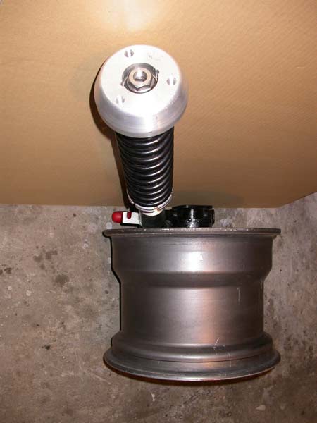

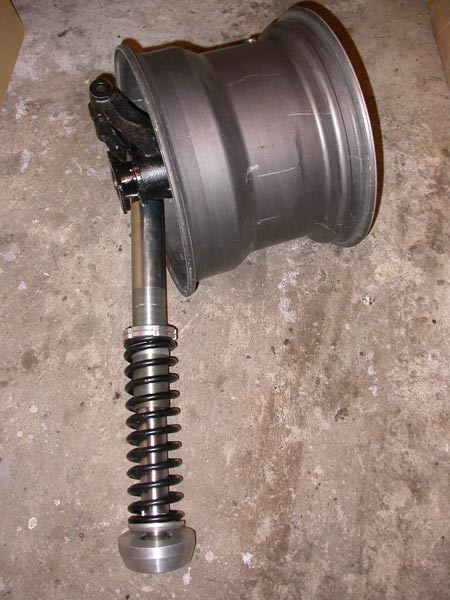

I only bought the 11's in an extended moment of fantasy.They were there, I had the money, and my judgement got the better of me. I haven't put them on the car yet ( they were destined for the ZG ) as the whole front and rear suspension is off at the moment and the car is sitting on jackstands. I've got to pull my finger out and get the Bilstein set-up on it, but the weather has been putting me off.

I have a pair of 8.5j that I will probably put on the rear of the car, and leave the 7.5j on the front. That will make it 'look' about right, but I would still prefer to find some more 'vintage' looking rubber for them - something with a high profile like 70 or 80. I might even investigate bias-belted stuff for the 'right' look. I'd prefer the car to look like time stopped around 1973, if possible.
